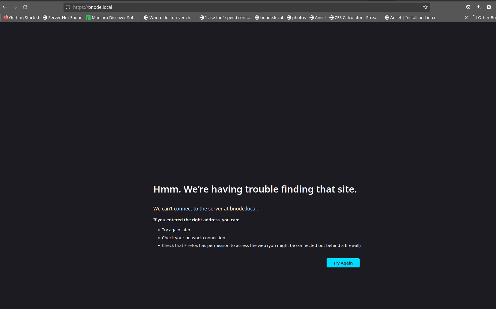

just today I can't seem to access my web dashboard. My server name is bnode. I tried the following in brave, and firefox. On my computer and phone. I can see files on the smb share though.
http://bnode.local
https://bnode.local
http://bnode.local/Dashboard
https://bnode.local/Dashboard
http://tower.local (and variations of)
Tried rebooting the server and that doesn't help.
Running the v7 beta 2.
Any ideas? Thanks

Solved by robbrown99
I went to my router and found the IP address http://192.168.1.109/ ... this worked to allow me in.
However the name of the server as the url still won't work (bnode.local)
Attached.
Interestingly it now works. If it happens again I will post here. Will mark as solved for now.

Look at the information on the     Settings   >>>>   Management Access  tab
There is a table there on what URLs will work.  It change depending the the setting of the of the   Use SSL/TLS:  option.  If you point you cursor at that option and click after the ? icon appears, the help screen explains the three settings for that option.
