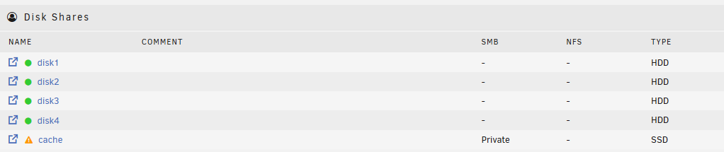

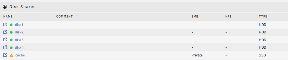

Apparently, @naddel81 has only enabled Disk Shares under   Settings >>>>  Global Share settings.   Unfortunately, the Diagnostic file does not post up information about disk shares-- that I could find.

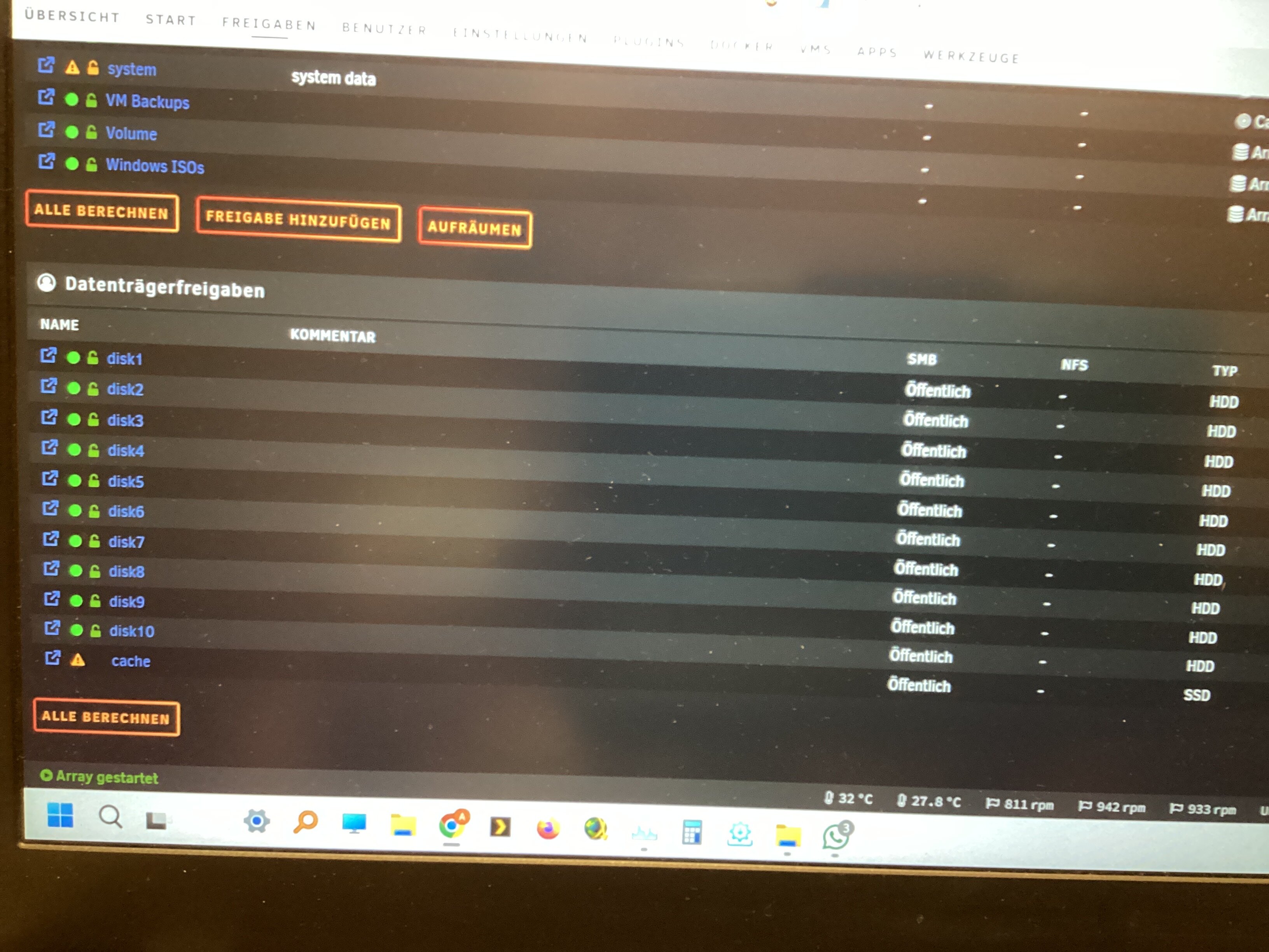

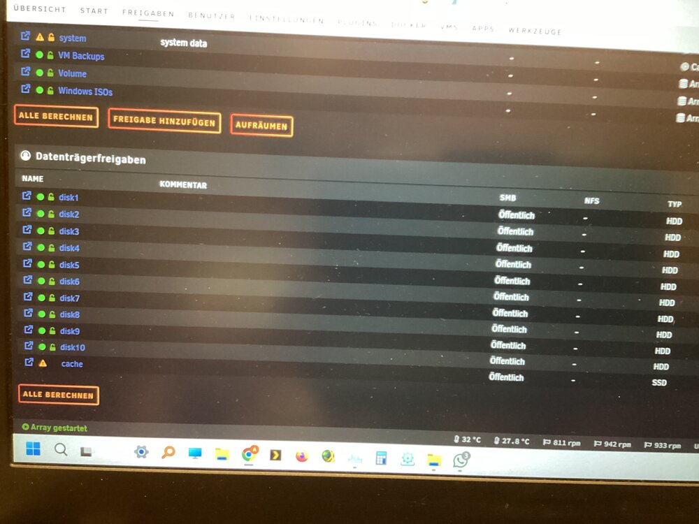

Go to the SHARES Tab and get a screen shot of the portion of that tab:
done
