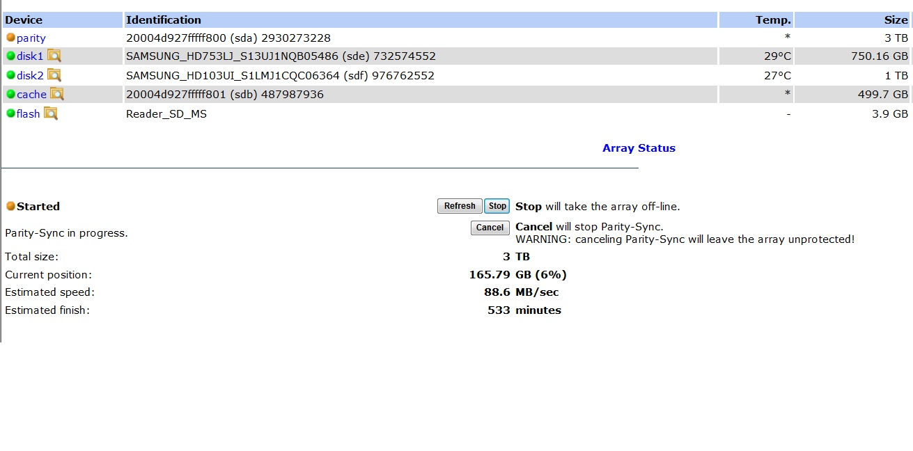

I switched the ARC1200 to the other PCIe x4 port. I now get parity sync speeds of 85-90 MB/s. Can't believe it makes such a difference. Let's see what the Parity check does later on.
When I said do the speed test it was on the ARC1200 array drives (before formatting for unRAID) In any case movement of the controller improved your speed. Your speeds are what I would expect. I would however suggest you purchase two 7200RPM drives for the SAFE33 volume.  Although members will say you are limited to to your slowest drive, if you use more then one drive or do allot of random I/O as with bittorrent, the extra speed helps. I know it's a cost thing, but that's my experience.
Parity check vs parity sync will be slightly different, but close to one another. With sync, you are writing and the wb cache is helping.
With sync, you are reading and the cache does not help as much.

Parity sync speed started a 95 MBs then gradually dropped to 55-60 at 1 TB (size of the largest array-disk). At the 1 TB point speed went up to 90-95 MBs and now at 70% (2.1 TB) is at 88 MBs. Only the 3 TB RAID0 volume (parity) is now written to.
This is normal.

42MB/s is not what I would expect from RAID0 even on x1 lane.
You could try moving it to other slots to see what the deal is.
On my card, I enabled write back cache.
The best test is to use the writeread10gb script on these raw drives to determine maximum speed before you build the array.
I.e. with the 3 drives and emhttp down, format each drive with reiserfs manually.
After that  use the writeread10gb script on each drive.
That will be the maximum you could possibly achieve on each drive. From there you can factor in all the other issues.
I can say that if you are doing a parity operation (read/write/sync, etc, etc) and write data to the cache drive, there will be a performance penalty and it could be significant. So I do those two operations separately.
If you have a UPS you can enable the write back cache on the controller in the firmware before doing anything else to see if it helps.
I have 15 data drives to 1 ARC1200 on a x1 slot, I get from 75-80 at the start dropping to 55k near the end.
Jul 14 21:22:10 atlas kernel: md: sync done. time=18244sec rate=53538K/sec
I have 2 seagate 1.5tb 7200RPM 32MB cache drives as my raid0/raid1 hybrid.
If you are using 5400rpm drives for yours, that could be an issue.
I did the writeread10gb test.
Both disks showed write speeds averages of 36-40 MBs
The RAID1 cache volume on the ARC1200 showed an average of 55-60 MBs
Reading test gives an erroneous value of 1.4 GBs
Those speeds are good.
With some tunings they might get better depending on how much memory you have.
I set my tunables to these values (2x previous values)
Tunable (md_num_stripes): user-set
Tunable (md_write_limit): user-set
Tunable (md_sync_window): user-set
I also set my kernel tunables to
sysctl vm.vfs_cache_pressure=10
sysctl vm.swappiness=100
sysctl vm.dirty_ratio=20 (you can set it higher as an experiment).
sysctl -w vm.min_free_kbytes=8192
This helps by caching more in ram (at the potential risk of loss due to sudden loss of power).
If you are using a UPS, then this is not that much of a risk.
What this lets me do is burst at up to 60MB/s to the array.
Which is good for small files. I get it onto the server faster and let the unix cache flush it out to disk.
