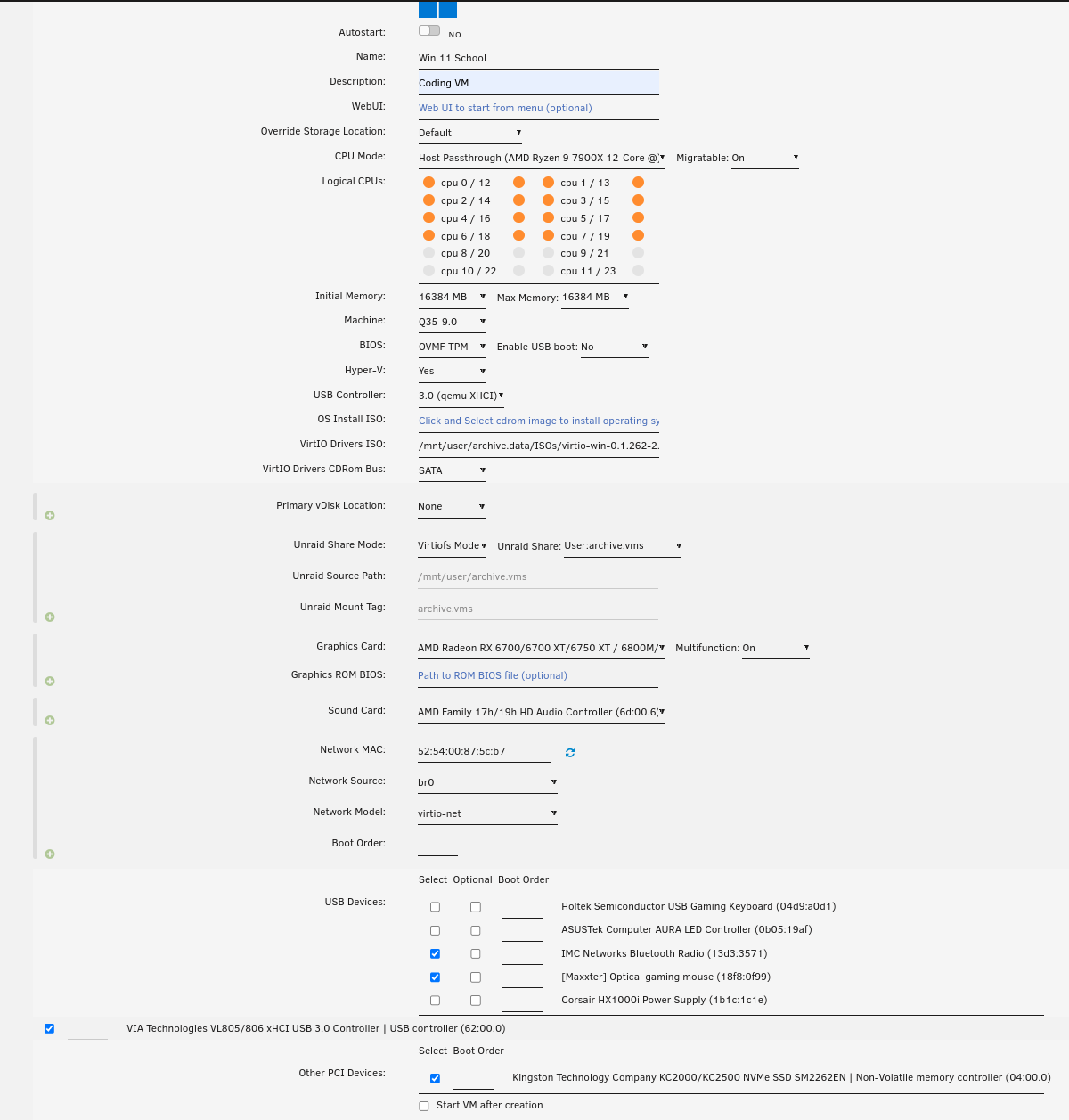

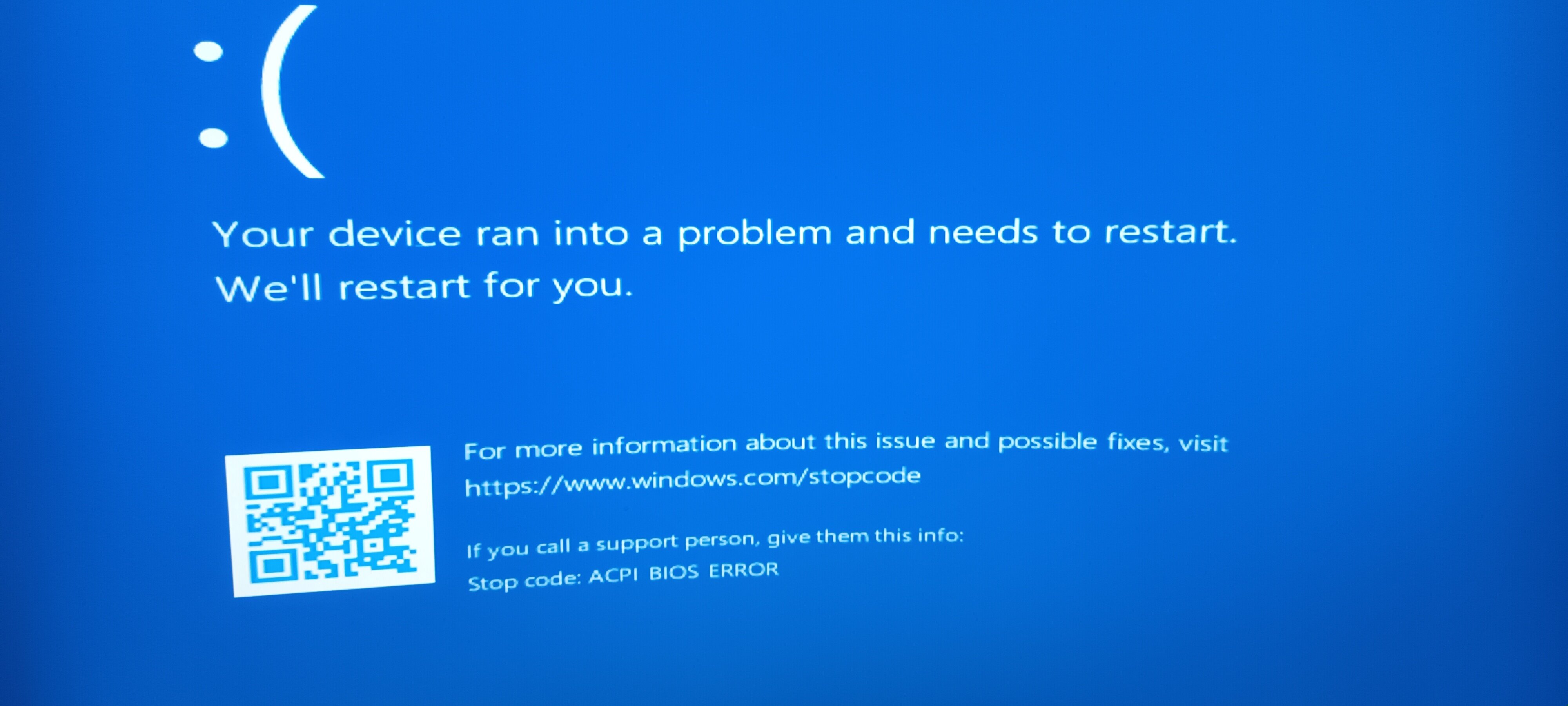

I created a VM, it worked fine, I added the GPU, and USB card, shut down the Linux VM that was using the GPU, and this is what happens.
It's been doing this with my old Win 10 and 11 VM's, so I have been a bit distraught. I need windows to work for school work, since Visual Studio doesn't work in Linux. "/
I have tried to enable and disable "Global C-states" in the bios and that had no impact on the problem, I'm starting to be stressed now because my VM that worked stopped working after I passed through the GPU, and even if I take it away it won't start. It only gives the same error that the other two. Is this i a BIOS problem, unRAID problem or QEMU problem?

I should perhaps have added, that I had to go through a lot of hoops to get Windows working to begin with on my old unRAID server, I recently bought a new stick, created a whole new, and set it up, and the only things that doesn't work now is Windows, I can make 4000 different Win10/11 VM's and they will not start, it's the same error. I use these settings for Linux, and ALL Linux VM's just work. It's the same computer and hardware, the only things going on now, is that I have not made the xml changes that I can't remember what I did on the old unRAID server.
The people that helped me last time was on the unRAID community discord server, but they kicked and banned me because I asked a thing 4 times and it took 8 hours to get an answer and they kicked me because I didn't have the patience, and it's a community server not support server, but it was the darn SUPPORT channel I asked in, this was a couple months ago, and I always have a tendency to get on people's nerves just by existing. "/ The help I got from there, was over 1½ years ago, I should have written down the stuff, but I didn't. "/ I think I have a pastebin with the settings I used on the Win11 VM, but I only had two and I kept using the same two VM's, but when I installed a new server, they just started giving these problems, I don't know if I missed to make a change in the bios on the last update or if it's something that I needed to add to the XML in order to get them running.
This VM worked before I chose to change it to use the GPU.
Now it gives the same 'bios error'.
Edited by Querzion
2 minutes ago, Querzion said:
Review the whole post for similar edits and fixes you may need:
I will look it over, but I don't very much comprehend where some text is supposed to be added.
I am currently in Bazzite, using my GPU, with the same settings I have been using for earlier Win VM's, and it's working without a hitch. At the moment my Win11 VM that was working is no longer working, so I'm a bit stressed about that, since I have school work to fix with and it took the better of 8 hours to set it up, it's almost 2am here.
I really appreciate the help I get, but I don't even comprehend why these problems exist in the first place, when they are nowhere to be seen in a normal linux using QEMU, and gpu passthrough.

      <model name='pcie-root-port'/>
      <target chassis='35' port='0x2a'/>
      <address type='pci' domain='0x0000' bus='0x00' slot='0x05' function='0x2'/>
    </controller>
      <address type='pci' domain='0x0000' bus='0x03' slot='0x00' function='0x0'/>
    </controller>
      <address type='pci' domain='0x0000' bus='0x00' slot='0x1f' function='0x2'/>
    </controller>
    <filesystem type='mount' accessmode='passthrough'>
      <driver type='virtiofs' queue='1024'/>
      <binary path='/usr/libexec/virtiofsd' xattr='on'>
        <cache mode='always'/>
        <sandbox mode='chroot'/>
      </binary>
      <source dir='/mnt/user/archive.vms'/>
      <target dir='archive.vms'/>
      <address type='pci' domain='0x0000' bus='0x01' slot='0x00' function='0x0'/>
    </filesystem>
    <interface type='bridge'>
      <mac address='52:54:00:87:5c:b7'/>
      <source bridge='br0'/>
      <model type='virtio-net'/>
      <address type='pci' domain='0x0000' bus='0x02' slot='0x00' function='0x0'/>
    </interface>
    <serial type='pty'>
        <model name='isa-serial'/>
      </target>
    </serial>
    <console type='pty'>
    </console>
    <channel type='unix'>
    </channel>
    <tpm model='tpm-tis'>
      <backend type='emulator' version='2.0' persistent_state='yes'/>
    </tpm>
    <audio id='1' type='none'/>
      <driver name='vfio'/>
      <source>
        <address domain='0x0000' bus='0x03' slot='0x00' function='0x0'/>
      </source>
      <address type='pci' domain='0x0000' bus='0x23' slot='0x00' function='0x0' multifunction='on'/>
    </hostdev>
      <source>
        <address domain='0x0000' bus='0x6d' slot='0x00' function='0x6'/>
      </source>
      <address type='pci' domain='0x0000' bus='0x04' slot='0x00' function='0x0'/>
    </hostdev>
      <source>
        <address domain='0x0000' bus='0x62' slot='0x00' function='0x0'/>
      </source>
      <address type='pci' domain='0x0000' bus='0x05' slot='0x00' function='0x0'/>
    </hostdev>
      <source>
        <address domain='0x0000' bus='0x04' slot='0x00' function='0x0'/>
      </source>
      <address type='pci' domain='0x0000' bus='0x06' slot='0x00' function='0x0'/>
    </hostdev>
    <hostdev mode='subsystem' type='usb' managed='no'>
      <source>
        <vendor id='0x13d3'/>
        <product id='0x3571'/>
      </source>
    </hostdev>
      <source>
        <vendor id='0x18f8'/>
        <product id='0x0f99'/>
      </source>
      <address type='usb' bus='0' port='2'/>
    </hostdev>
    <watchdog model='itco' action='reset'/>
    <memballoon model='none'/>
  </devices>
</domain>

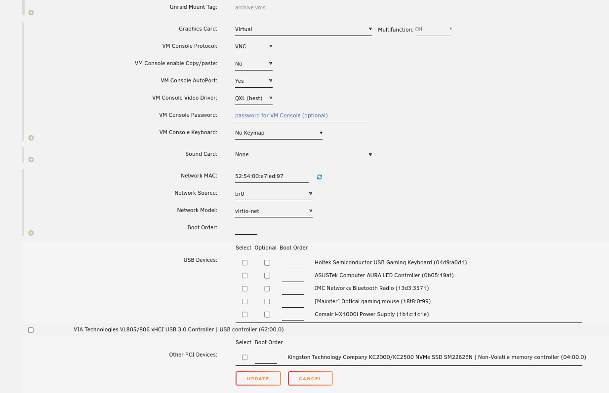

Win 11 NEW (Worked with virtual, doesn't work anymore.)
<domain type='kvm'>
  <name>Win 11 New</name>
  <uuid>ed274ac4-8793-2065-530b-d0ac1e95a47c</uuid>
  <description>Coding VM (vDisk1)</description>
  <metadata>
    <vmtemplate xmlns="unraid" name="Windows 11" icon="windows11.png" os="windowstpm" webui="" storage="default"/>
  </metadata>
  <memory unit='KiB'>16777216</memory>
  <currentMemory unit='KiB'>16777216</currentMemory>
  <memoryBacking>
    <nosharepages/>
    <source type='memfd'/>
    <access mode='shared'/>
  </memoryBacking>
  <vcpu placement='static'>16</vcpu>
  <cputune>
    <vcpupin vcpu='0' cpuset='0'/>
    <vcpupin vcpu='1' cpuset='12'/>
    <vcpupin vcpu='2' cpuset='1'/>
    <vcpupin vcpu='3' cpuset='13'/>
    <vcpupin vcpu='4' cpuset='2'/>
    <vcpupin vcpu='5' cpuset='14'/>
    <vcpupin vcpu='6' cpuset='3'/>
    <vcpupin vcpu='7' cpuset='15'/>
    <vcpupin vcpu='8' cpuset='4'/>
    <vcpupin vcpu='9' cpuset='16'/>
    <vcpupin vcpu='10' cpuset='5'/>
    <vcpupin vcpu='11' cpuset='17'/>
    <vcpupin vcpu='12' cpuset='6'/>
    <vcpupin vcpu='13' cpuset='18'/>
    <vcpupin vcpu='14' cpuset='7'/>
    <vcpupin vcpu='15' cpuset='19'/>
  </cputune>
  <os>
    <type arch='x86_64' machine='pc-q35-9.0'>hvm</type>
    <loader readonly='yes' type='pflash'>/usr/share/qemu/ovmf-x64/OVMF_CODE-pure-efi-tpm.fd</loader>
    <nvram>/etc/libvirt/qemu/nvram/ed274ac4-8793-2065-530b-d0ac1e95a47c_VARS-pure-efi-tpm.fd</nvram>
  </os>
  <features>
    <acpi/>
    <apic/>
    <hyperv mode='custom'>
      <relaxed state='on'/>
      <vapic state='on'/>
      <vpindex state='on'/>
      <synic state='on'/>
      <stimer state='on'/>
    </hyperv>
  </features>
  <cpu mode='host-passthrough' check='none' migratable='off'>
    <topology sockets='1' dies='1' clusters='1' cores='8' threads='2'/>
    <cache mode='passthrough'/>
    <feature policy='require' name='topoext'/>
  </cpu>
  <clock offset='localtime'>
  </clock>
  <on_crash>restart</on_crash>
  <devices>
      <source file='/mnt/disk1/archive.data/VMs/Win 11 New/vdisk1.img'/>
      <serial>vdisk1</serial>
      <boot order='1'/>
    </disk>
      <source file='/mnt/disk1/archive.data/ISOs/virtio-win-0.1.262-2.iso'/>
      <target dev='hda' bus='sata'/>
      <readonly/>
      <boot order='2'/>
    </disk>
    <controller type='usb' index='0' model='qemu-xhci' ports='15'>
      <address type='pci' domain='0x0000' bus='0x00' slot='0x07' function='0x0'/>
    </controller>
    <controller type='pci' index='0' model='pcie-root'/>
    <controller type='pci' index='1' model='pcie-root-port'>
      <target chassis='1' port='0x8'/>
      <address type='pci' domain='0x0000' bus='0x00' slot='0x01' function='0x0' multifunction='on'/>
    </controller>
    <controller type='pci' index='2' model='pcie-root-port'>
      <target chassis='2' port='0x9'/>
    </controller>
    <controller type='pci' index='3' model='pcie-root-port'>
      <target chassis='3' port='0xa'/>
      <address type='pci' domain='0x0000' bus='0x00' slot='0x01' function='0x2'/>
    </controller>
    <controller type='pci' index='4' model='pcie-root-port'>
      <target chassis='4' port='0xb'/>
      <address type='pci' domain='0x0000' bus='0x00' slot='0x01' function='0x3'/>
    </controller>
    <controller type='pci' index='5' model='pcie-root-port'>
      <target chassis='5' port='0xc'/>
      <address type='pci' domain='0x0000' bus='0x00' slot='0x01' function='0x4'/>
    </controller>
    <controller type='pci' index='6' model='pcie-root-port'>
      <target chassis='6' port='0xd'/>
      <address type='pci' domain='0x0000' bus='0x00' slot='0x01' function='0x5'/>
    </controller>
    <controller type='pci' index='7' model='pcie-root-port'>
      <target chassis='7' port='0xe'/>
      <address type='pci' domain='0x0000' bus='0x00' slot='0x01' function='0x6'/>
    </controller>
    <controller type='pci' index='8' model='pcie-root-port'>
      <target chassis='8' port='0xf'/>
      <address type='pci' domain='0x0000' bus='0x00' slot='0x01' function='0x7'/>
    </controller>
    <controller type='pci' index='9' model='pcie-root-port'>
      <target chassis='9' port='0x10'/>
      <address type='pci' domain='0x0000' bus='0x00' slot='0x02' function='0x0' multifunction='on'/>
    </controller>
    <controller type='pci' index='10' model='pcie-root-port'>
      <target chassis='10' port='0x11'/>
      <address type='pci' domain='0x0000' bus='0x00' slot='0x02' function='0x1'/>
    </controller>
    <controller type='pci' index='11' model='pcie-root-port'>
      <target chassis='11' port='0x12'/>
      <address type='pci' domain='0x0000' bus='0x00' slot='0x02' function='0x2'/>
    </controller>
    <controller type='pci' index='12' model='pcie-root-port'>
      <target chassis='12' port='0x13'/>
      <address type='pci' domain='0x0000' bus='0x00' slot='0x02' function='0x3'/>
    </controller>
    <controller type='pci' index='13' model='pcie-root-port'>
      <target chassis='13' port='0x14'/>
      <address type='pci' domain='0x0000' bus='0x00' slot='0x02' function='0x4'/>
    </controller>
    <controller type='pci' index='14' model='pcie-root-port'>
      <target chassis='14' port='0x15'/>
      <address type='pci' domain='0x0000' bus='0x00' slot='0x02' function='0x5'/>
    </controller>
    <controller type='pci' index='15' model='pcie-root-port'>
      <target chassis='15' port='0x16'/>
      <address type='pci' domain='0x0000' bus='0x00' slot='0x02' function='0x6'/>
    </controller>
    <controller type='pci' index='16' model='pcie-root-port'>
      <target chassis='16' port='0x17'/>
      <address type='pci' domain='0x0000' bus='0x00' slot='0x02' function='0x7'/>
    </controller>
    <controller type='pci' index='17' model='pcie-root-port'>
      <target chassis='17' port='0x18'/>
      <address type='pci' domain='0x0000' bus='0x00' slot='0x03' function='0x0' multifunction='on'/>
    </controller>
    <controller type='pci' index='18' model='pcie-root-port'>
      <target chassis='18' port='0x19'/>
      <address type='pci' domain='0x0000' bus='0x00' slot='0x03' function='0x1'/>
    </controller>
    <controller type='pci' index='19' model='pcie-root-port'>
      <target chassis='19' port='0x1a'/>
      <address type='pci' domain='0x0000' bus='0x00' slot='0x03' function='0x2'/>
    </controller>
    <controller type='pci' index='20' model='pcie-root-port'>
      <target chassis='20' port='0x1b'/>
      <address type='pci' domain='0x0000' bus='0x00' slot='0x03' function='0x3'/>
    </controller>
    <controller type='pci' index='21' model='pcie-root-port'>
      <target chassis='21' port='0x1c'/>
      <address type='pci' domain='0x0000' bus='0x00' slot='0x03' function='0x4'/>
    </controller>
    <controller type='pci' index='22' model='pcie-root-port'>
      <target chassis='22' port='0x1d'/>
      <address type='pci' domain='0x0000' bus='0x00' slot='0x03' function='0x5'/>
    </controller>
    <controller type='pci' index='23' model='pcie-root-port'>
      <target chassis='23' port='0x1e'/>
      <address type='pci' domain='0x0000' bus='0x00' slot='0x03' function='0x6'/>
    </controller>
    <controller type='pci' index='24' model='pcie-root-port'>
      <target chassis='24' port='0x1f'/>
      <address type='pci' domain='0x0000' bus='0x00' slot='0x03' function='0x7'/>
    </controller>
    <controller type='pci' index='25' model='pcie-root-port'>
      <target chassis='25' port='0x20'/>
      <address type='pci' domain='0x0000' bus='0x00' slot='0x04' function='0x0' multifunction='on'/>
    </controller>
    <controller type='pci' index='26' model='pcie-root-port'>
      <target chassis='26' port='0x21'/>
      <address type='pci' domain='0x0000' bus='0x00' slot='0x04' function='0x1'/>
    </controller>
    <controller type='pci' index='27' model='pcie-root-port'>
      <target chassis='27' port='0x22'/>
      <address type='pci' domain='0x0000' bus='0x00' slot='0x04' function='0x2'/>
    </controller>
    <controller type='pci' index='28' model='pcie-root-port'>
      <target chassis='28' port='0x23'/>
      <address type='pci' domain='0x0000' bus='0x00' slot='0x04' function='0x3'/>
    </controller>
    <controller type='pci' index='29' model='pcie-root-port'>
      <target chassis='29' port='0x24'/>
      <address type='pci' domain='0x0000' bus='0x00' slot='0x04' function='0x4'/>
    </controller>
    <controller type='pci' index='30' model='pcie-root-port'>
      <target chassis='30' port='0x25'/>
      <address type='pci' domain='0x0000' bus='0x00' slot='0x04' function='0x5'/>
    </controller>
    <controller type='pci' index='31' model='pcie-root-port'>
      <target chassis='31' port='0x26'/>
      <address type='pci' domain='0x0000' bus='0x00' slot='0x04' function='0x6'/>
    </controller>
    <controller type='pci' index='32' model='pcie-root-port'>
      <target chassis='32' port='0x27'/>
      <address type='pci' domain='0x0000' bus='0x00' slot='0x04' function='0x7'/>
    </controller>
    <controller type='pci' index='33' model='pcie-root-port'>
      <target chassis='33' port='0x28'/>
      <address type='pci' domain='0x0000' bus='0x00' slot='0x05' function='0x0' multifunction='on'/>
    </controller>
    <controller type='pci' index='34' model='pcie-root-port'>
      <target chassis='34' port='0x29'/>
      <address type='pci' domain='0x0000' bus='0x00' slot='0x05' function='0x1'/>
    </controller>
    <controller type='pci' index='35' model='pcie-root-port'>
    </controller>
    </controller>
    </controller>
      </binary>
    </filesystem>
      <mac address='52:54:00:e7:ed:97'/>
