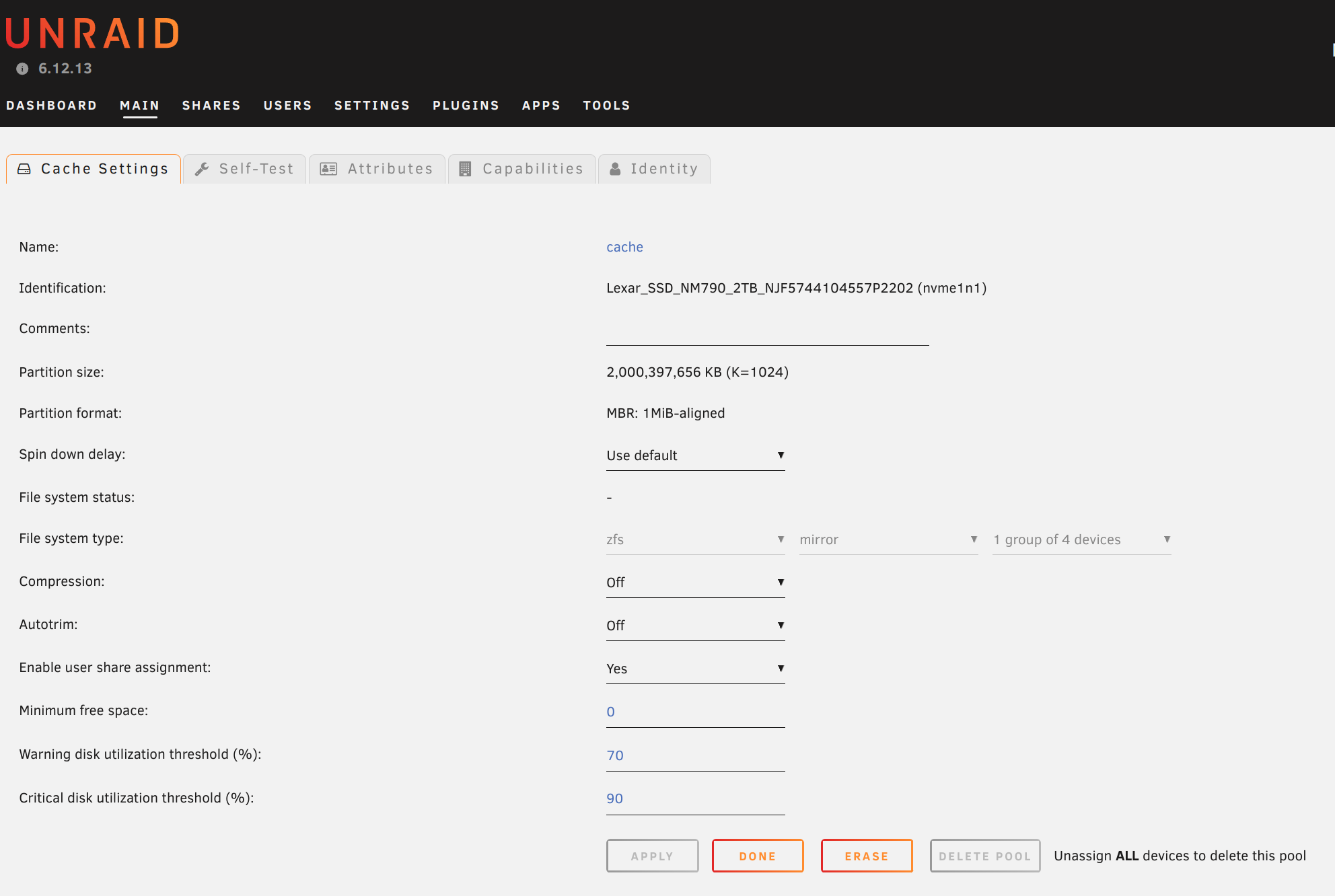

I see something strange in cache settings- it says "File system type: zfs mirror 1 group of 3 devices" but there should be 2 devices.
I see also in cache.cfg
diskFsWidth="3"
the only 3 i found there but don't really know what it means for sure.
do anyone knows how to fix the issue? Can I just edit the diskFsWidth (probably it's not that easy)?

I did nothing new, just stopped the array and now it wont start again with or without docker or VM on ;( now it says 1 group of 4 devices, previously it was 3, should be 2

I edited the pool config file (diskFsWidth="2" from 4), rebooted and it started up. But something is not right.

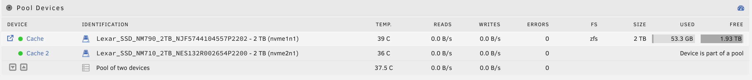

Didn't you say the pool was 2 devices? There's only one currently.
it should be 2 as in attached image. cache.cfg states:
It's not, zpool status always show the correct pool status, you can re-import the single device pool and then add the other one to create a mirror.
