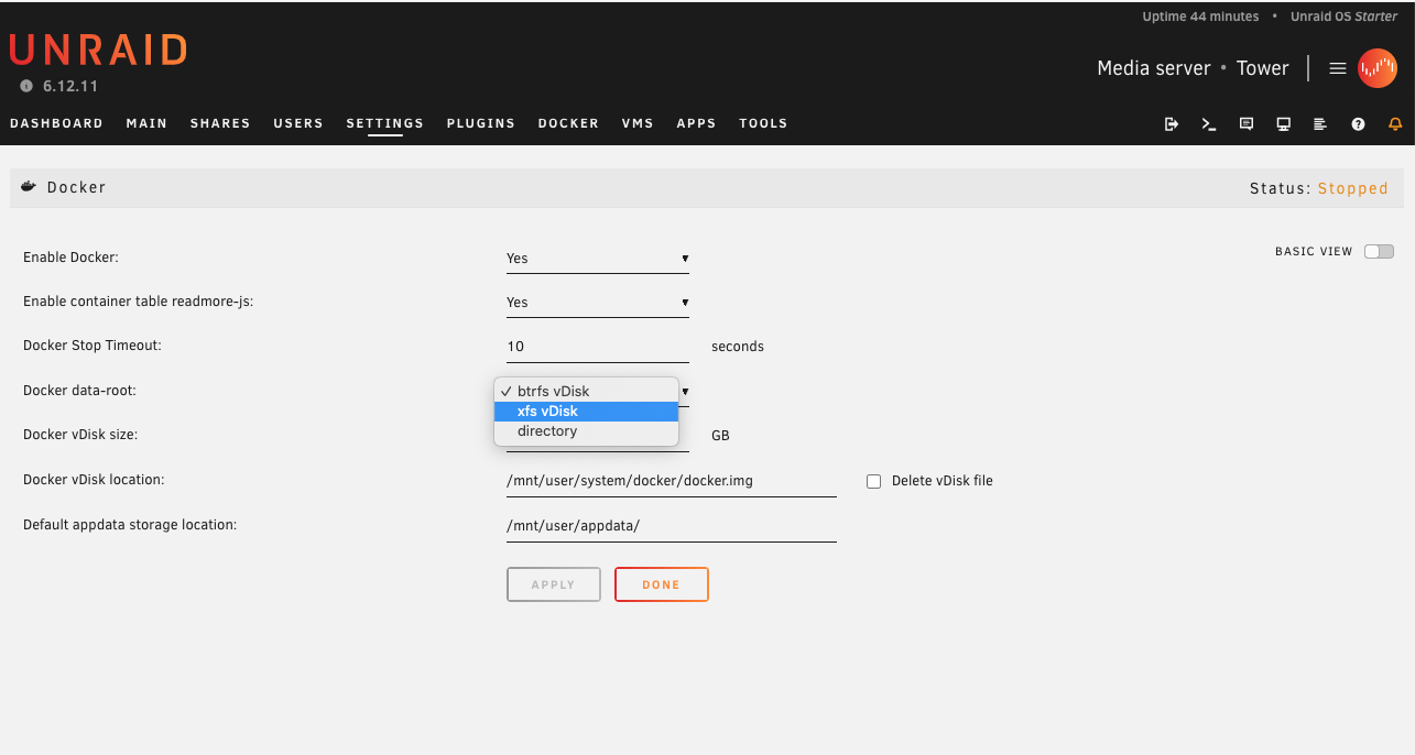

I think / hope I solved my own issue:
While I was examining Docker related settings (I know little or nothing about them..) I noticed that > Settings > Docker showed the Docker data-root as btrfs vDisk.
Since all my drives are xfs, I changed the setting of data-root accordingly from btrfs to xfs and Tada!! Docker started to work!
Image 12 - Docker data-root - changed from btrfs to xfs vDisk - that did it!!.png
That wouldn't have been your problem.  Glad it's working, but as a vdisk (btrfs or xfs) sitting on an xfs drive it doesn't matter.  Diagnostics from when it wasn't working would have said why, but its irrelevant now
Thanks for replying, will read up and see if I can trace something to learn what was wrong.
