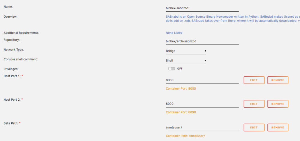

2 shares for nzb handling by SABnzbd, "incomplete" and "complete", under "included drives" I selected only the SSD (disk4). SABnzbd correctly downloads to and unpacks only on the SSD (disk speeds no longer throttling performance as they were when it split these operations across the SSD and one of the HDDs)

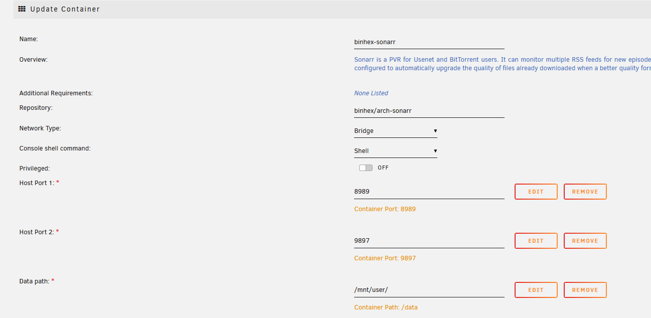

SABnzbd correctly receives instructions to download, downloads and unpacks all on disk4 as it should. Sonarr then sees the completed episode pop up in the complete folder, and proceeds to move the whole thing onto disk4. With krusader I can see that sonarr creates a data -> tv path on disk4 despite this path/directory not existing at the start of the process.

You will probably have to specify a disk path in the docker to get what you want. Linux "move" just "repaths" files in /mnt/user.
See the CAUTION section here:
https://docs.unraid.net/unraid-os/manual/shares/user-shares/

By specifying a disk path, do you mean a different parameter than the default host path field provided by unraid on the install page? Would this involve creating a disk share? (I don't know disk shares work but I've seen the section on the shares screen)
Just read the doc on disk shares. It sounds like I can just set up a disk share on the SSD, then moves from the disk share to the user share when sonarr performs mv would actually copy and delete instead of rename. A problem I can foresee is that sonarr requires read/write access to both of these locations and I'm not sure how to get around such a directory structure. SABnzbd could be installed on the SSD as that's the only disk it needs to access, but I have to pick somewhere to install sonarr.
