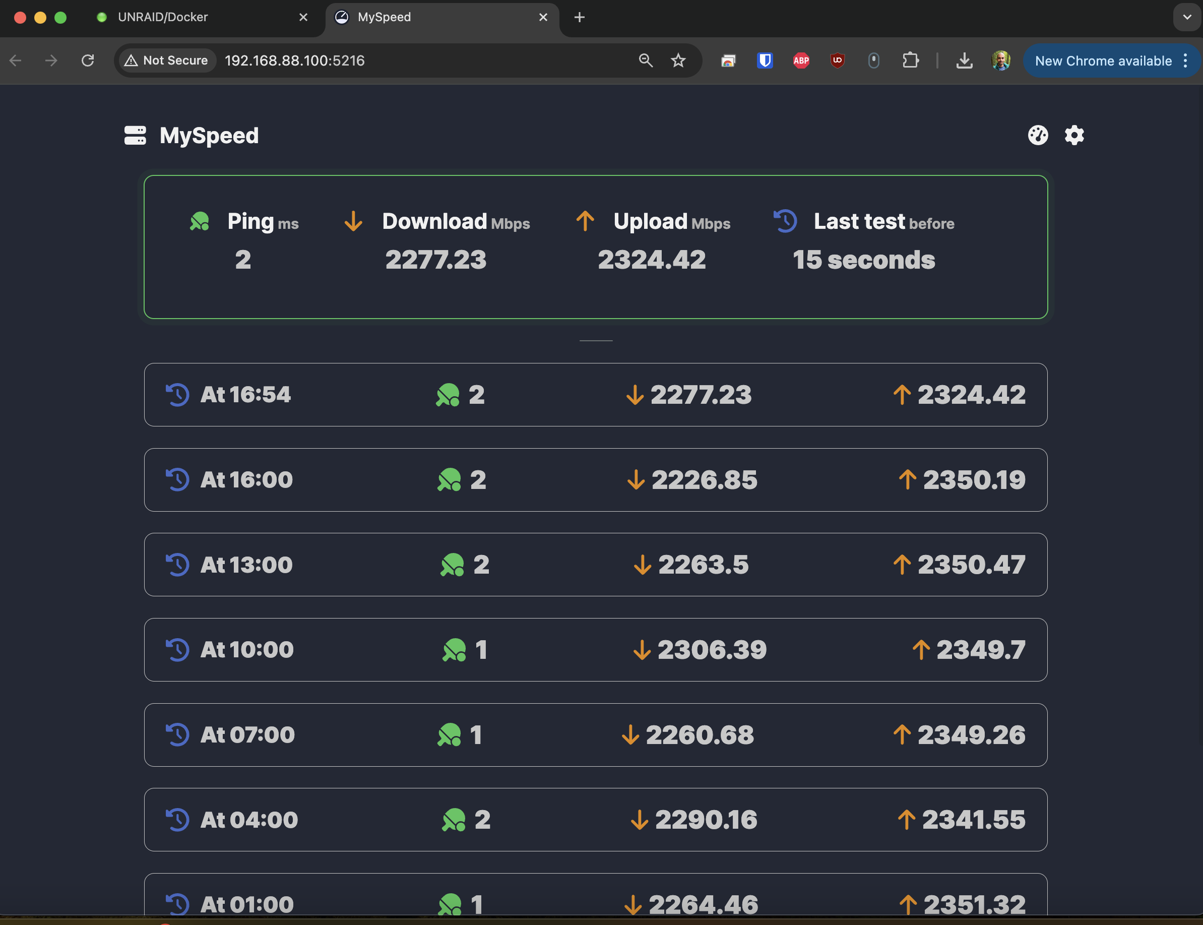

I'm fairly confident that it's not a network issue because speedtests from an Unraid app are consistently solid:

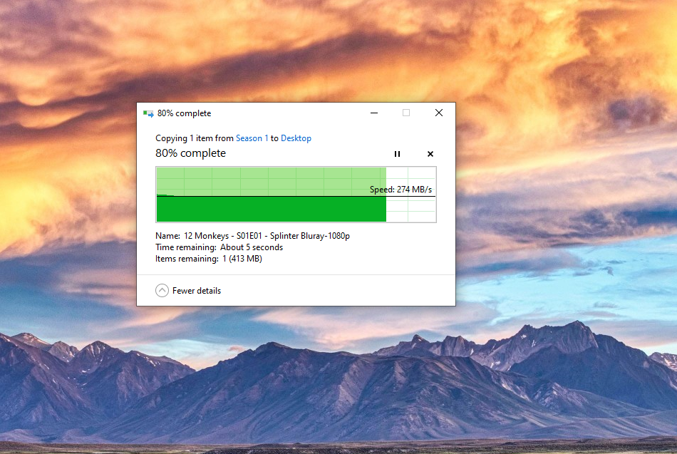

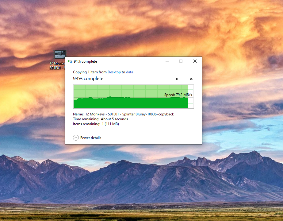

Please do a large file transfer with the Windows to see if there's any difference, and if it's still slow post the Windows explorer transfer graph.

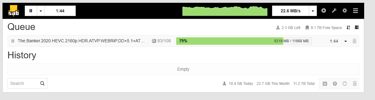

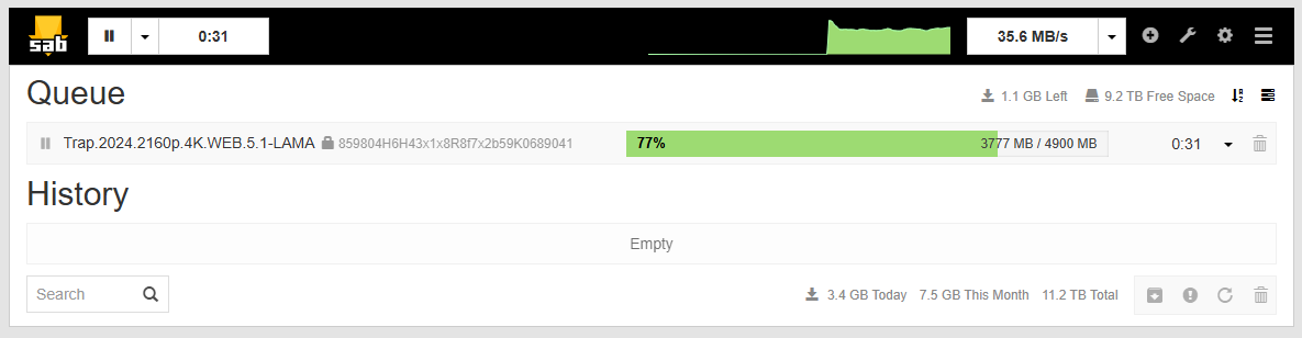

Well, we might be getting somewhere now.
Downloading a file off the Unraid server to the W10 PC was mega quick:
Writing that file back to the server (to a share that is set up as Cache -> Array) was a little slower, but still in line with the speeds I'd expect to see when downloading files.
But this is still the best it will do:
Shouldn't be a bandwidth issue, I have 4Gbps up and down service and the Unraid server has a 2.5Gbps NIC.  So not really sure where that leads us.

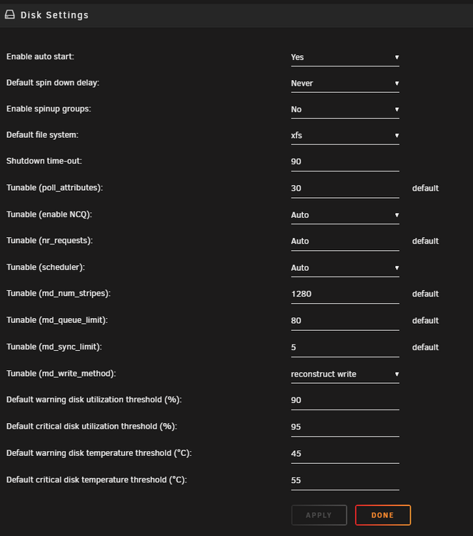

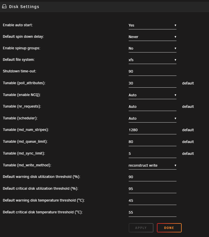

80MB/ writes and 35MB/s writes in SabNZB most likely with direct unpack enabled makes it seem like you are writing to a mechanical hard drive in the array without recontruct write turned on and not a SSD.
Just an observation.

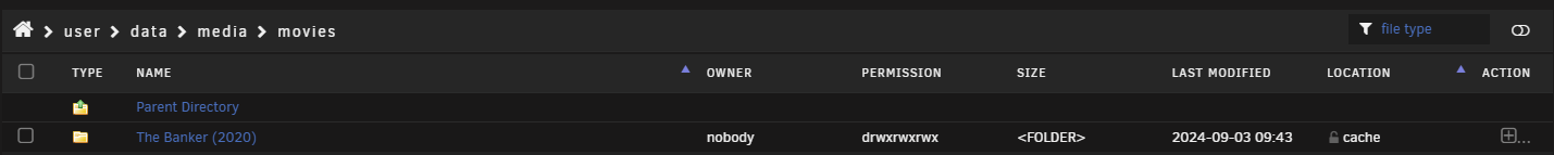

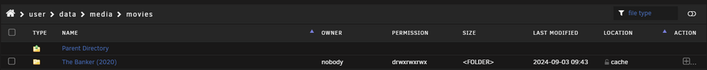

Direct unpack was not previously enabled in Sab, so I enabled it and downloaded a random movie.
During the download I checked to see where the file was being written to, and it was /data/usenet/incomplete on the cache drive.  Once the download completed, it ended up in /data/usenet/complete for a few moments (still on the cache drive).  Now it's where I'd expect it to be:
So it looks like the files are being written to the cache drive as intended, and will eventually end up on the array when the mover runs.  But why sab is still writing so slow, I can't figure out.
