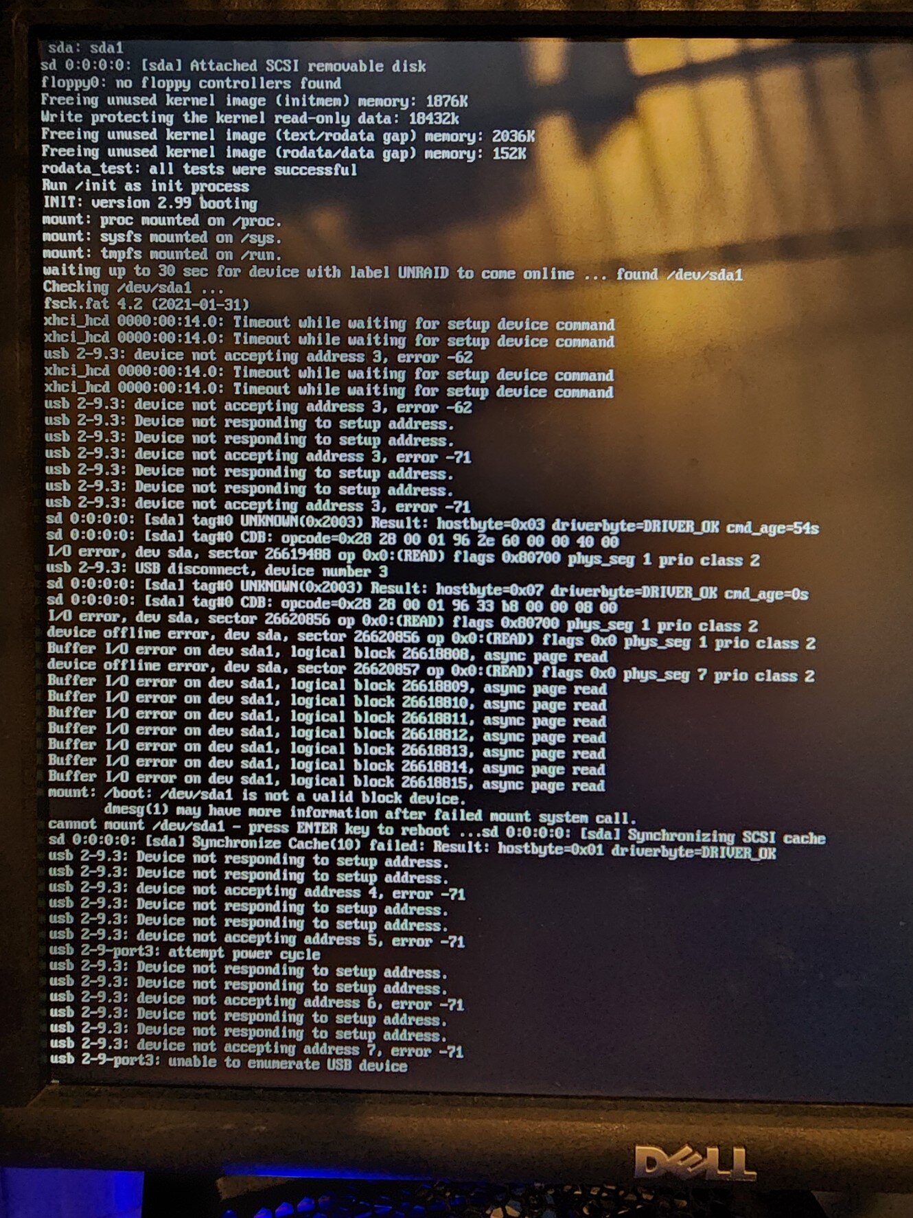

Now the system won't boot. I get the following readout on the screen.
I have tried reseating the USB and putting it in a different USB port. Same result.

UPDATE:
Moved the USB from one of the USB ports directly attached to the mobo to a port on the front of the case and that allowed it to boot up. I don't really like connecting the USB on the front like this. But I guess as long as it works.
Dockers, etc. started back up after it booted. So I THINK I'm okay. I hope.
