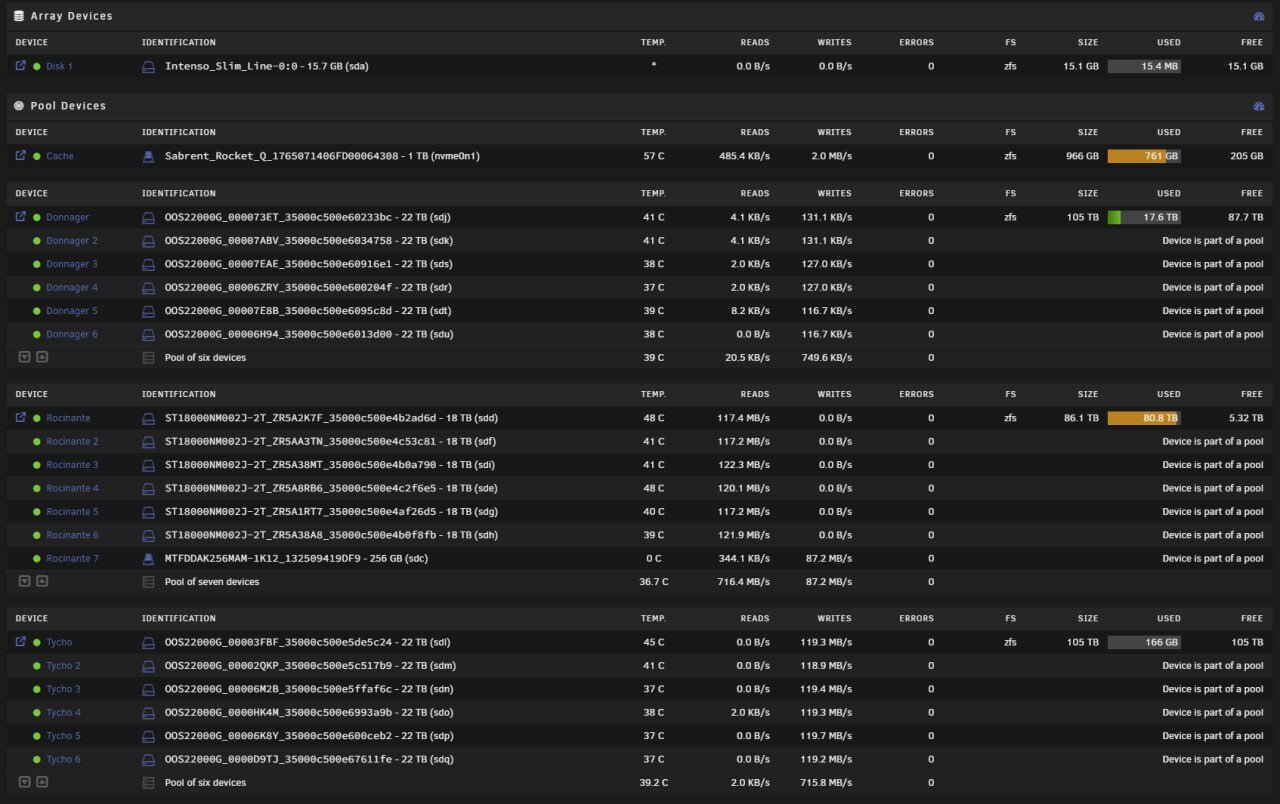

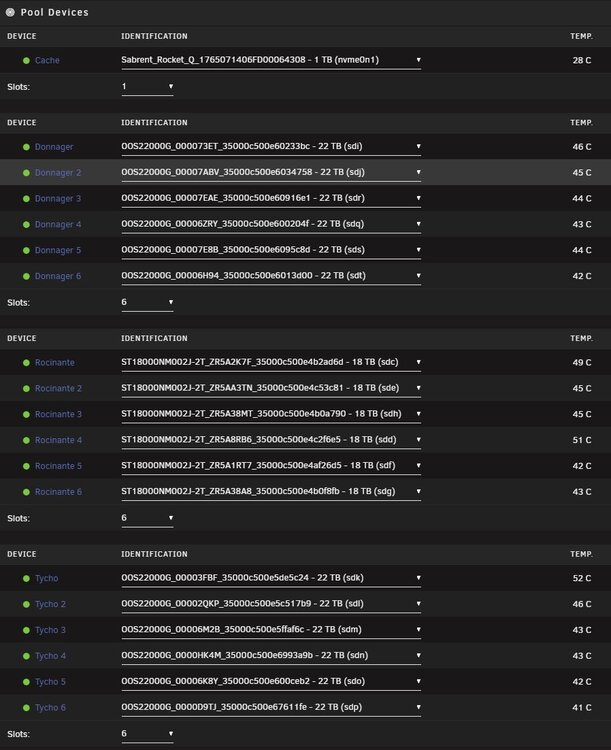

I believe v6.12 can import a degraded pool, but not 100% sure and I'm not in a place that I can test at the moment, sdk disk is originally form the other pool right? And if yes, what is the sdX for the missing rocinante pool disk?
This is one of the doubts I have had during this whole process.
I created the pool using the ZFS Master plugin and I have assigned the drives using the HDD IDs/SERIAL NUMBER as a reference.
This screenshot shows the drive names they had originally and now they are mapped in the same order.
The names of the drives have changed as a result of all this problem.
I attach a screenshot of the mapping I did from the GUI in case it is useful.
PS: I think that drive is the one that was originally in that pool (based on the serial number of the disks).
Post the current diagnostics so that I can confirm all the assignments.
Please confirm yourself, and note that all the sdX devices refer to how they appear currently, not as they were in the screenshot, but from what I see, the rocinante pool is currently using a 22TB disk (sdk) that should be in the tycho pool, the 18TB disk that should be in the rocinante pool is sdc, which is currently not being used by any pool, if that is correct, lets start by correcting the rocinante pool, import the pool manually:

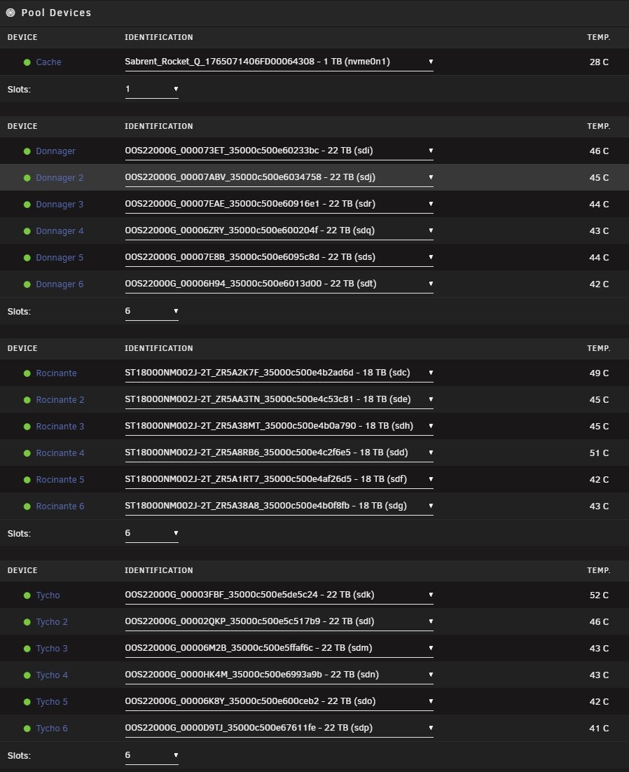

This GUI screenshot shows the current pool allocation I have.
From the GUI I see everything correct.
Shall I proceed with what you have indicated?
PS: Indeed... All the disks in the Rocinante pool must be 18 TB.
Edited by Coque
The GUI shows what you want the to look in the end, but the zpool status and zpool import show the currently assigned disks:
12 hours ago, Coque said:
