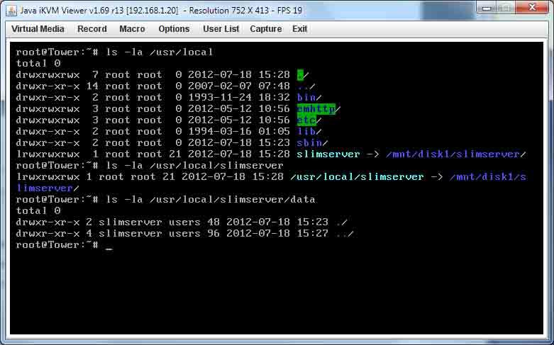

Gents, i'm totally stuck. I've tried to install the plugin, and that basically works. I'm using unRAID V5.0-rc5 and Simplefeatures. After running installplg and rebooting, everything is downloaded and installing, and there is an icon in simplefeatures, i've changed the install dir there to /mnt/disk1/slimserver, but when i start the slimserver, my console shows an error:
sudo: unable to execute /usr/local/slimserver/slimserver.pl : no such file or directory
The above folders and file exists, and it can also be found on my /mnt/disk1/slimserver.
I am totally lost here. I've searched through the forums, tried all other versions of the slimserver, but to no avail, ALWAYS the same error.
Please help.
Which plugin are you using?
The program should be located at  /usr/local/slimserver/program/slimserver.pl
Cheers, Alex

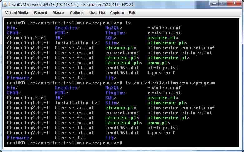

I'm using logitechmediaserver-7.7.2-plugin_v1.3.zip from the start topic.
I've just placed it in my plugin folder on the flashdrive, and ran installplg from there (it does NOT install automatically on reboot so did it manually), rebooted, and changed the installdir textbox in simplefeatures' settings to the forementioned /mnt/disk1/slimserver.
And the error is indeed:
sudo: unable to execute /usr/local/slimserver/program/slimserver.pl : no such file or directory
so you are right about that. But it still fails...
see screenshot for both folders and the symlink (?)
Anyone? Must be something really simple, its just that i have zero experience with linux and got no idea where to look or start, so please help me out... :-\

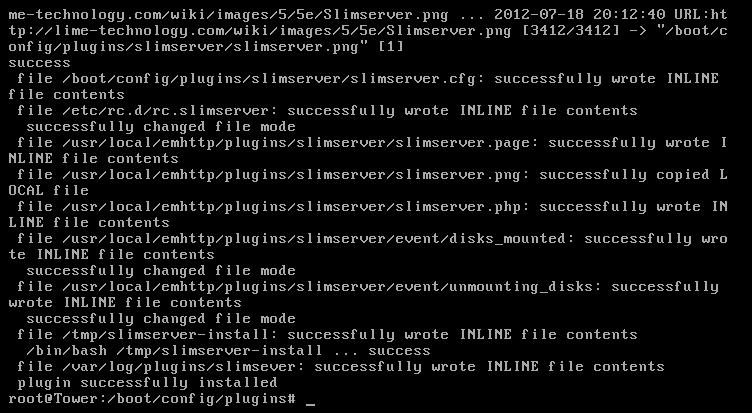

Removed everything, reinstalled... removed again, reinstalled... about 10 times... all goes well (see screenshot) but there is no way i can start this thing. All files and folders are there, but still the %$#$%$^thing complains about 'no such file or directory'. I'm about to throw my unraid machine out of the window.
PLEASE HELP!!! :-\
The command's argument --pidfile needs a slimserver.pid in the folder /var/run/slimserver? Is that correct? That folder is empty.
Also there is NO /usr/local/slimserver/data/Cache folder (--cachedir) is that correct?
Also no /usr/local/slimserver/data/log & /prefs folder is present. Should i create those folders?
Arent these created during install?
Maybe there is some way to install logitech media server by hand? Just the .tgz? I don't really need the integration in simplefeatures, as long as the thing gets installed properly and is reachable at xx.xx.xx.xx:9000 i'm ok...
Any tips are welcome.

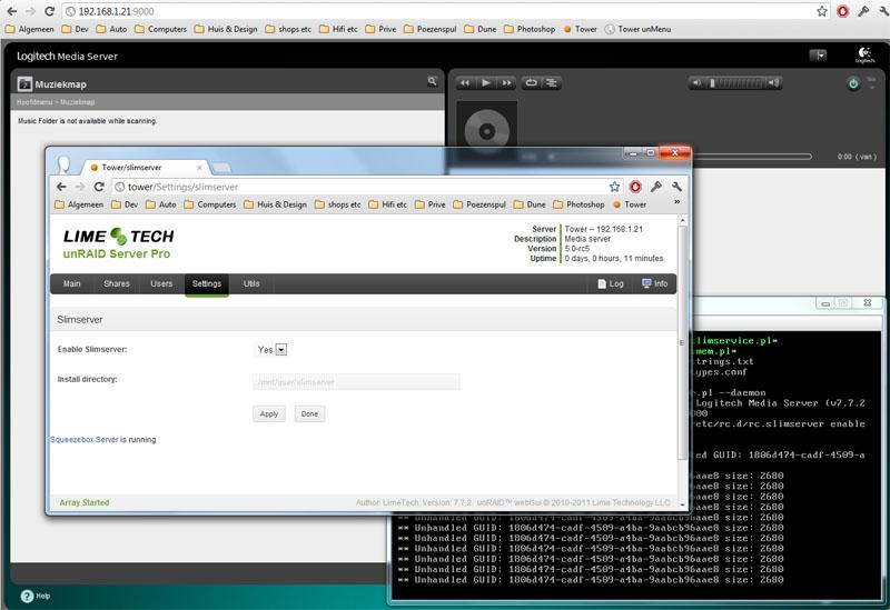

OK... tried a *lot* of sh*t... in the end i tried starting the media server from within the /mnt/usr/local/slimserver folder using just
slimserver.pl --daemon
Which for some reason works in stead of the other long command with al its parameters, and after that i could, oh wonder, start from the simplefeatures menu...
I'm not sure if all is 100% functional and have no idea why this is working and not the original setting but at least i got the webinterface at port 9000 on the unRAID machine, and its now indexing my music... and playing. Not sure it will survice a reboot, but thats another problem.

*edit* even better, after installing the Perl runtime, i am able to start Slimserver from within SimpleFeatures without a problem...
