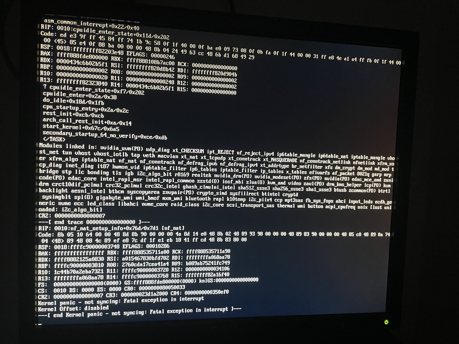

Hi, the last two nights I've noticed my server locking up. I cannot even ssh in or log into root local. Since the logs disappear after the reboot, I can't even see what led up to it. I've tried to find a way to spool the sys logs to somewhere else but I can't seem to get it to work. Any ideas what might be causing these kernel panics or what to do to get the logs that will help me diagnose?
It started happening two nights ago. The only changes were
* Added vaultwarden docker container
* Added nginxProxyManager (NPM) -- Used to use swag, disabled that container and switched to NPM
Attached is a screenshot of the kernel panic vomit from the console and the diagnostics bundle. Any help would be much appreciated.

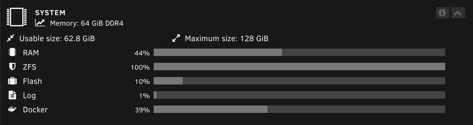

I do see ZFS is at 100% but I don't know what this metric stands for on the Dashboard page

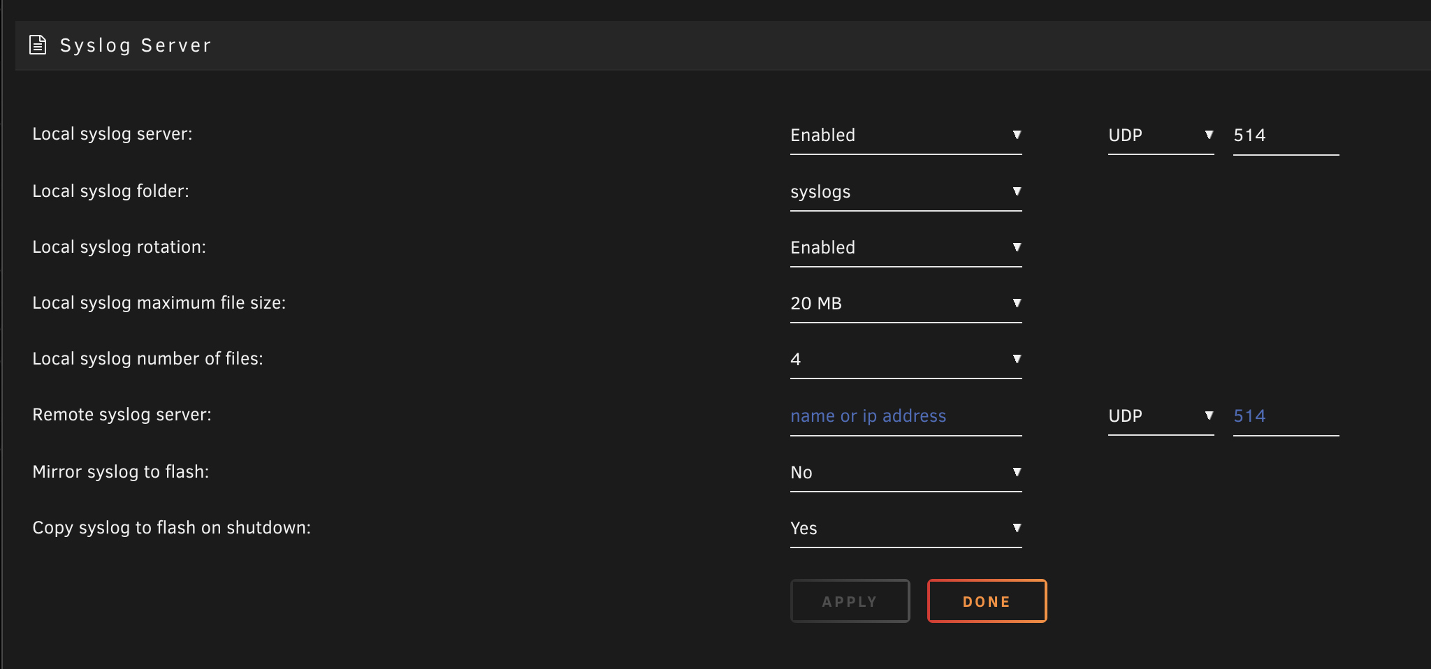

Enable the Syslog server under network services and the log will be written to the chosen location which will survive a reboot.
That call trace is not complete, but looks like it may be macvlan related, upgrade to latest stable, since macvaln with bridging is no longer an issue there.

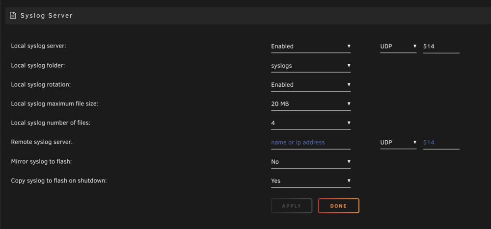

Thanks @Woodpusherghd -- I do have it enabled but I'm still not getting any syslog replication to the target share (on cache drive)
I completed the upgrade to 6.12.13, we'll see if that resolves the issue. Still cannot get syslog server to push logs to the cache share
The settings you have mean it is only listening for other servers.   As mentioned in the syslog server link to get your server to record its own entries you need to set either the Mirror to Flash option OR the Remote Syslog server field to the address of your Unraid server.
lol oops. Seems obvious now. Thanks
