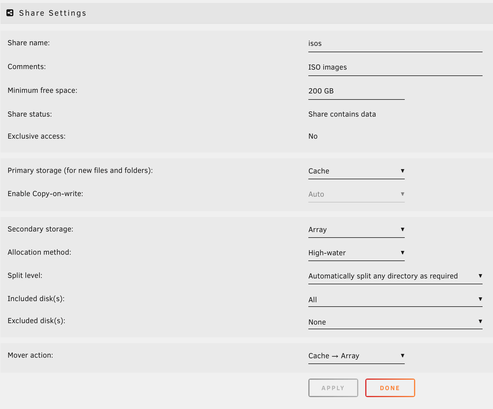

Cache to Array not completing
Following these instructions for version 6.12.13
https://docs.unraid.net/unraid-os/manual/shares/user-shares/#moving-files-from-a-pool-cache-to-the-array
Screenshot of the share configuration, the confirmation on the from shares page of the location and the limited log entries relevant

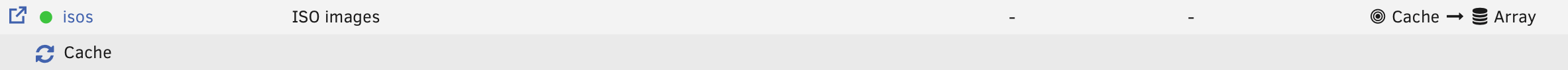

Once I initiate the Mover from the Main tab, it runs for about 10 minutes and when finished - the isos shares are still located on the Cache
VM/Docker disabled prior to running Mover
I haven't found a really good way to troubleshoot the mover
Any thoughts?

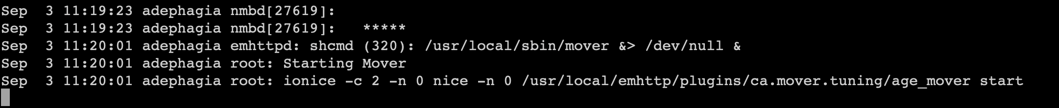

You can activate the mover logging to get more information logged.
Do the files already exist on the  array?   Mover will not  overwrite existing files.
You are using the mover tuning plugin, so you should uninstall it and retry, or if it's not working as expected, ask in the plugin support thread.
@JorgeBgood catch - I don't recall when I installed the plugin - I never configured it - but once I removed it - the mover seems to be doing its job now - waiting on a 700gb move from cache to array right now, but it appears it is working - and the isos share above moved over as well...
