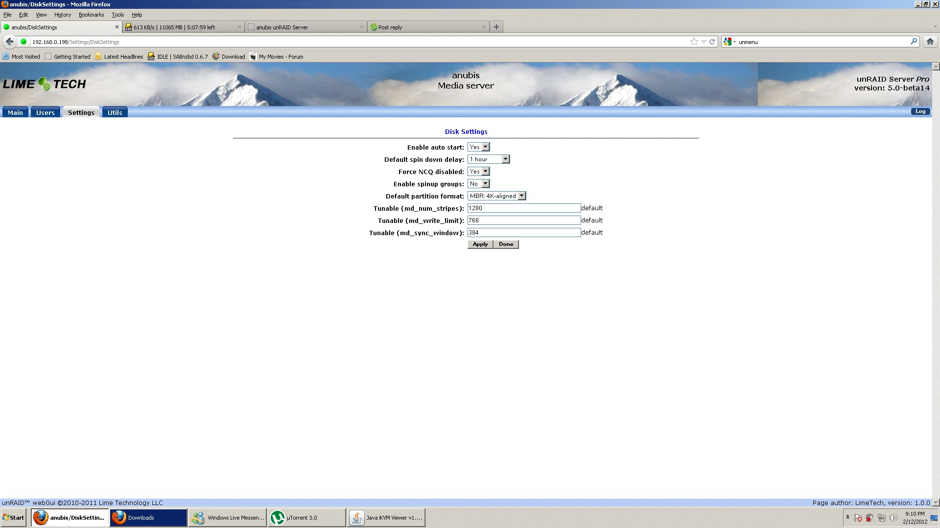

pro said arrray can be auto started? is that the setting in the attached picture? id so that has been like that since day 1  maybe this fresh install will fix this
I would guess so, my array started starting itself, may have been set like that after i installed something...this thing is leading me around at the moment...i want to do what your doing, wipe the flash as start from scratch..how you going about that ?...i seemed to have it working the other day..everything was set fine, now this morning i come home to find sab saying that script could not be run, sabnzbtosickbeard.py is missing from sabnzb now even though it is still pointing to it in the sickbeard folder...this is what pisses me off, i have not even touched it..it was working so i left it..now this, please let me know how you go about refreshing your flash.
