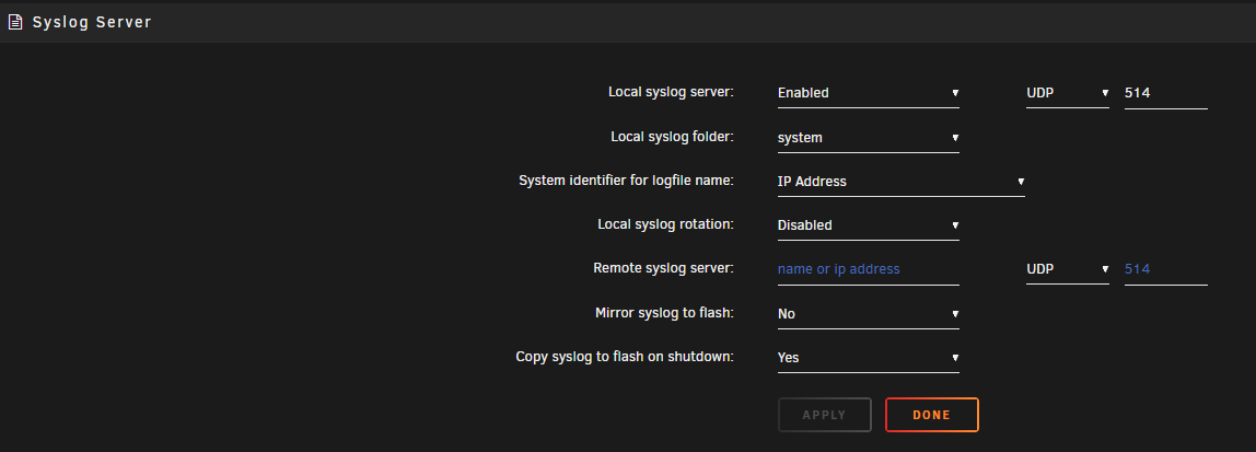

September 3, 20242 yr Community Expert Diags look to be after a reboot, enable the syslog server and post that after it happens again.
September 4, 20242 yr Author 42 minutes ago, JorgeB said: And the persistent syslog? syslog-192.168.1.116.log

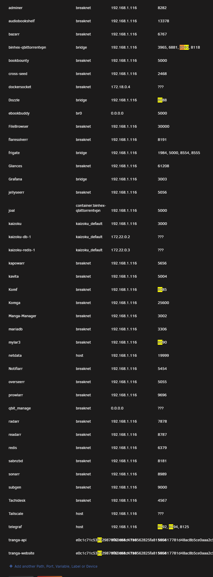

September 5, 20242 yr Community Expert Missed the earlier post, only possible issue I see logged is this one: Sep 4 12:03:24 core rc.nginx: Reloading Nginx server daemon configuration... Sep 4 12:03:24 core nginx: 2024/09/04 12:03:24 [emerg] 11811#11811: bind() to 127.0.0.1:80 failed (98: Address already in use) Sep 4 12:03:24 core nginx: 2024/09/04 12:03:24 [emerg] 11811#11811: bind() to 192.168.1.116:80 failed (98: Address already in use) Sep 4 12:03:24 core nginx: 2024/09/04 12:03:24 [emerg] 11811#11811: bind() to 127.0.0.1:14444 failed (98: Address already in use) Sep 4 12:03:24 core nginx: 2024/09/04 12:03:24 [emerg] 11811#11811: bind() to 192.168.1.116:14444 failed (98: Address already in use) Sep 4 12:03:24 core nginx: 2024/09/04 12:03:24 [emerg] 11811#11811: bind() to 127.0.0.1:80 failed (98: Address already in use) Sep 4 12:03:24 core nginx: 2024/09/04 12:03:24 [emerg] 11811#11811: bind() to 192.168.1.116:80 failed (98: Address already in use) Sep 4 12:03:24 core nginx: 2024/09/04 12:03:24 [emerg] 11811#11811: bind() to 127.0.0.1:14444 failed (98: Address already in use) Sep 4 12:03:24 core nginx: 2024/09/04 12:03:24 [emerg] 11811#11811: bind() to 192.168.1.116:14444 failed (98: Address already in use) Something is trying to use the ports mapped to the GUI.
September 6, 20242 yr Author 22 hours ago, JorgeB said: Missed the earlier post, only possible issue I see logged is this one: Sep 4 12:03:24 core rc.nginx: Reloading Nginx server daemon configuration... Sep 4 12:03:24 core nginx: 2024/09/04 12:03:24 [emerg] 11811#11811: bind() to 127.0.0.1:80 failed (98: Address already in use) Sep 4 12:03:24 core nginx: 2024/09/04 12:03:24 [emerg] 11811#11811: bind() to 192.168.1.116:80 failed (98: Address already in use) Sep 4 12:03:24 core nginx: 2024/09/04 12:03:24 [emerg] 11811#11811: bind() to 127.0.0.1:14444 failed (98: Address already in use) Sep 4 12:03:24 core nginx: 2024/09/04 12:03:24 [emerg] 11811#11811: bind() to 192.168.1.116:14444 failed (98: Address already in use) Sep 4 12:03:24 core nginx: 2024/09/04 12:03:24 [emerg] 11811#11811: bind() to 127.0.0.1:80 failed (98: Address already in use) Sep 4 12:03:24 core nginx: 2024/09/04 12:03:24 [emerg] 11811#11811: bind() to 192.168.1.116:80 failed (98: Address already in use) Sep 4 12:03:24 core nginx: 2024/09/04 12:03:24 [emerg] 11811#11811: bind() to 127.0.0.1:14444 failed (98: Address already in use) Sep 4 12:03:24 core nginx: 2024/09/04 12:03:24 [emerg] 11811#11811: bind() to 192.168.1.116:14444 failed (98: Address already in use) Something is trying to use the ports mapped to the GUI. Weird, cannot find it in the docker containers list
September 6, 20242 yr Community Expert Maybe it was just nginx trying to use the same ports, does the timecode coincide with the issues?
