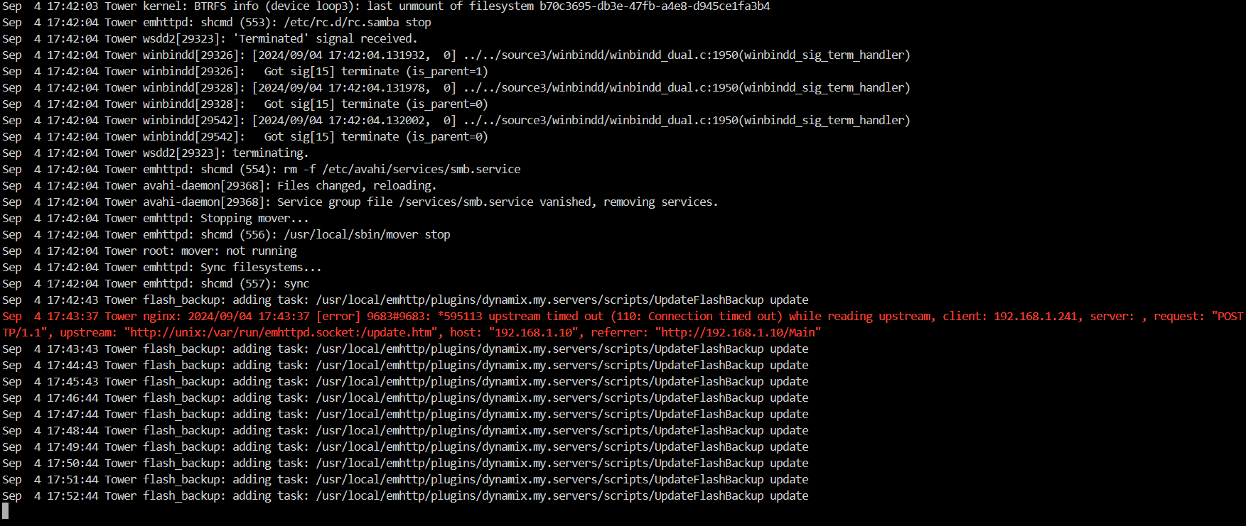

September 4, 20242 yr Curious on this, when I stop the array it does work, but if the server has been online for days, and i have moved TBs of data to it, when I stop it, it might take an hour or so, is this normal when you are dealing with arrays that are large. Now if i stop the array right after a reboot, it will stop in minutes, just curious, what this task is actually doing, and if there is any relationship to the fact when i see slows, its after I written say 10TBs of data to it. I have seen log entrys about a back usb that repeats when i am seeing this issue.
September 4, 20242 yr Community Expert That's not normal, but you can post the syslog when it eventually stops to see if the reason shows up there.
September 4, 20242 yr Author interesting, even though the array was "stopping sync file system" i was able to go into the unraid connect plugin and disable updates... its logged stop watching for file changes and unmounted the disks and completed normally
September 5, 20242 yr Author thats seems to be for sure the issue, now that i disabled the flash backups, the array stops in less then a minute every time... not exactly sure how to troubleshoot this one? Edited September 5, 20242 yr by BOBOkingbbe9
September 5, 20242 yr Community Expert Recommend posting in the Connect plugin support sub-forum, because I think that should not happen.
