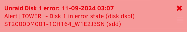

Honestly I think this disk is probably cooked, it's really old, so at this point I would probably just move forward with replacing it. Is that possible to move forward with from here, and what steps should I take? Thanks!
Swap the dead 2TB with the new 12TB and let it rebuild array.  If you want extra precaution, turn array back on and copy your emulated data to another location first.

Possibly, it still looks more like a power/connection issue, but if you have replaced both cables it may be the disk.
