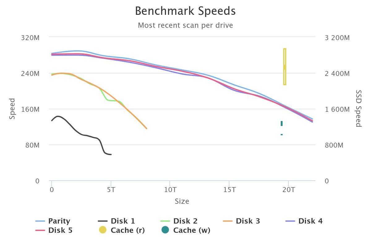

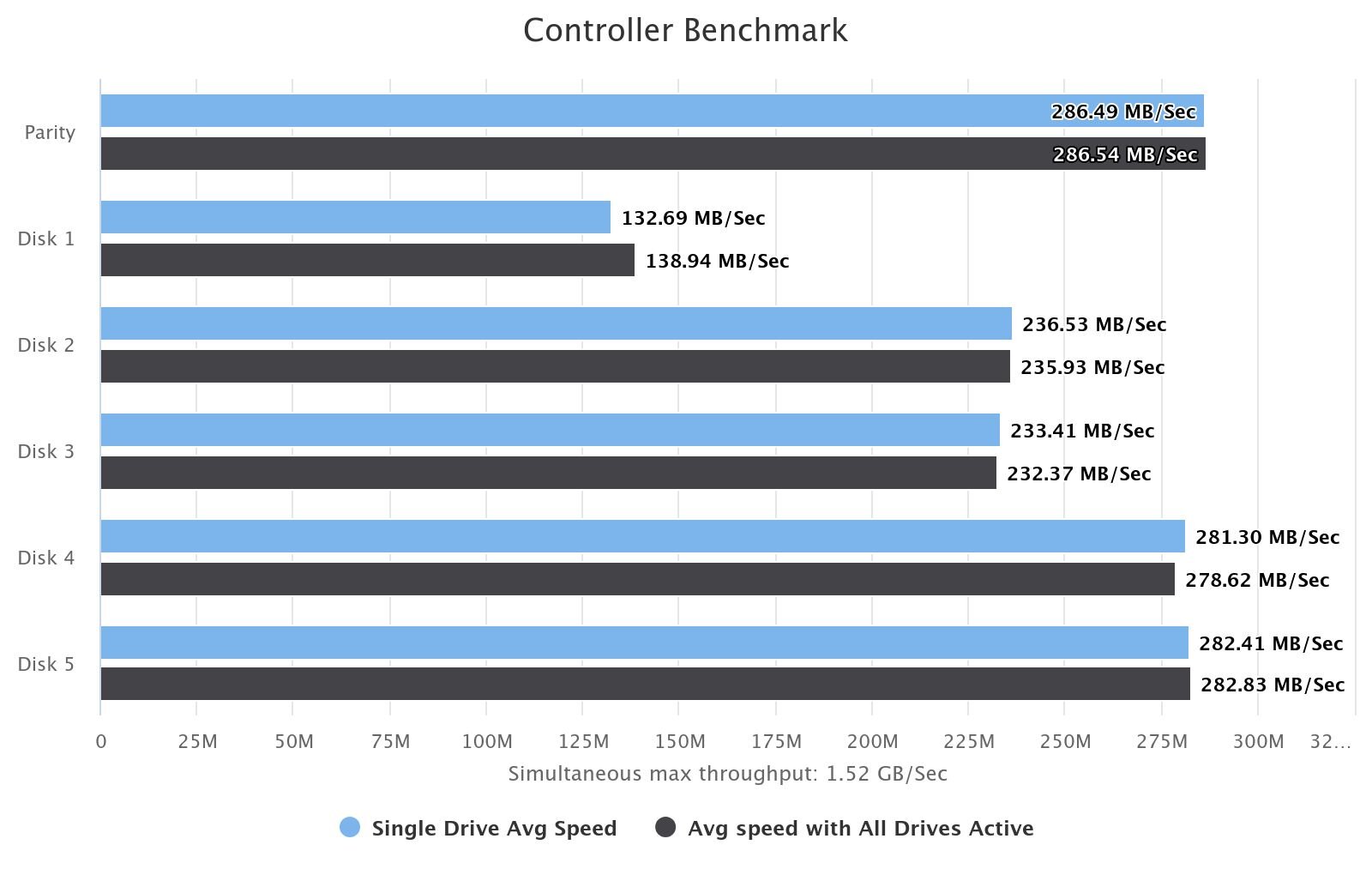

4. Tested array with DiskSpeed container. Slowest drive average 138 MB/s and fastest drive average 286 MB/s with a simultaneous max throughput of 1.52 GB/s. Therefore it is not a drive or the controller problem.

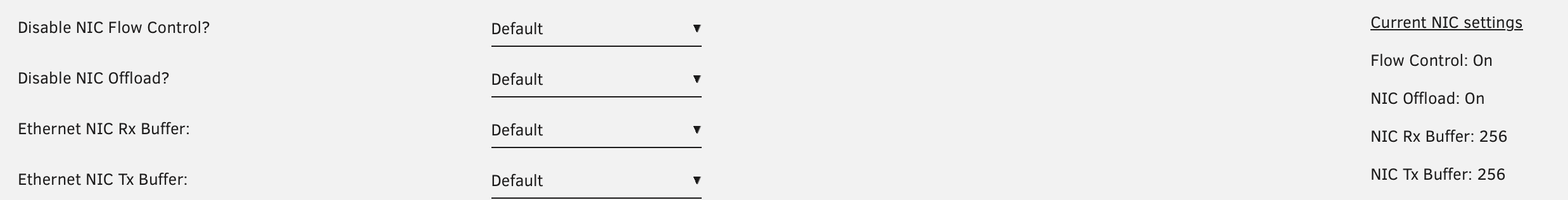

6. In Tips and Tweaks, I have tried (one at a time) disbling NIC Flow Control and NIC Offload. I have also increased Rx and Tx buffer to 1024. Still no changes to transfer speed.

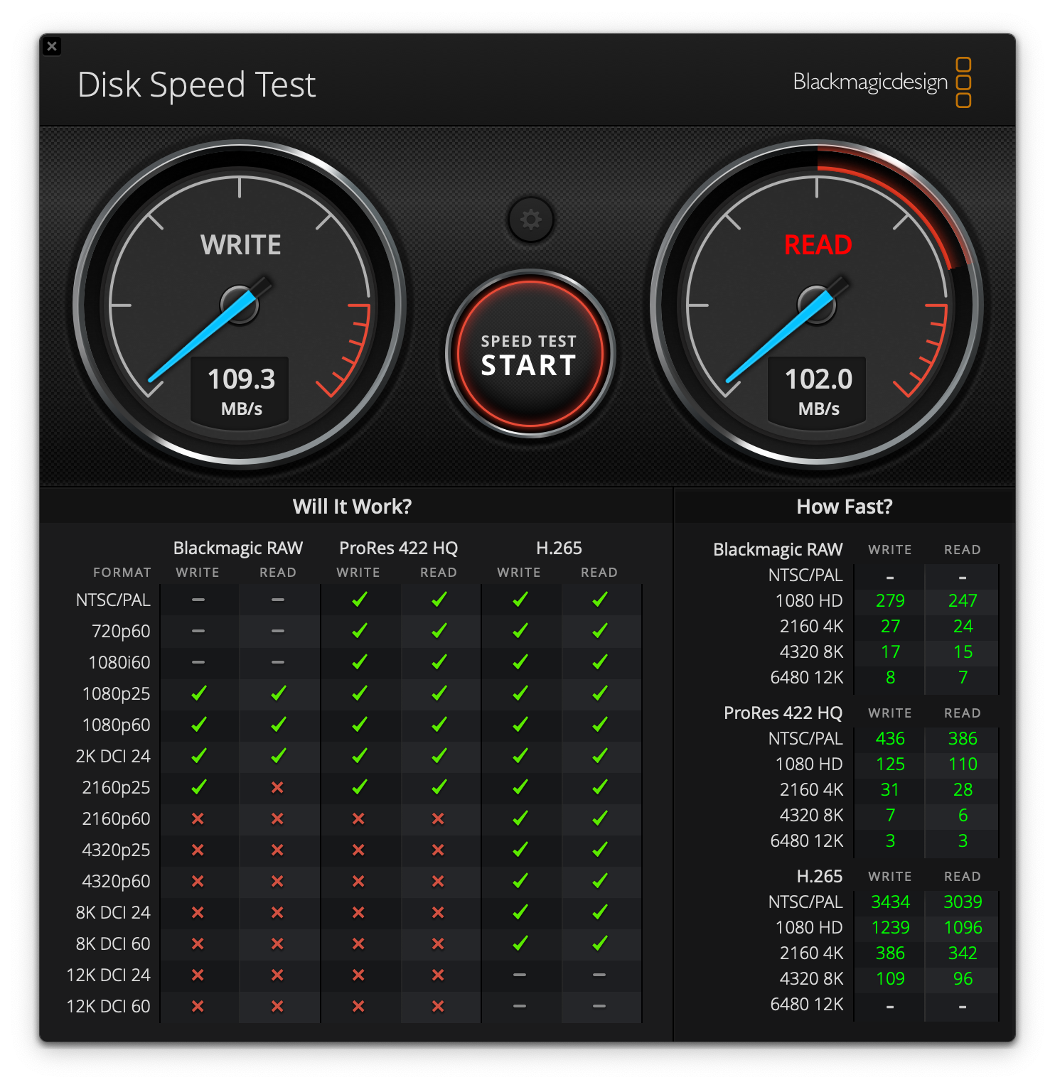

12. Doing a transfer speed test from my Mac to Unraid using Blackmagic Disk Speed Test always give random results. Sometimes it achieve full 100MB/s but most other times it is way less around 10-20 MB/s. The same test to Synology share always gets 100MB/s.

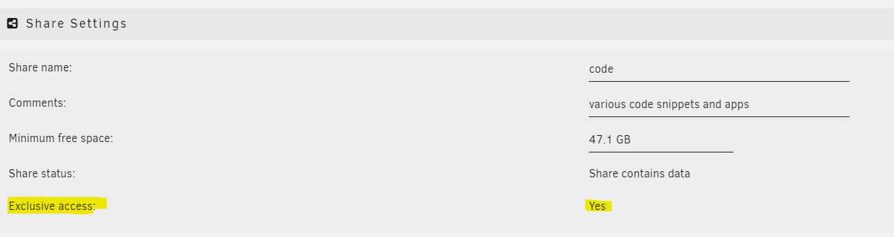

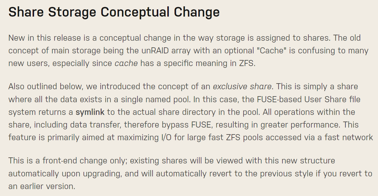

Have you actually set the shares to have Exclusive Access?
I'm trying to think back to my Synology migration to Unraid...I think I went for rsync via ssh rather than using a Samba or NFS share mounted in either direction.  Anyway I noticed a Samba performance increase post migration after setting the above.
https://unraid.net/blog/6-12-0-stable

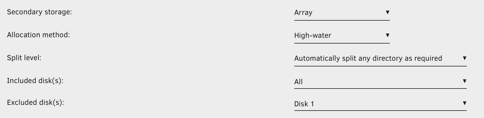

I'm transferring to a "Media" share spread over 4 drives (disk2 to disk5). Since it is spread over 4 drives it does not have exclusive access. The share has cache enabled but I am transferring to /mnt/user0 to bypass cache.
However, when I tested copying a file to "appdata" share that is cache-only and have exclusive access, the transfer speed still hovers around 30MB/s which is puzzling to me as it is writing directly to the ssd cache pool.
I did not know you could rsync over ssh, thanks for the suggestion, I will have to try that. Since iperf between the Synology and Unraid was full gigabit, I think I will see a speed improvement with rysnc.

FWIW I've 4 disks in a zpool with a samba share built ontop and this has exclusive access no issues.
I just tried disabling cache on the share again and it does not have exclusive access. I think it's because you use zpool so you have a single unified pool similar to how Synology handles the volumes. I just use the regular xfs as I want to mix and match the disk as well as to spin down the disk when not in use.
This is because it is a pool with a single file system.   When in the array each disk is a separate file system.

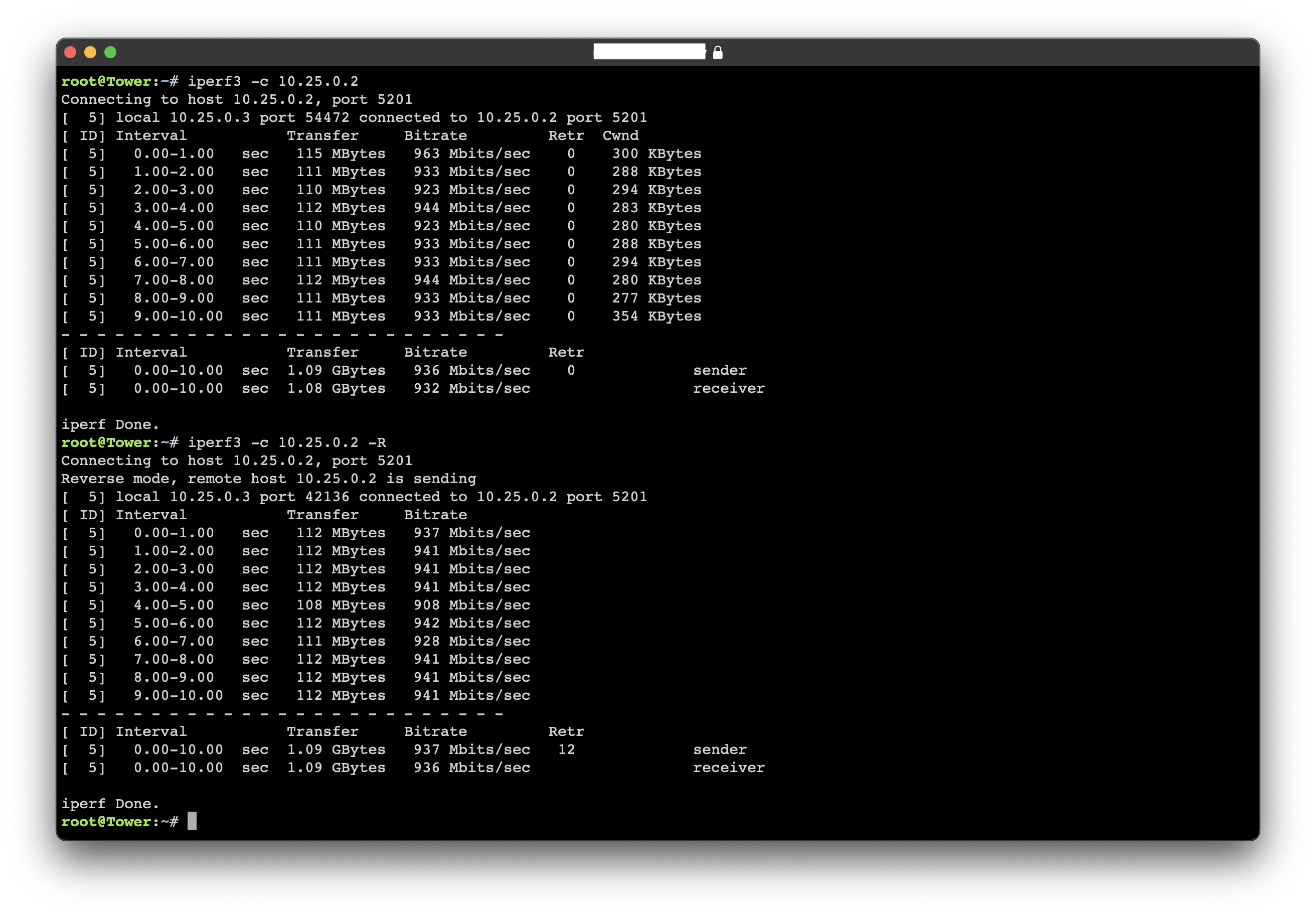

You mentioned running  iperf, please post the actual results of a single stream test in both directions.
iperf test to Synology NAS

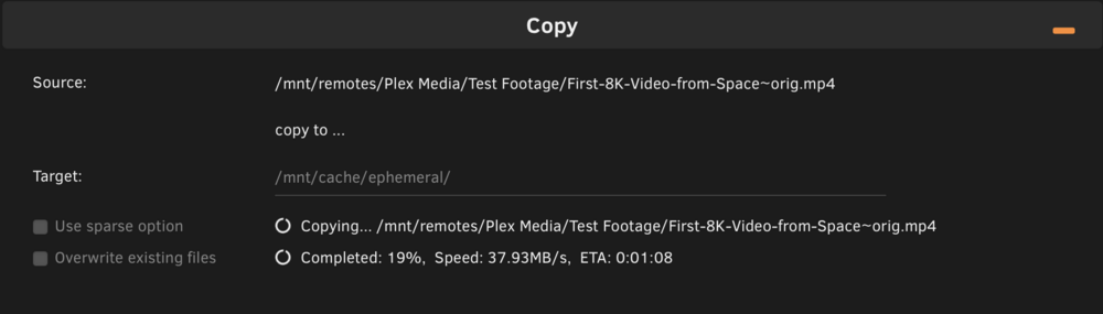

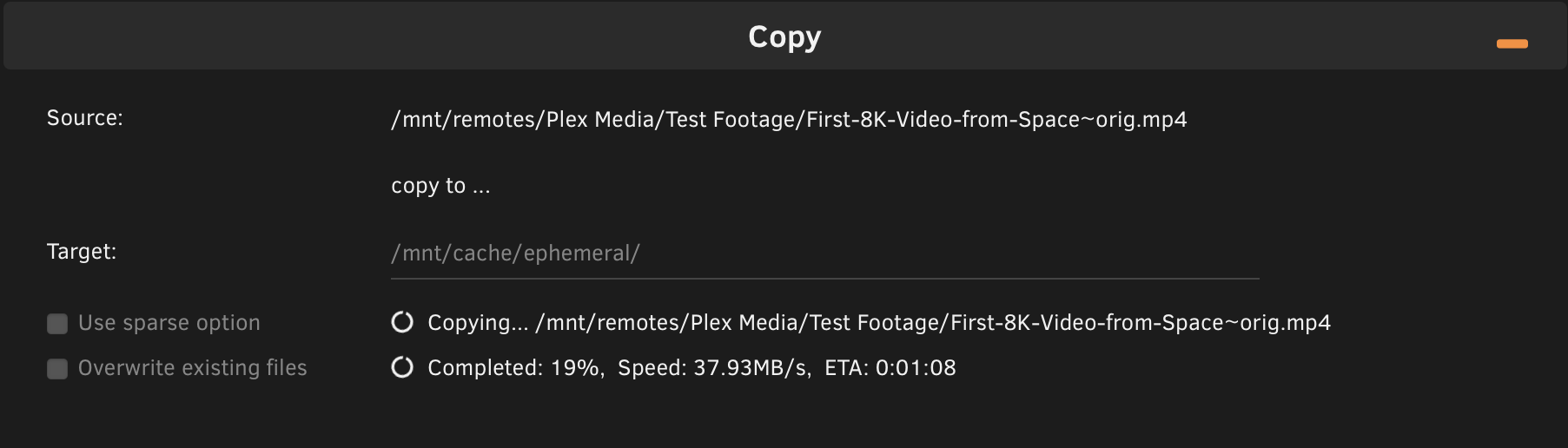

copy direct to /mnt/cache of "ephemeral" – a cache-only share

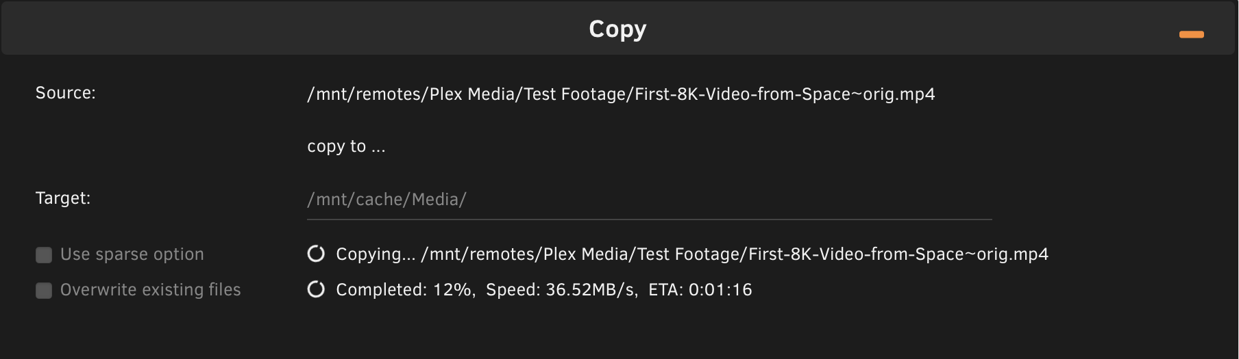

copy direct to /mnt/cache of "Media" – the target folder

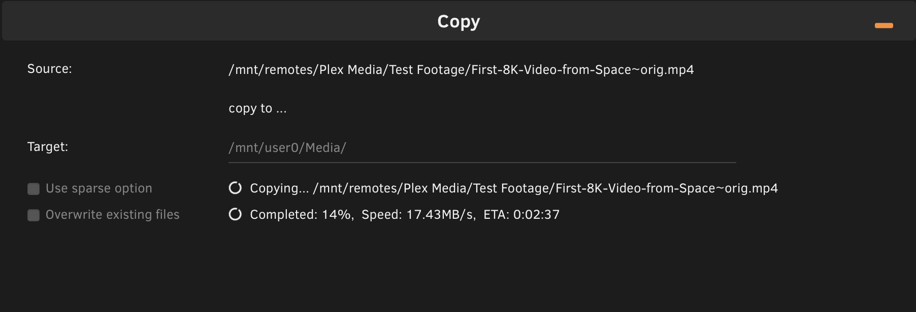

copy to /mnt/user

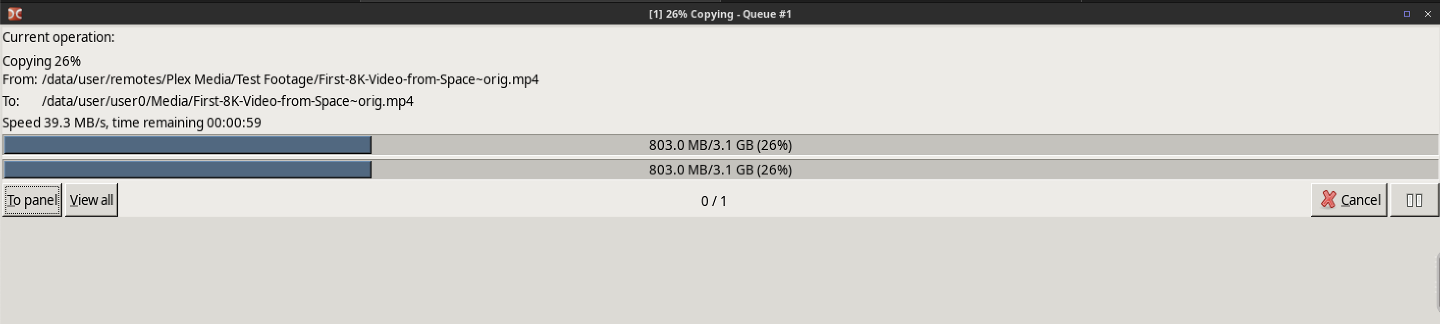

copy to /mnt/user0 (I think this is FUSE but bypass cache) which is my intended way of copying all the files.

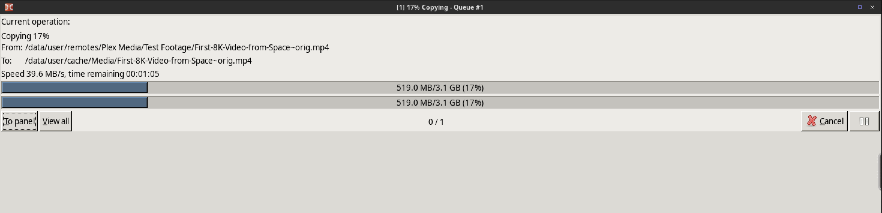

Same as above but using double commander. Better speed here.
Lastly a copy using double commander directly to /mnt/cache/Media
Drives and Controller benchmark
controller-benchmark.thumb.jpeg.6ec3f877b80f82c14aed604f1d01d873.jpegbenchmark-speeds.thumb.jpeg.2f1723bf5ab17cbf00189eae0727bb3b.jpeg

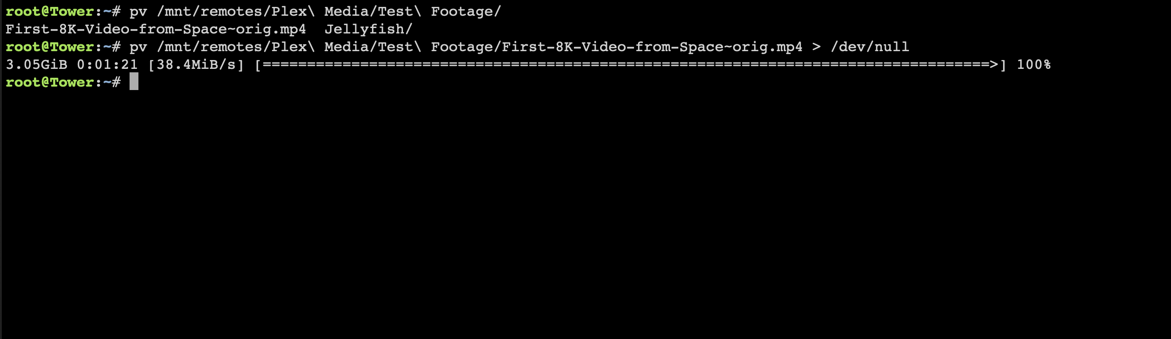

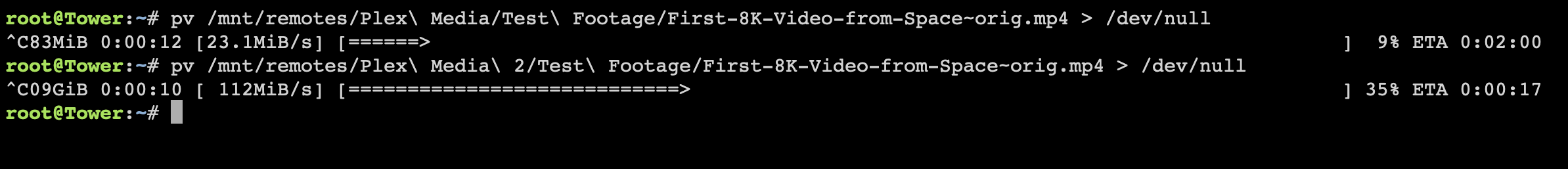

Try this and post the results, in the Unraid CLI type:
pv /mnt/remotes/path/to/large/file > /dev/null
Screenshot2024-09-07at1_31.18inthemorning.thumb.png.48aa67f00e2cc16a2ac972877dc83105.png

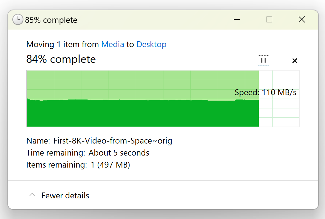

To me that confirms the source is the problem, do you have a PC that you could use to make an SMB transfer to Unraid?

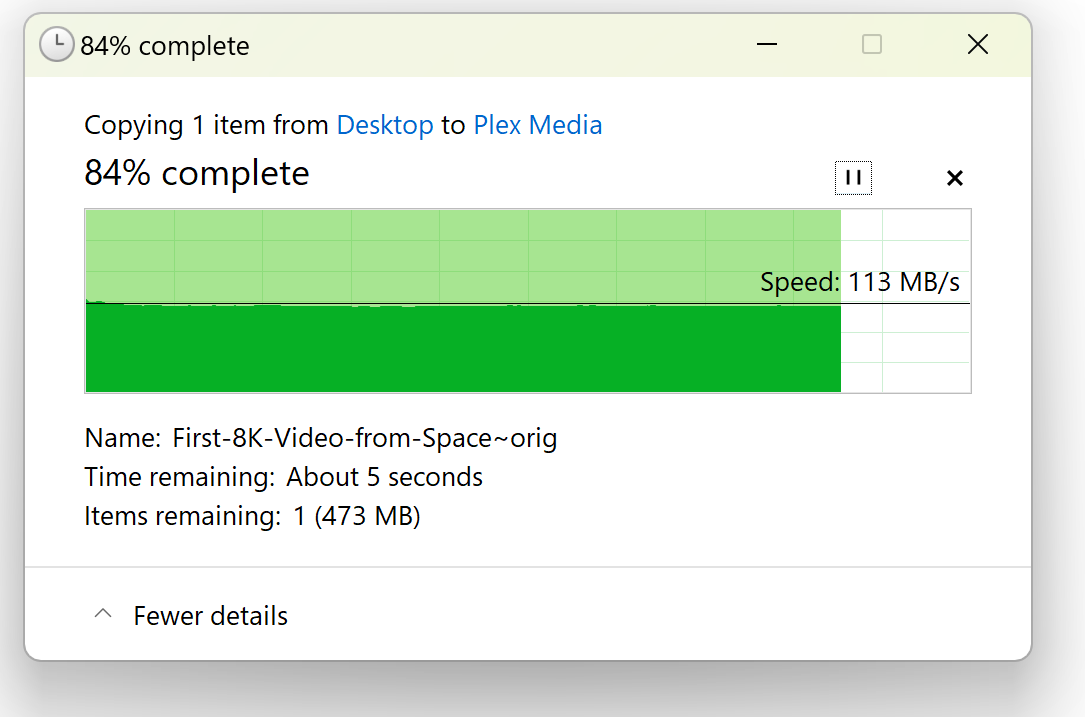

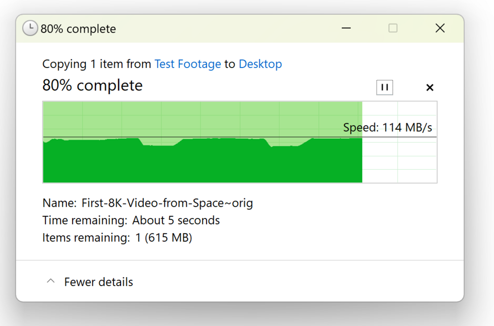

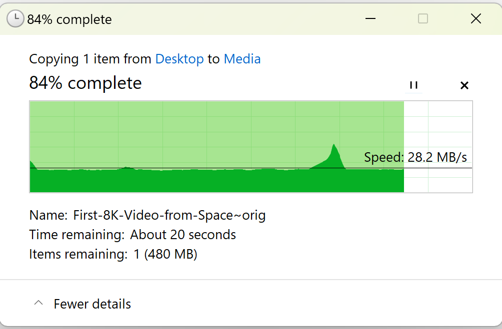

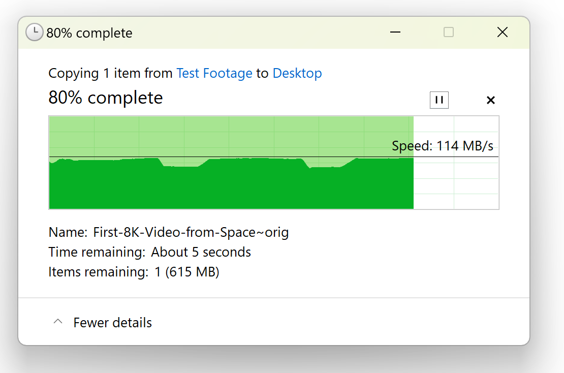

Tested with a spare windows laptop. Seems like the issue is writing into Unraid. No problem with reading or with the Synology NAS.
From Unraid to Desktop:
From Desktop to Unraid. Copying to "Media" share – a share with Cache as primary and Array as secondary.
From Synology to Desktop
From Desktop to Synology
The test with pv confirmed the problem was not writing to Unraid, since it was sending the data to /dev/null and it was still slow, but if it's also slow with the laptop, it suggests a network issue, despite the good iperf results, do you have a different NIC you could test with? I also would try a direct connection from the laptop to Unraid, to rule out cable/switch issues.

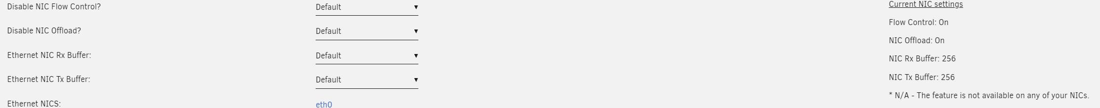

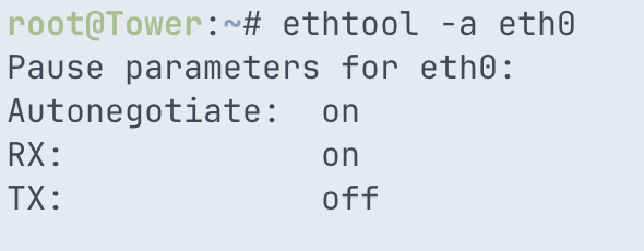

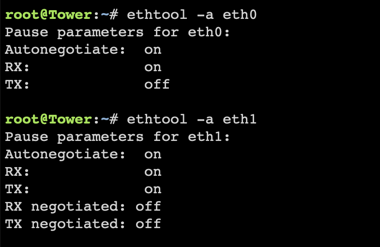

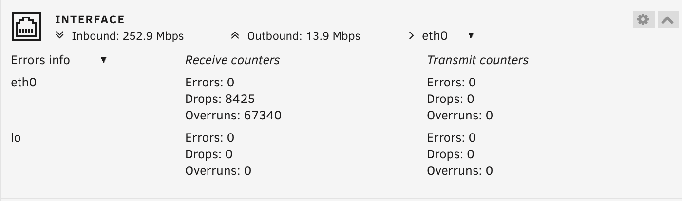

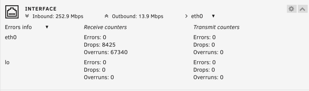

I think you're right that it's a network issue. Looking at the Errors Info, I'm seeing a lot of drops and overruns for receive counters.Screenshot2024-09-07at3_23.53intheafternoon.thumb.png.f47c7a830417f05fe90db53dee19a34b.png
It seems like flow control was enabled for Rx but not for Tx.
In tips and tweaks, Flow Control is enabled by default.
Screenshot2024-09-07at3_25.03intheafternoon.thumb.png.e16f078197b851cc3982e6e7a5a1a411.png
Do you recommend to enable or disable flow control for both Rx and Tx?
Edited by Sak
Comparison for you...
~# ethtool -a eth0
Pause parameters for eth0:
Autonegotiate:  on
RX:             on
TX:             on

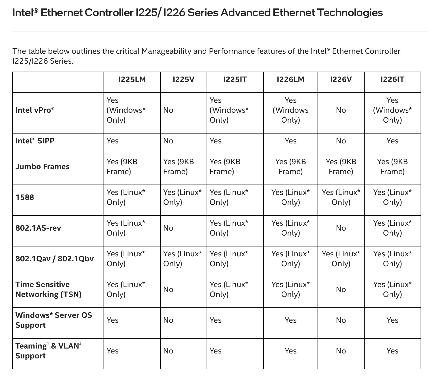

Thanks for the help so far. After switching out cables and testing all network equipments, it is definitely an issue with the Ethernet controller: Intel Corporation Ethernet Controller I226-V (rev 06) on my motherboard.
Another user had a problem with this NIC as well.
Officially VLANs are not supported on this ethernet controller. However my setup had a vlan enabled in network settings. I thought that might be the cause of the issue but even after I deleted all the VLANs, the issue still persists.
Another odd thing I noticed is that flow control for Tx cannot be turned on. I have tried enable/disable through both "Tips and Tweaks" as well as using the ethtool -A commands. Flow control for Autonegotiate and Rx can be turned on and off, however Tx always remains off.
In addition, I noticed that when I have turned off flow control for this NIC, sometimes Rx would be on by itself:
Autonegotiate:	off
Rx:		on
Tx:		off

is it possible to install our own driver for the I226V? https://www.intel.com/content/www/us/en/download/15084/intel-ethernet-adapter-complete-driver-pack.html
The USB Ethernet adapter is not an ideal permanent solution.
Not that I know of.
Not that I know of.
A quick google search seems to reveal a lot of stability issues with i225 and i226. Hopefully it is fixed soon through the IGC driver updates.
