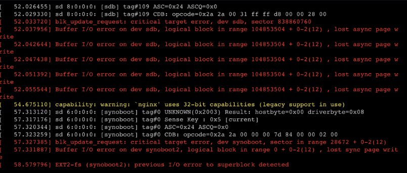

Hello! I installed my Virtual Diskstation on my Unraid server as a Docker. To test it, I had the data in the cache (NVME) and now I wanted to push the data to the array (HDD). I created a share that only writes to the array. I copied the files from the NVMe to the new Share and set the permissions. And when I start the container, I get the error messages from the screenshot. Permissions are correct so far. What can I do to make the container start correctly?
I also try it to create a new Container with new virtual harddisks. Same error.
