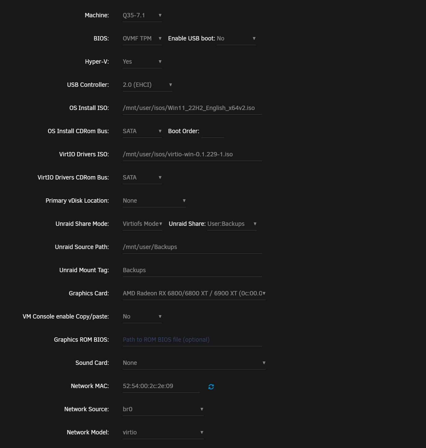

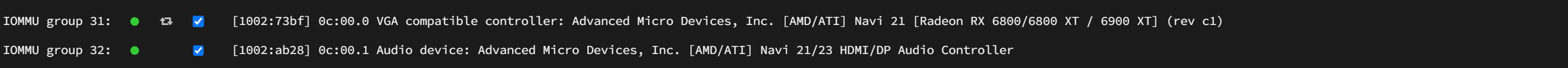

September 7, 20242 yr Hi all, I am having an issue with my VM that I never use to have as I had an NVIDIA gpu passthrough prior. I now have an AMD RX6800XT passthrough. When I need to shut down my Windows VM or reboot my Windows VM, I get no display. I tried installing the AMD Vendor Reset plugin which didnt help (Not sure if it needs to be configured or not). I notice when I look at the logs for the VM that I get "2024-09-07T04:31:47.658937Z qemu-system-x86_64: vfio: Cannot reset device 0000:0c:00.0, depends on group 32 which is not owned." in the logs. I dont have the audio side of the GPU passed through so that may explain that error. tower-diagnostics-20240907-1403.zip
September 7, 20242 yr Community Expert Solution 4 hours ago, JWMutant said: Hi all, I am having an issue with my VM that I never use to have as I had an NVIDIA gpu passthrough prior. I now have an AMD RX6800XT passthrough. When I need to shut down my Windows VM or reboot my Windows VM, I get no display. I tried installing the AMD Vendor Reset plugin which didnt help (Not sure if it needs to be configured or not). I notice when I look at the logs for the VM that I get "2024-09-07T04:31:47.658937Z qemu-system-x86_64: vfio: Cannot reset device 0000:0c:00.0, depends on group 32 which is not owned." in the logs. I dont have the audio side of the GPU passed through so that may explain that error. tower-diagnostics-20240907-1403.zip 301.8 kB · 0 downloads Likely because you have not included the Audio part of the card in the VM Template. Add sound card for the audio part.
September 7, 20242 yr Author Yea the audio was part of the problem. Turns out if your Video card has USB type C on it as well you have to pass through the whole lot Video card, Sound, USB controller and Bus controller. If you dont, the card will not reset.
