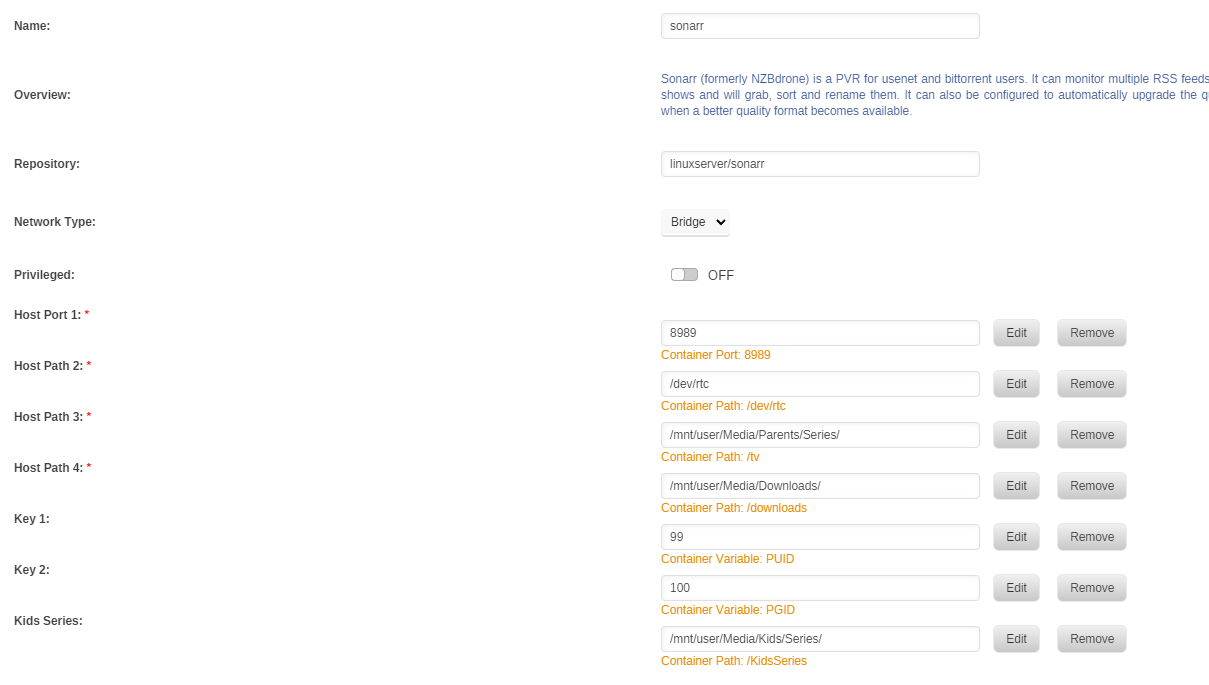

the only path not on my hard drive is Path 2 for Sonarr
and the config      /mnt/user/appdata/sonarr    but that is a share on hard drive
