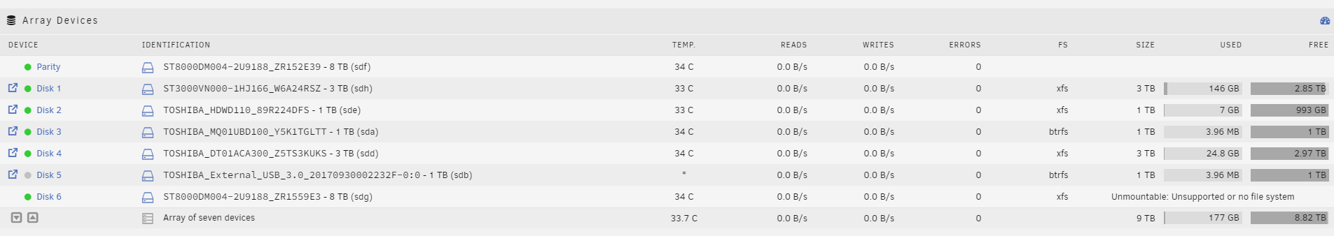

Hello everyone, I have a problem that I have often read here in the forum. I have already tried a few things.
Problem is “Unmountable: Unsupported or no file system”
What I have already done:
-checked and replaced the cable
-New power supply installed
-Run “Check Filesystem Status” in maintenance mode
Now I don't know what to do and need your help.
Thanks for the help

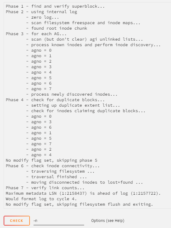

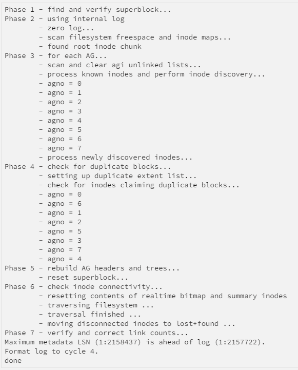

Post the output
Run it again without -n
Wow, that was much too easy, all my data is back. Should I pay attention to anything else now? Like backing up the data and changing the hard drive? I don't seem to know enough about that
