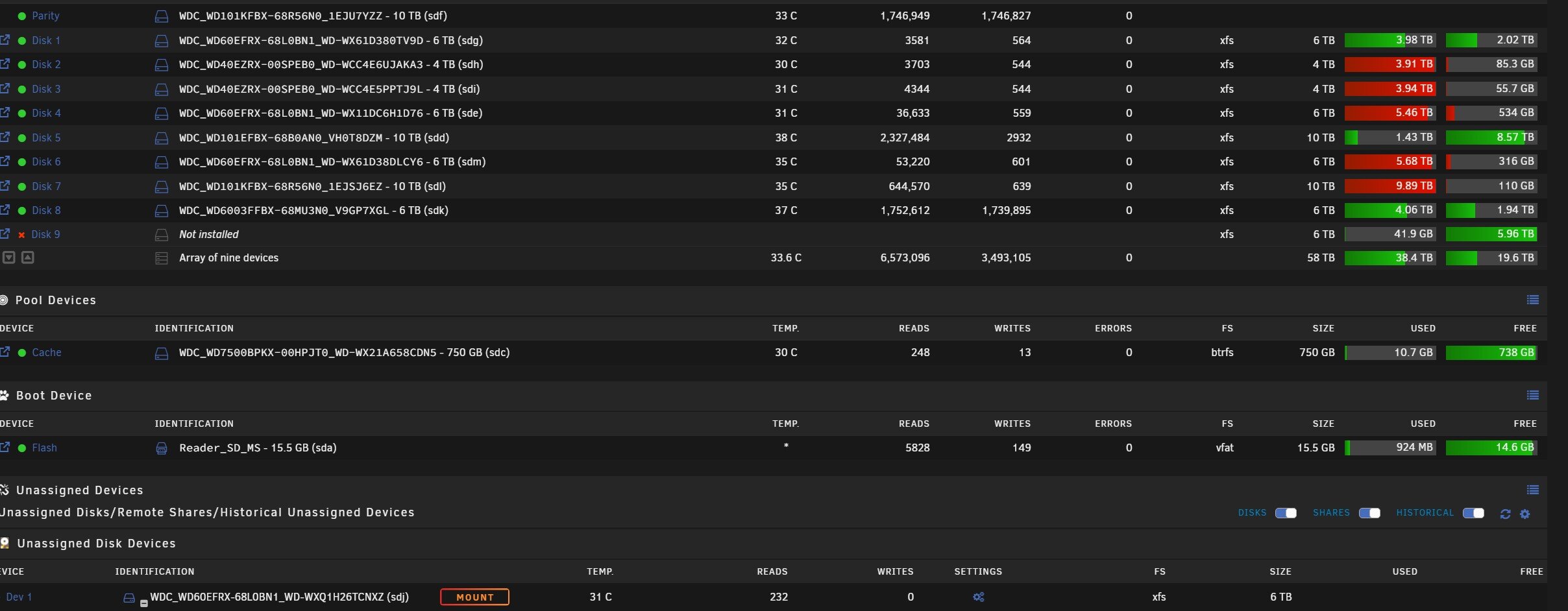

In the Disk 9 slot, as shown in the screen capture, sits the original Disk 5, it shown as NOT INSTALLED, it is also shown in unassigned disks  but is not mountable even though UR is offering to mount it. I have a new disk I wish to run from slot 9, but UR does not see it when I remove the current occupying disk.
Would a new configuration sort the issue ?  grateful for any advice.
Disk9 is not assigned, do you mean that disk5 is in the server's disk9 slot? That doesn't matter for Unraid.
Again, there's no disk assigned to disk9 slot, also note that the emulated disk9 is showing empty, so it will rebuild an empty disk.
