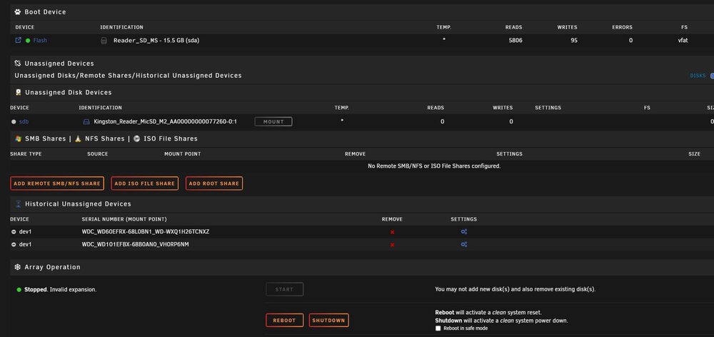

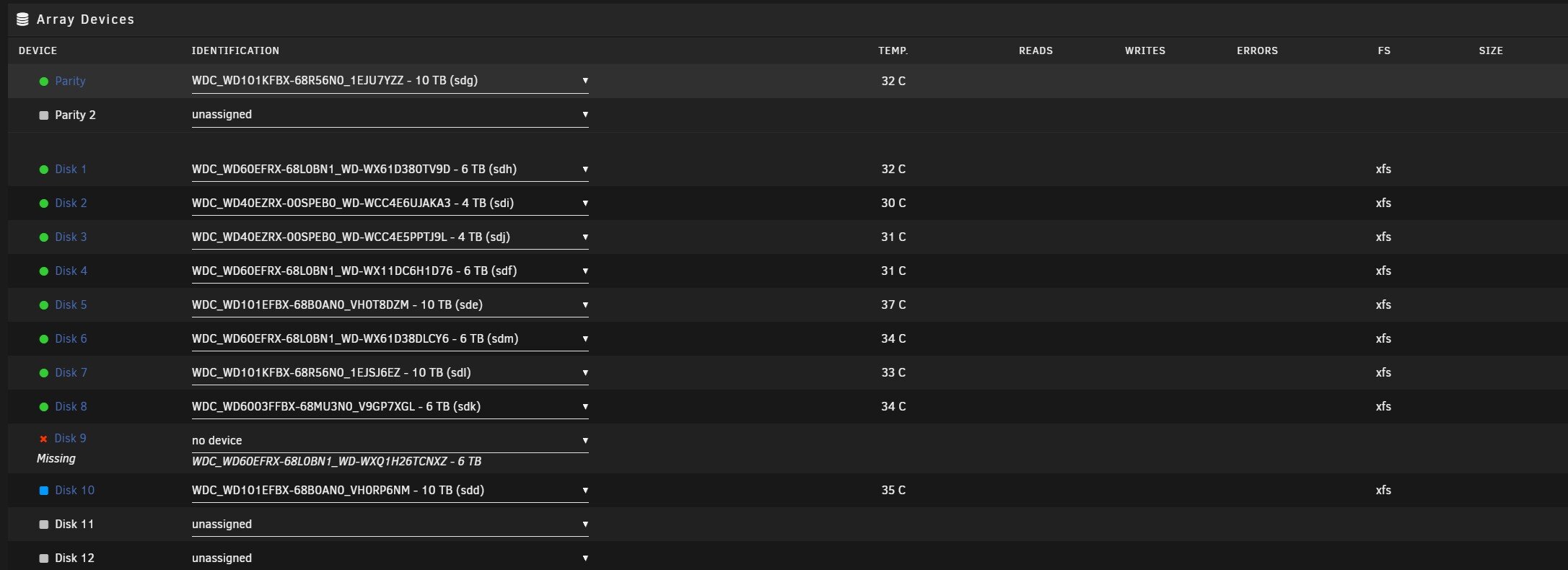

My apologies for that, it seems I now have an additional issue,  my array is stopped, with Invalid expansion
"You may not add new disk(s) and also remove existing disk(s)."
Having precleared the new 10tb drive and assigned it, I was thinking I could remove the drive with the corruption issues (the old Disk5) which was unassigned, this has apparantly caused the current issue.
I have attached two screen shots of the server interface. Grateful for your continued support.
You cannot rebuild and add new disks at the same time, finish the rebuild, then add a new disk.

I dont understand, I wasnt rebuilding at the same time, I had already rebuilt the disk and it mounted also, adding the new disk was after that. Currently I cant even re assign it either?

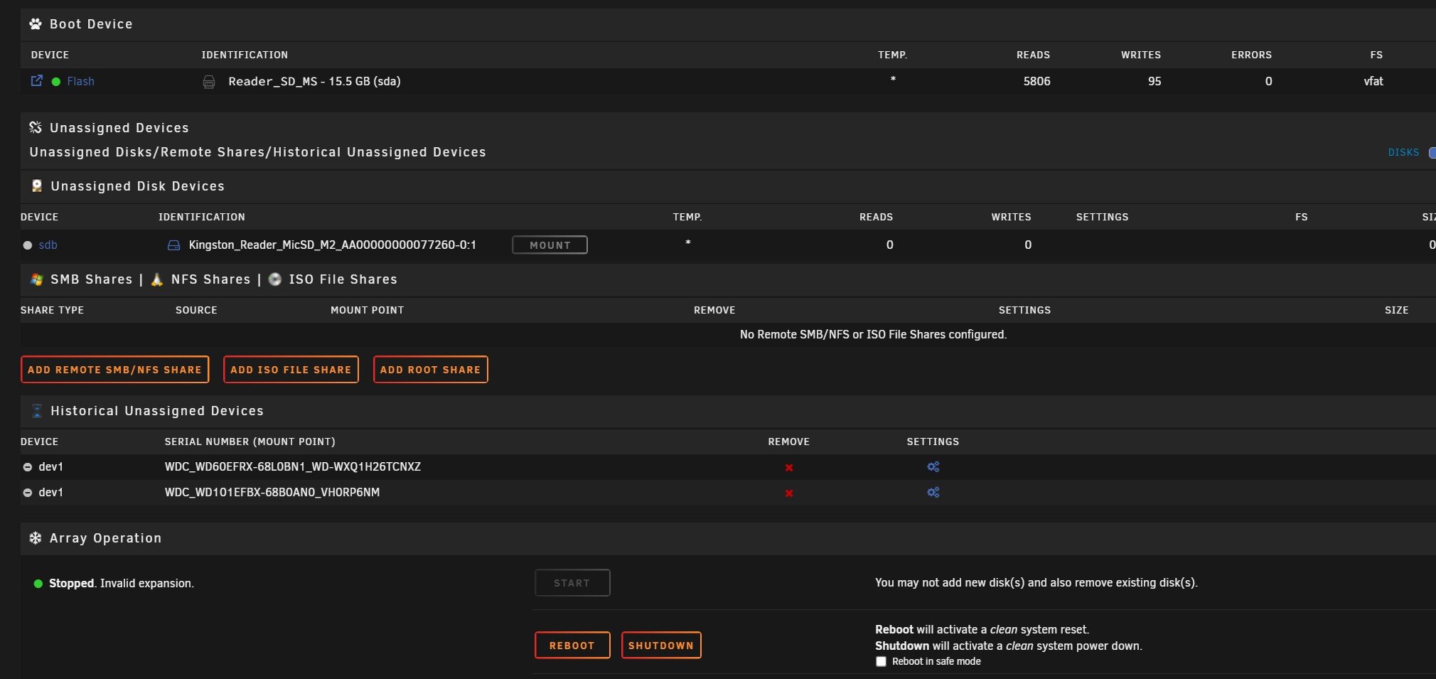

I have unassigned the new 10tb disk, and now have this option ....
"Start will disable the missing disk and then bring the array on-line. Install a replacement disk as soon as possible."....................I am assuming that means disable the old drive and not the new which is currently unassigned?
20 minutes ago, TopTrainer said:
I dont understand
Disk9 is disabled, you need to fix that before adding new disks.
