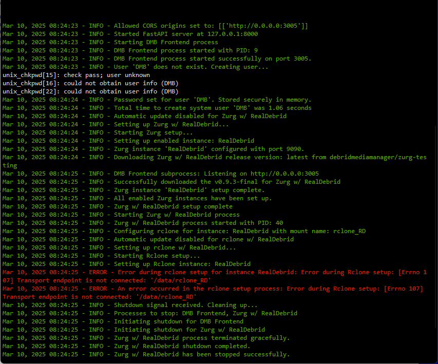

Hi... I ran into an issue. In trying to resolve the "Cross-site POST form submissions are forbidden" error, I removed the Docker to re-install.
The docker created a file-folder /mnt/user/DMB/dmb/zurg/mnt. After removing the DMB docker, I cannot erase this folder. At one time it contained a file $rclone_DB that I could not erase via the console or Windows. After several re-installs, the one file is no longer there, but I still cannot erase the folder.
I have tried re-installing the DMB container, but it quits right after starting up. This is the log:

Mar  9, 2025 12:25:31 - INFO - Allowed CORS origins set to: [['http://0.0.0.0:3005']]
Mar  9, 2025 12:25:31 - INFO - Started FastAPI server at 127.0.0.1:8000
Mar  9, 2025 12:25:31 - INFO - Starting DMB Frontend process
Mar  9, 2025 12:25:31 - INFO - DMB Frontend process started with PID: 9
Mar  9, 2025 12:25:31 - INFO - DMB Frontend process started successfully on port 3005.
Mar  9, 2025 12:25:31 - INFO - User 'DMB' does not exist. Creating user...
Mar  9, 2025 12:25:33 - INFO - Password set for user 'DMB'. Stored securely in memory.
Mar  9, 2025 12:25:33 - ERROR - Error changing ownership of '/data/rclone_RD': [Errno 107] Transport endpoint is not connected: '/data/rclone_RD'
Mar  9, 2025 12:25:33 - INFO - Total time to create system user 'DMB' was 1.53 seconds
Mar  9, 2025 12:25:33 - INFO - Automatic update disabled for Zurg w/ RealDebrid
Mar  9, 2025 12:25:33 - INFO - Setting up Zurg w/ RealDebrid...
Mar  9, 2025 12:25:33 - INFO - Starting Zurg setup...
Mar  9, 2025 12:25:33 - INFO - Setting up enabled instance: RealDebrid
Mar  9, 2025 12:25:33 - INFO - Shutdown signal received. Cleaning up...
Mar  9, 2025 12:25:33 - INFO - Processes to stop: DMB Frontend
Mar  9, 2025 12:25:33 - INFO - Initiating shutdown for DMB Frontend
Mar  9, 2025 12:25:33 - INFO - DMB Frontend process terminated gracefully.
Mar  9, 2025 12:25:33 - INFO - DMB Frontend shutdown completed.
Mar  9, 2025 12:25:33 - INFO - DMB Frontend has been stopped successfully.
Mar  9, 2025 12:25:38 - INFO - Shutdown complete.
Mar  9, 2025 12:45:44 - INFO -
I have tried several times with the same result. I have manually removed the docker and all created files and  folders in /appdata and the array. Except I cannot delete the one folder. Being that it is a share, I have tried deleting the share on the unRAID WebUI as well with no luck.
I don't know if it new install are failing because that one folder is existing. Here is my docker setup page for DMB.
Any help is greatly appreciated. Even if I cant get DMB to work, I would love to be able to delete the folder.
Thanks.
H.

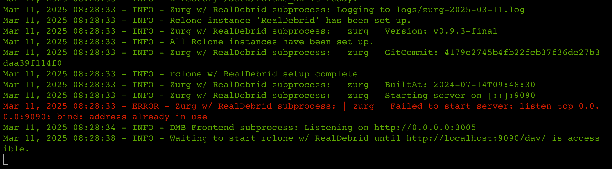

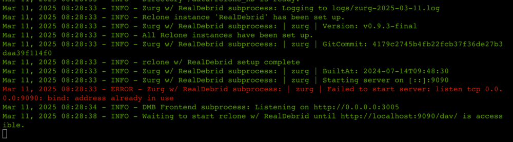

p.s. The latest re-install shows additional errors in red:

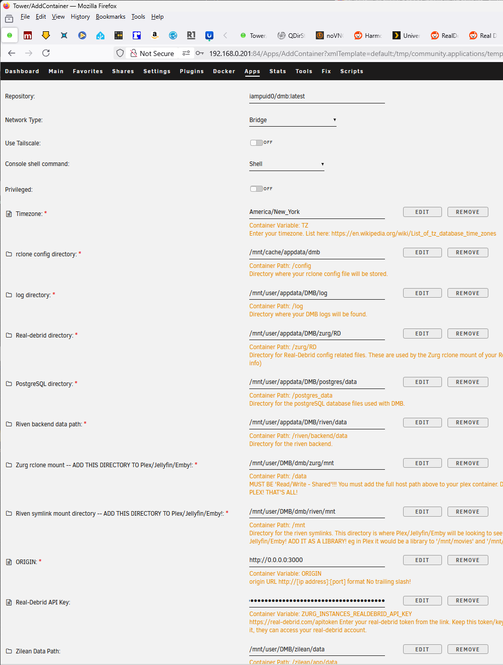

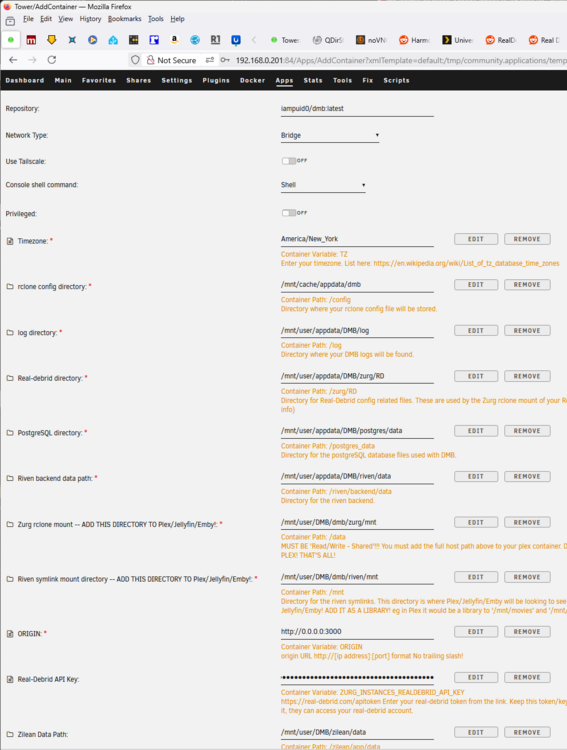

I have reinstalled DMB and I properly get the website… But I can’t save any settings as I get the “Cross posts are forbidden” error.
I am set to bridge mode. And Origin is set to http://192.168.0.201:3000, which is my server’s IP. I can get to the Riven ui.
i tried changing to host mode, and the log stays stuck at:
Any ideas?
Thank you.

Hello,
Just to start, zurg (which uses rclone) seems to be a bit finicky in unraid. By which I mean, if a container mounts a remote WebDAV, http, etc. share using rclone (as DMB does) unraid/rclone doesn't "like" for a bunch of stuff to happen to that mount. Examples of things that I've run into issues over the last couple years with are: trying to modify the contents manually, trying to rename the mounted directory, trying to change owner or permissions of the mounted directory, trying to delete the mounted directory. Probably some others as well. If it gets really "messed up" then you'll see issues such as you described where you straight up can't remove the mounted directory except by a restart (there are other ways, but for brevity sake here, stopping the array and/or restarting is one way. "Lazy unmount" is another you can lookup if curious-- although I BELIEVE unraid has implemented this into the OS now. I might be misremembering.) Long story short, try to absolutely never mess with an rclone mount in unraid. Or if you do, just be prepared to be forced to restart the server.

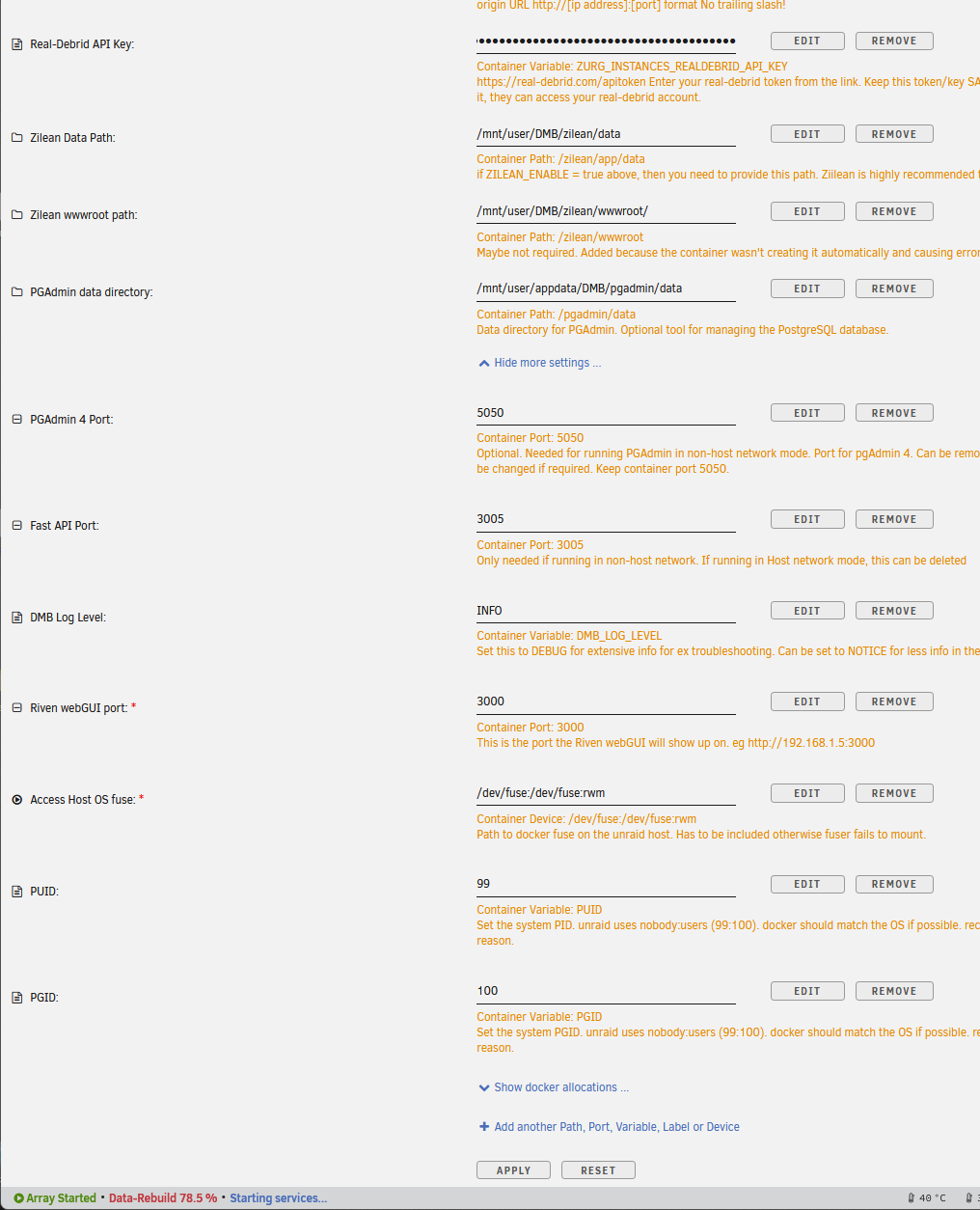

Regarding the cross post stuff, that's always been an origin issue in my experience. I haven't seen any errors like it in a while.
Are you using a reverse proxy (like NPM, etc.) by chance? That will cause the cross post error. If you are using a reverse proxy, you should enter your https domain instead of the IP. Example: https://dmb.example.com (your subdomain would be whatever you set it to and example.com would be your domain)
Besides the above scenario, I BELIEVE (and I haven't checked in many months) you can delete the origin variable and riven will still start as per normal. I think origin just sets the ONLY acceptable web address for saving to be done from. So it's less secure without that setup, but if it's local usage only... it's up to you of course but you could easily restrict access to the address anyway via firewall settings in your router and such. Or by assigning guests to a VLAN that is denied access.
Anyway, I suppose I can risk borking my setup and test that "for science." I'll edit in what happens.
Edit: Ok, good thing I did that!
First thing, the fix:
Delete or change the variable "ORIGIN" to "RIVEN_FRONTEND_ENV_ORIGIN"
Everything else remains the same. Enter your origin IP as you did before. Once the container restarts, it should work!
It's a mistake in the unraid template on my part. This was all updated in the last few days, so I expected a couple speed bumps. This was working previously for me, but now it wasn't after I changed my setup. Maybe I was inadvertently running a slightly older version of the docker image, who knows, anyway I will fix the unraid template.
Go ahead and change that variable and let me know if there's any further issues.

Fantastic.... it worked! Thank you.

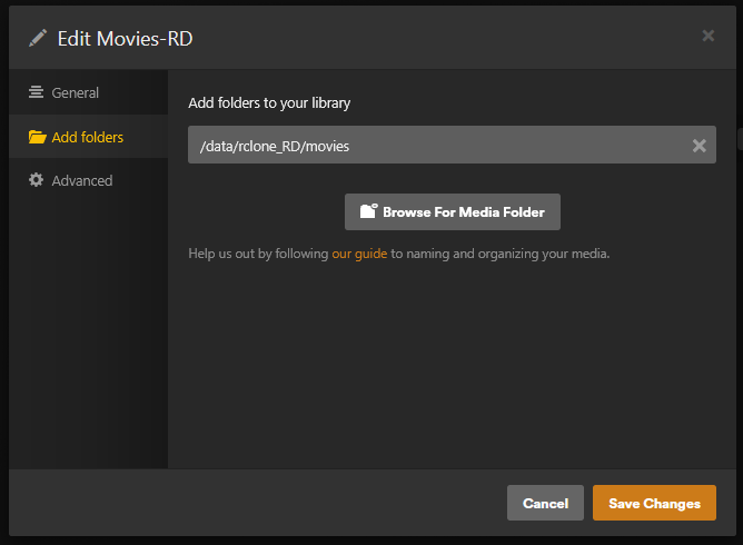

In Plex docker, I added this path:

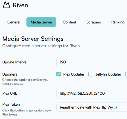

In Riven settings, I added my Plex Media Server:

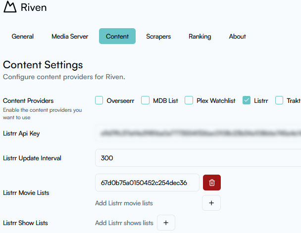

I went to the Listrr web site (https://listrr.pro) and created an account. Once in the account, I created my own list with the following criteria:
     - Movies between 1970 and 2032 w/ IMDB rating between 5.8 and 9.9.
I copied the list ID into Riven along with my Listrr API key
Don’t do this…. It will add all these movies to your Riven!

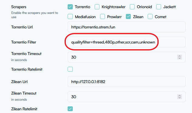

I went to Torrentio (https://torrentio.strem.fun/configure) and configured my preferences for language, qualities to omit. I also pasted my RD API key. I clicked on the "Install" button. I then pasted the text that was put in my clipboard into text editor (API changed).
Back in Riven > Scraper settings, I did the following (note the pasting on the quality filter section in the URL above. Note; I also clicked on Zilean and left the default values:

I went to my unRAID's folder - /mnt/user/DMB/dmb/zurg/mnt/rclone_RD/movies/ and sure enough the mkv file is in there.
In my Plex > Manage Libraries, I added a new "Movies" library which I names "Movies-RD", and pointed it to:
When I click on that new library, I see the one movie.... and it plays!

2 hours ago, hernandito said:
My Progress....
And finally, in Riven > Ranking settings: I checked these:
On Riven's main page, I searched for a specific movie. Then I asked it to Manually Scrape
It gave me a "Success" message...
I call this progress. Here are some questions and things I want:
1 ) An easy one, I need to figure out how to show this new library in my Plex Home UI... Or perhaps consolidate with my original Movies library.
2 ) Was the MKV I see in the folder above a fully 7 GB downloaded file that was stored there? Or is it a symlink / pointer?
3) Is there any other way to add content outside of Riven... like Overseer, or Petio? I want to allow some family member the ability to add stuff. Riven does not seem geared for user accounts.
I also have to look further as I do not recall seeing any options on which version of the one movie I picked to add.
I can perhaps continue editing this post and have it be a guide for the newbies like myself.
Thank you again for creating this and for your help.
H.
Reading through that quickly, it seems like everything is working correctly.
As far as your questions go:
1. I would personally recommend *not* combining your previous libraries with the Riven/DMB ones. Why? Because it gets confusing and will likely cause you issues at some point when you're trying to figure out "Ok, so is this media on my server or is it in the WebDAV?" You can do whatever you want, but I'm just speaking from experience. Having two libraries will avoid a headache. I believe you can have two (or more) libraries separated but also show up together. Like one local for movies, one remote for movies, then show as just "movies" but I have check on that.
As for getting the library to show up period, you just go into your Plex on each device (yes, it's a little annoying. the arrangement doesn't sync, but it also takes like 3 seconds to change). (In a desktop browser, but all devices are basically the same): Left side you should have a vertical list starting with "Home" then a list like Movies (or whatever) and ending with "More >". Click that "More >" and it will display a bunch of libraries you have access to. Ones you are hosting or ones friends invited you to, whatever. You hover the libraries you are interested in, you go to the right side of the library, you click the vertical 3 dots menu thing that shows up, you click "pin". Do this for each library you want to show up on the main page. You can unpin things you don't want. Click the "< Pinned" at the top to go back to the main section and that's it. They should be showing up now. You can rearrange the libraries if you want by clicking the 3 dots vertical menu on the main page and selecting reorder.
2. The .mkv file is not downloaded...necessarily The way it works is like any rclone mount (zurg is just rclone but specialized to stream from debrid sites. it's just rclone + "ideal settings"). It's like a network drive basically. All the stuff you have added to your RD WebDAV shows up in your WebDAV. rclone provides a way of "mounting" this as a drive. The OS effectively just sees another drive. Again, similar to mapping network drives with samb, ftp, etc. When you play that media in Plex it's just streaming (downloading temporarily) the file. RD has very good servers that can put out high enough upload speeds to maintain 4K media bluray quality (so better than like Hulu, Disney, etc. usually output). Even 4K remux files that can run to like 100GB+/movie if you really hate your ISP. rclone is basically able to create the appearance of a real disk existing locally so Plex scans the files as if they are local.
3. You can use Overseerr. You just have to set up the container and add the required stuff (API key and whatever else). I use trakt, although the dev(s?) recently made some API changes to trakt making the free version less desirable. I've been paying for it, but the limits on the free version seem annoying. You can also setup Riven to grab from your Plex watchlists. This requires the "Plex pass" (I'm pretty sure? I don't keep up to date on the little tweaks this companies make, so you gotta check stuff on your own). I bought the lifetime thing from Plex like... 15 years ago almost, so, again I haven't kept up on what they limit or don't limit. If you can use it for free users though, or do choose to pay for the pass version, that's a good option. You just watchlist something in Plex and riven grabs it and adds it.
Overseerr is probably "the best" fully free media request software in that list.
I've never used listrr or MDB, so I can't even speak on them at all.
4. For rankings (choosing different resolutions like 2160p then 1080p then 720p... etc.) this website has a lot of info: https://dreulavelle.github.io/rank-torrent-name/users/faq/
You should be able to go under Settings -> Ranking and change the settings right there in the UI (it used to be all in a .json, but it seems the dev added the option to edit it right in the UI! Very nice.) I haven't messed with mine very much, but I set it to "best" and then selected 2160p, 1080p and I think the rest is set to default, but not sure. If everything is default riven grabs 1080p relatively small file sizes like 2GB. Just be careful with ranking to not be overly specific or require things that can't be met otherwise might end up with issues grabbing media.
Remember that the newest fastapi branch added the ability to individually control the elements in DMB. Go to http://(your-ip):3005 to see that stuff. You can restart the frontend, edit the jsons, things like that right from there. A lot of this is experimental, and honestly it's built to not need much tweaking, but you can do so there if you wish. Check the GitHub for definitions and explains of variables. https://github.com/I-am-PUID-0/DMB

one question, in Riven, the Plex scan interval is set to 120. However I think things will only show up if I manually scan the library. It would be nice if stuff shows up in Plex right away. I will investigate further. But any tips?

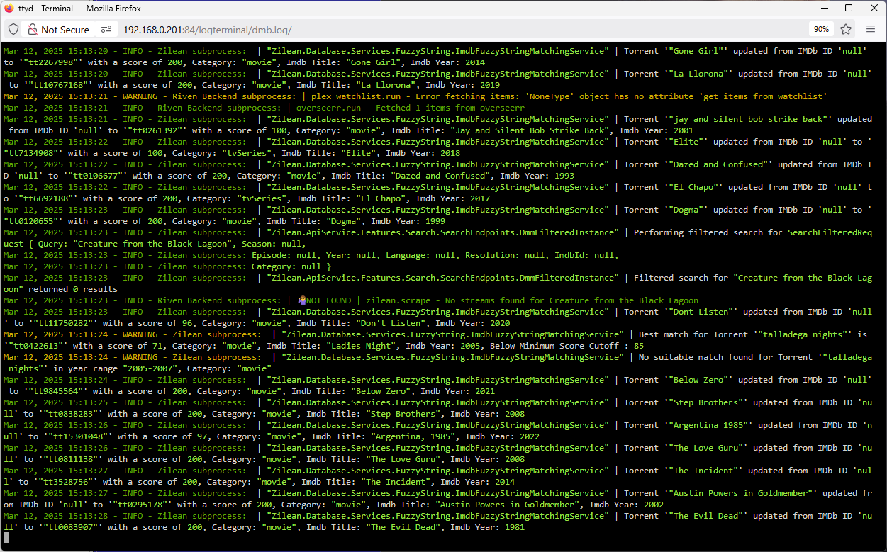

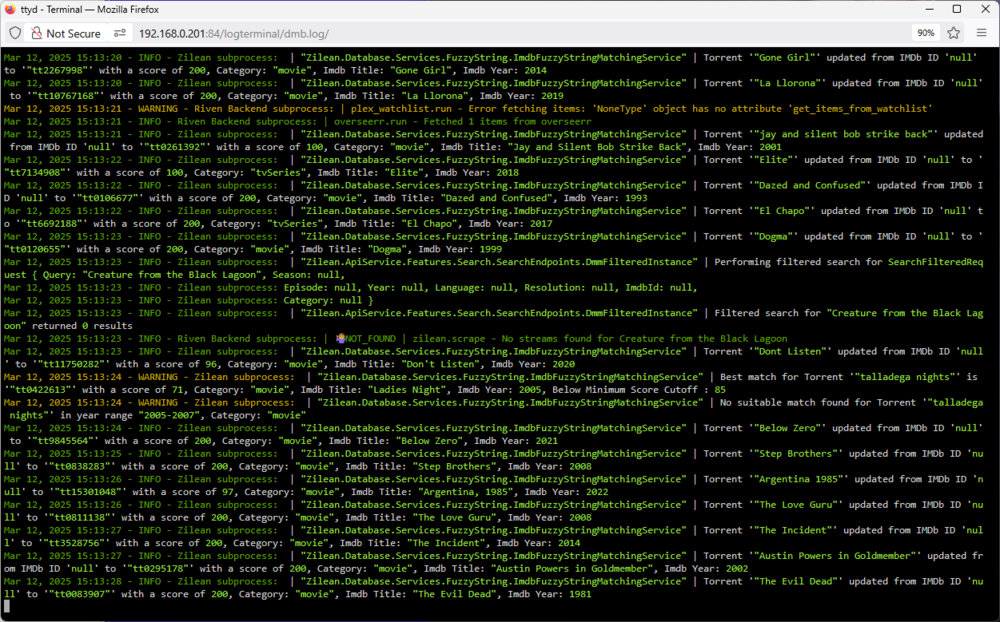

I'm baffled by this:
DMB is searching for all these movies I have NOT requested. Earlier, because of the Listrr setting in Riven, It was adding all the movies in the list I found. To remedy, I deleted the DMB docker and all the folders it created. Then I did a clean fresh install of DMB. I did NOT add the Listerr option. I only checked on Overseer as Content source. In Overseer, my request list is empty/clear. I had hoped this captured my requests in Overseer.
Why are these files being scanned. They do not land in my Real-Debrid torrent list and are not symlinked/mounted to the rclone folder. It seems like it's scanning movies in Spanish.
Thanks.
ps.... Riven did capture a movie in my Overseer list...! YAY...!  But I still don't know why it is scanning all those files.
Thanks.
That looks like the normal Zilean initial setup. It has to grab all the "known good sources" from debridmediamanager (DMM) website. It's just a curated list of media torrents that are already cached on RD's servers. It usually takes like 1-2hrs on a first install for Zilean to update. You don't HAVE to use Zilean btw, but I'd highly suggest it. Torrentio works well too though if you are really opposed to zilean.

Hello. I’m having an issue with my dmb container. It’s been running fine for over a year but now I’m getting Postgres errors. I believe it’s permissions issue but each time I try to change it on the host it’ll revert when dmb is booted. I don’t really want to reinstall dmb unless there is a way to restore my symlinks.
I've had DMB installed for months and it seems to be working just fine.

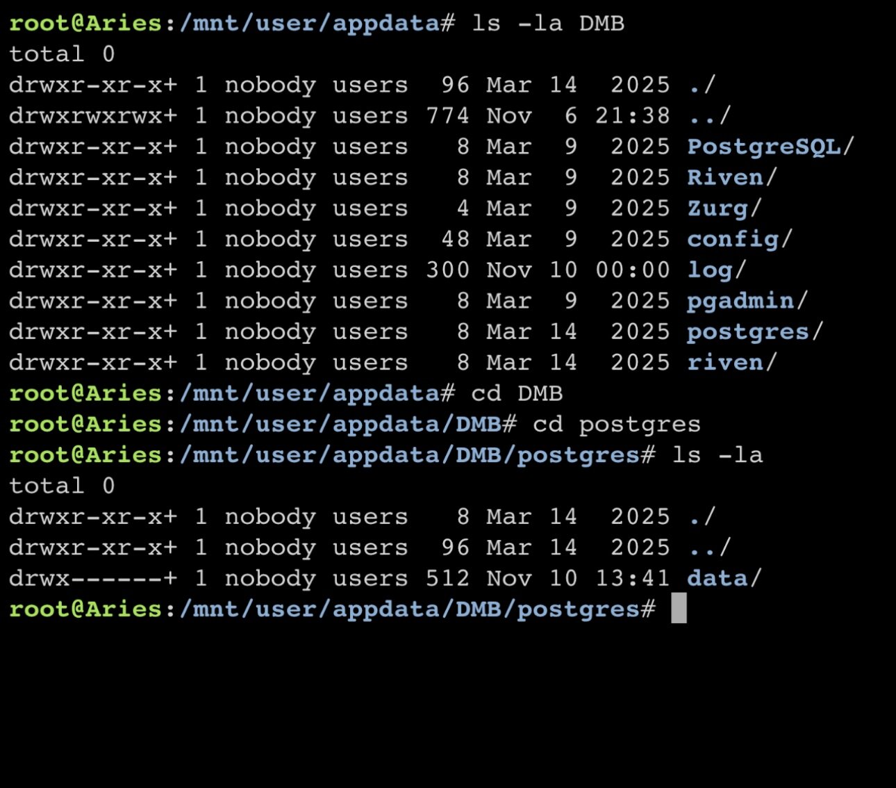

I've changed the owner directory settings as documented.
The riven and zurg directories in /mnt/user/DMB/dmb are populated with movies and shows symlinks.
DMB Dashboard loads properly. All the running configs code displays properly - I'm not sure I'm supposed to make any changes in the code, but when I've tried experimentally, any edits are not saved.
In Riven, when I try to save settings, I see this message:
I access Riven at http://192.168.1.241:3066
I've changed from the default port 3000 because NPM uses port 3000 already.
I'm pretty sure the Cross-site POST error is new because in the past I was able to set up Riven properly.
I am able to request media in Riven successfully.
No reverse proxies in my setup. It's just me accessing DMB/Riven locally.
Here's my docker run:
docker run
-d
--name='dmb'
--net='bridge'
--pids-limit 2048
-e TZ="America/New_York"
-e HOST_OS="Unraid"
-e HOST_HOSTNAME="redacted"
-e HOST_CONTAINERNAME="dmb"
-e 'TZ'='America/New_York'
-e 'RIVEN_FRONTEND_ENV_ORIGIN'='http://192.168.1.241:3066'
-e 'ZURG_INSTANCES_REALDEBRID_API_KEY'='redacted'
-e 'DMB_LOG_LEVEL'='INFO'
-e 'PUID'='99'
-e 'PGID'='100'
-l net.unraid.docker.webui='http://[IP]:[PORT:3066]'
-l net.unraid.docker.icon='https://github.com/I-am-PUID-0/DMB/assets/36779668/d0cbc785-2e09-41da-b226-924fdfcc1f21?raw=1'
-p '5050:5050/tcp'
-p '3005:3005/tcp'
-p '3066:3000/tcp'
-v '/mnt/user/appdata/dmb':'/config':'rw'
-v '/mnt/user/appdata/DMB/log':'/log':'rw'
-v '/mnt/user/appdata/DMB/zurg/RD':'/zurg/RD':'rw'
-v '/mnt/user/appdata/DMB/postgres/data':'/postgres_data':'rw'
-v '/mnt/user/appdata/DMB/riven/data':'/riven/backend/data':'rw'
-v '/mnt/user/DMB/dmb/zurg/mnt':'/data':'rw,shared'
-v '/mnt/user/DMB/dmb/riven/mnt':'/mnt':'rw'
-v '/mnt/user/DMB/zilean/data':'/zilean/app/data':'rw'
-v '/mnt/user/DMB/zilean/wwwroot/':'/zilean/wwwroot':'rw'
-v '/mnt/user/appdata/DMB/pgadmin/data':'/pgadmin/data':'rw'
--device='/dev/fuse:/dev/fuse:rwm'
--shm-size=128MB
-it
--cap-add SYS_ADMIN
--security-opt apparmor:unconfined
--restart=unless-stopped
--restart=on-failure 'iampuid0/dmb:latest'
Can anyone see if I'm doing something wrong, or point me in the right direction to solve the Cross-site POST error?

I'll just be 100% here: I haven't used riven for a while. Over six months if not longer. I've been using decypharr and I've been running DUMB (with plex built in. Seems to work a lot better for me). All that to say, as far as I know the origin issues were related to the IP and/or domain needing to be the same as the host ie the same as your unraid server's local IP. If that IP you posted is the same as the host then... I don't know what the issue is. Maybe it is something related to the port change. I don't remember if riven was super annoying with the port or not. I seem to recall having issues with it myself but that was a while ago and I can't say for certain.
I need to go through at some point and "clean up" the xml in any case. At least bring it into something close to a mirror state with the DUMB template. I also need to add some directories, and probably remove some others, to reflect recent additions during updates. I just sort of update my own personal template as time goes on.
On the newest DUMB builds I have noticed I no longer need to mess with permissions which is amazing. I don't know if that's a result of using decypharr as well though (vs cli_debrid or riven). In any case it has eliminated many headaches on that end.
So I'll go through at some point and clean up dmb. I can try using a different port too just for testing.
As far as changing config stuff, it depends what you mean I guess. You mean in the DMB frontend? You can go into services and makes changes. You can also change the files directly, but you have to be careful of syntax. Some changes won't save either unless you aren't running the docker container when they're made. It depends what exactly you're trying to change and how
