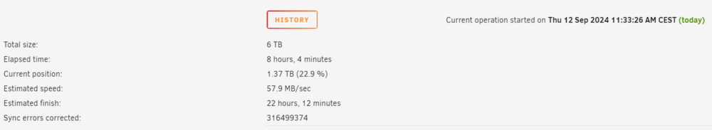

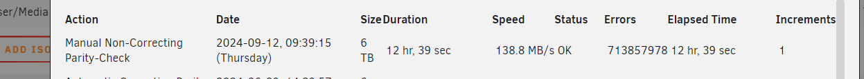

i have a lot of parity sync errors for months now after removing my hbacard and using my motherboard sata ports. i run parity sync first with out Correcting Parity Check On with a lot of errors after its was finished and now its running with Correcting Parity Check On but still having ther errors ( its still running )
i did change twice the sata cables but it has no effect.parity.thumb.png.1c3327de6293fcd8e79de4dac5f95166.png
parity check done without Correcting Parity Check On
what can i do ? or should i rebuild the parity with new config?

If the first check was not correct, the 2nd one will find the same errors, run another one after the correcting check finishes.

It should be irrelevant because after running a correcting check the next one should show 0 errors if you have no underlying problem.   My recommendation would be to always use a non-correcting check unless you expect there to be errors that need correcting.
