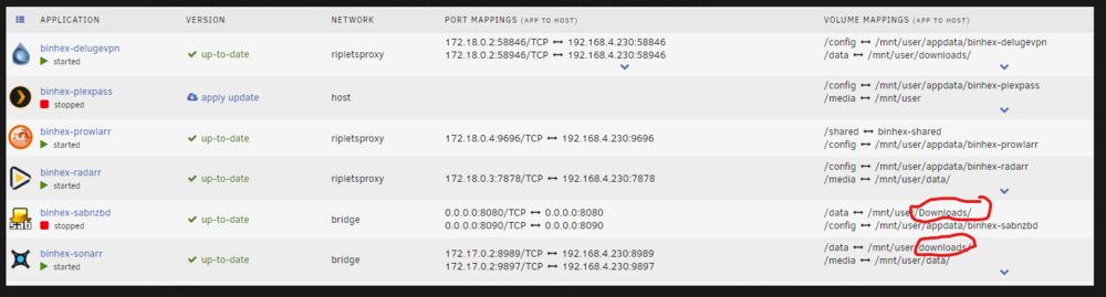

September 12, 20242 yr Hi, I think I have confused myself by watching too many TRaSH videos, and reading other information across the web so I figured I would come here for help. My folder structure is what Trash guides recommends. 1. Below are what I have configured, does this look correct? Deluge VPN Docker: Path: /data: /mnt/user/downloads/ Inside Deluge app: Download to: /data/incomplete Move completed to: /data/completed Extractor: Extract data to: /data/torrents/unzipped Radarr: Path: /media: /mnt/user/data/ Path: /data: /mnt/user/downloads/ Sonarr Container path: /data: /mnt/user/downloads/ Container path: /media: /mnt/user/data/ I get the following error inside of Radarr: "You are using docker; download client Deluge places downloads in /data/torrents/tv but this directory does not appear to exist inside the container. Review your remote path mappings and container volume settings." How do I resolve this? I thought my data was mapped correctly, but this is where I am confused. 2. I configured Prowlarr, and added both Radar and Sonar to it successfully. How does this work now? Do I search within Prowlarr, or Radarr/Sonarr? Both Radarr/Sonarr are giving me these errors: - No indexers available with Automatic Search enabled, Radarr will not provide any automatic search results - No indexers available with RSS sync enabled, Radarr will not grab new releases automatically I thought Prowlarr centralized the trackers, but how does Prowlarr interact with Radarr/Sonarr? I have more questions, but will start with these, and move on from there. Thanks! Matt

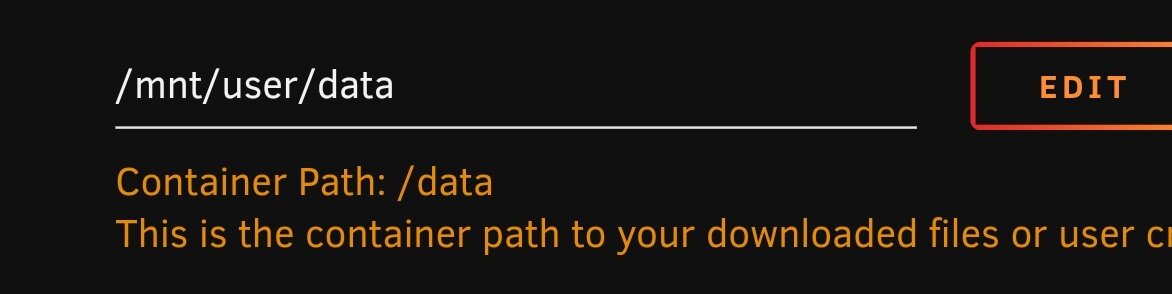

January 3, 20251 yr Aye with the container change recently, no longer do you want /data (container path) to map to /data/torrents It's best to just do a 1:1 aka /data (container) to /data otherwise you start running across all sorts of mapping issues (at least I've found)

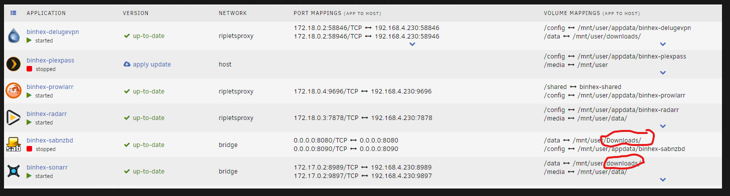

January 3, 20251 yr Community Expert Let me point out one thing. Look at the screenshot below: To Linux, these are two different directories as Linux is case-sensitive! If you intended these to be a single directory, copy the files from the unwanted one to the desired one. Then delete the unwanted directory. (Window is not case sensitive and will display only one of these two directories. Which one to be displayed seems to the one that is found first as the file structure is scanned...)
