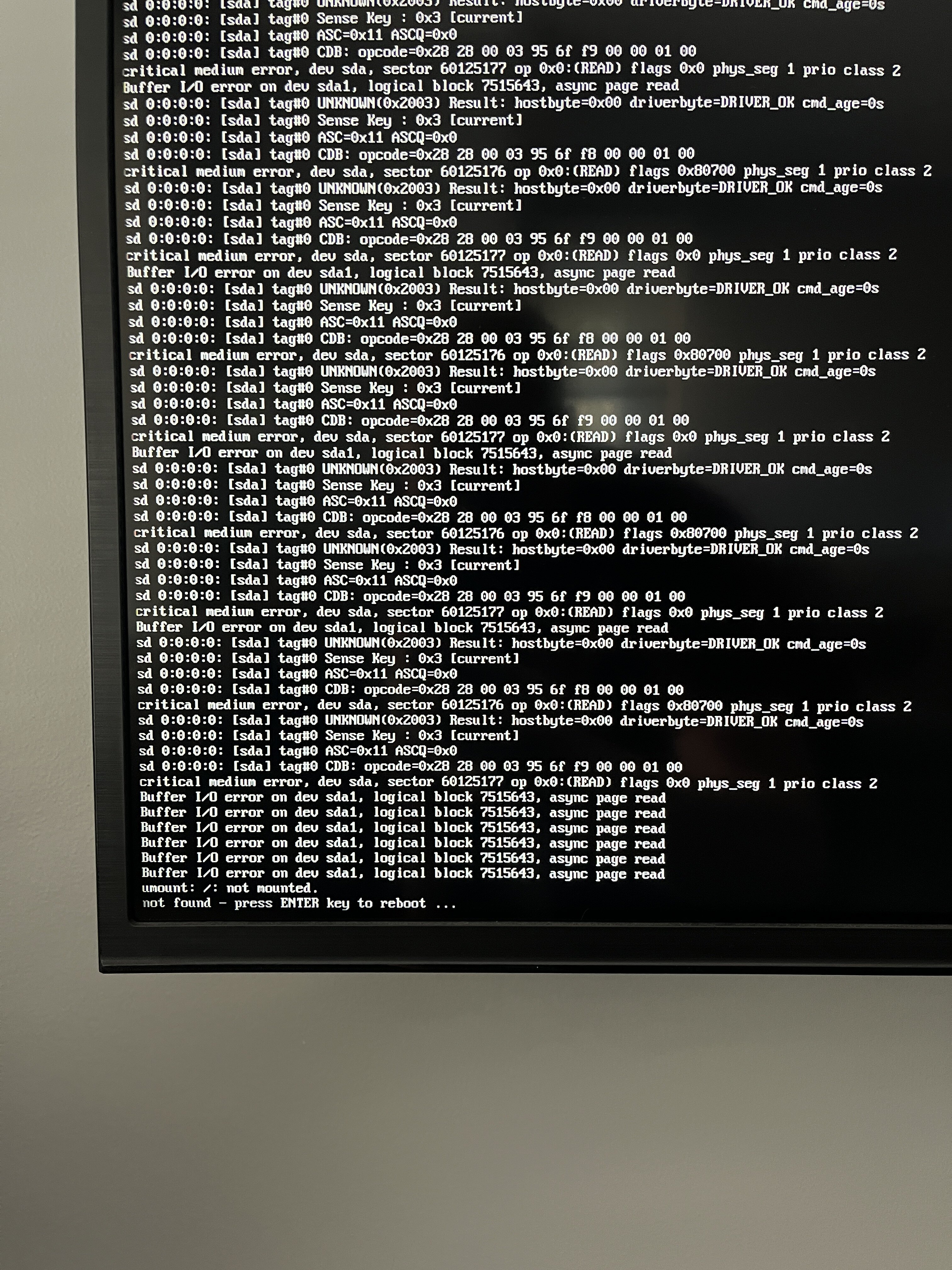

I can only get Unraid to boot (somewhat) properly if I completely shut down the PC, then power on and boot. If any restarts or bios changes occur unraid just won't boot at all or give me the error in photo 1. If I am able to get unraid to boot, the web interface doesn't load, either on my laptop or locally. The terminal seems to work locally though. I have booted in safe mode to ensure its not a plugin causing the issue. I also don't have a backup of the flash drive..

Your screenshot indicates a problem reading the flash drive so maybe changing that would resolve the issue.
What is strange is that you indicate that this does not happen when you power cycle the server..
Boot from USB2 port

The problem with changing the usb drive is I don’t have a backup of the usb. And it’s not readable when in another PC.
yeah it’s weird, if I do a full boot from power off, I can get into unraid locally, but not from a browser. But if I then restart the server I get the USB error. It’s super inconsistent. If I’m able to backup the flash drive through the terminal I could then use a new flash drive
