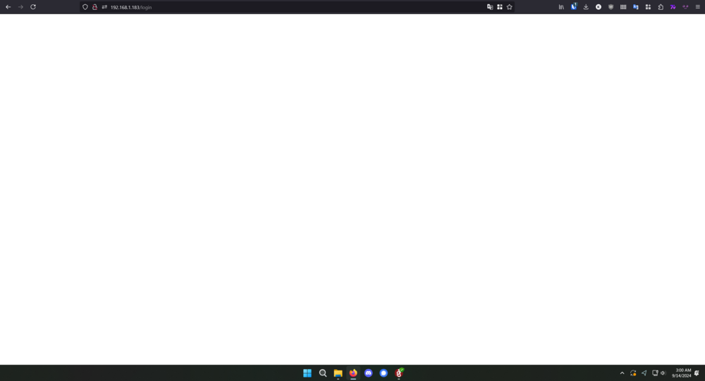

September 14, 20242 yr So I recently updated to 6.12 from 6.11 and had to redo some of my theming through the theme engine plugin. As I was messing around with it and reinstalling it a few times to set things back to default, my dashboard refreshed and all I get is a blank page. The screenshot is in Firefox, but If I try in to go to UnRaid in edge, it just gives me a 500 error. All dockers still work, the system reboots fine, and I can still SSH into it without an issue, but I still get a blank page. I have tried safe mode GUI boot without any luck, and have tried removing the theme engine plugin from the flash drive. Unfortunately I am away from my server for a couple weeks and have been remoting in via Wireguard, so I do not have physical access to the server, but I was able to grab a flash backup from Unraid Connect from before this happened but after I upgraded. My main question is if anyone knows what might have caused this, and secondly whether it sounds possible to do any of the following to possibly fix things while I'm gone: 1) swap the config folder on the flash drive with the one from the flash backup 2) copy the entire backup to the flash drive (to rule out corrupted system files) 3) use the "Previous" folder and manually downgrade back to 6.11 + use my config folder Since I'd be doing this remotely, I know there's a chance the system doesn't boot and then I'm out of luck, but worst case scenario I have to rebuild my USB with a fresh install + my backed up config folder once I have physical access again. I just wanted an opinion on whether trying this remotely sounds like a plausible idea or if someone had any other ideas. Edited September 14, 20242 yr by weepwhoop
