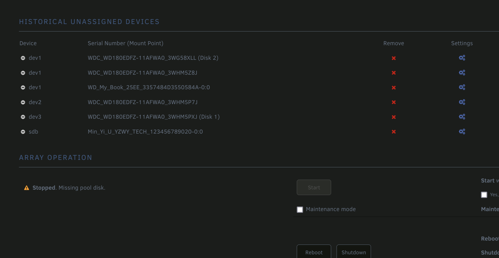

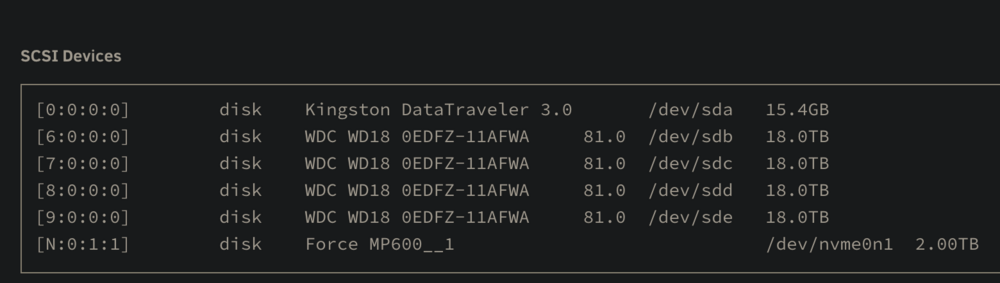

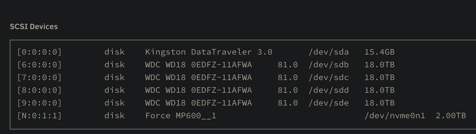

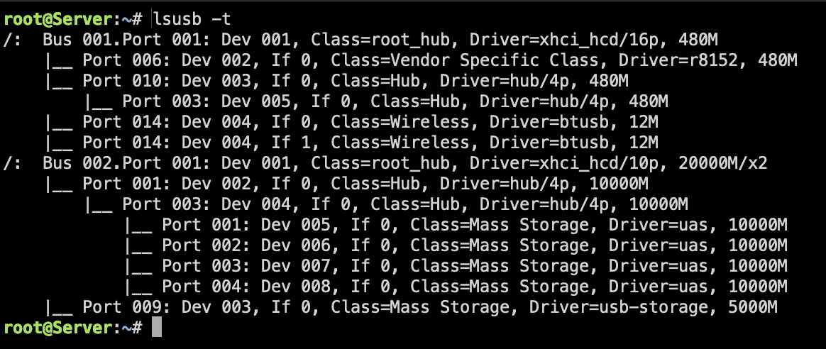

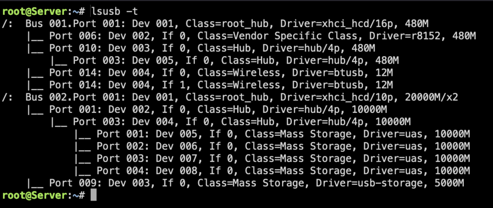

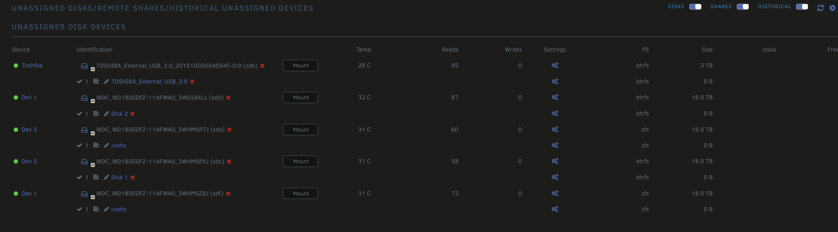

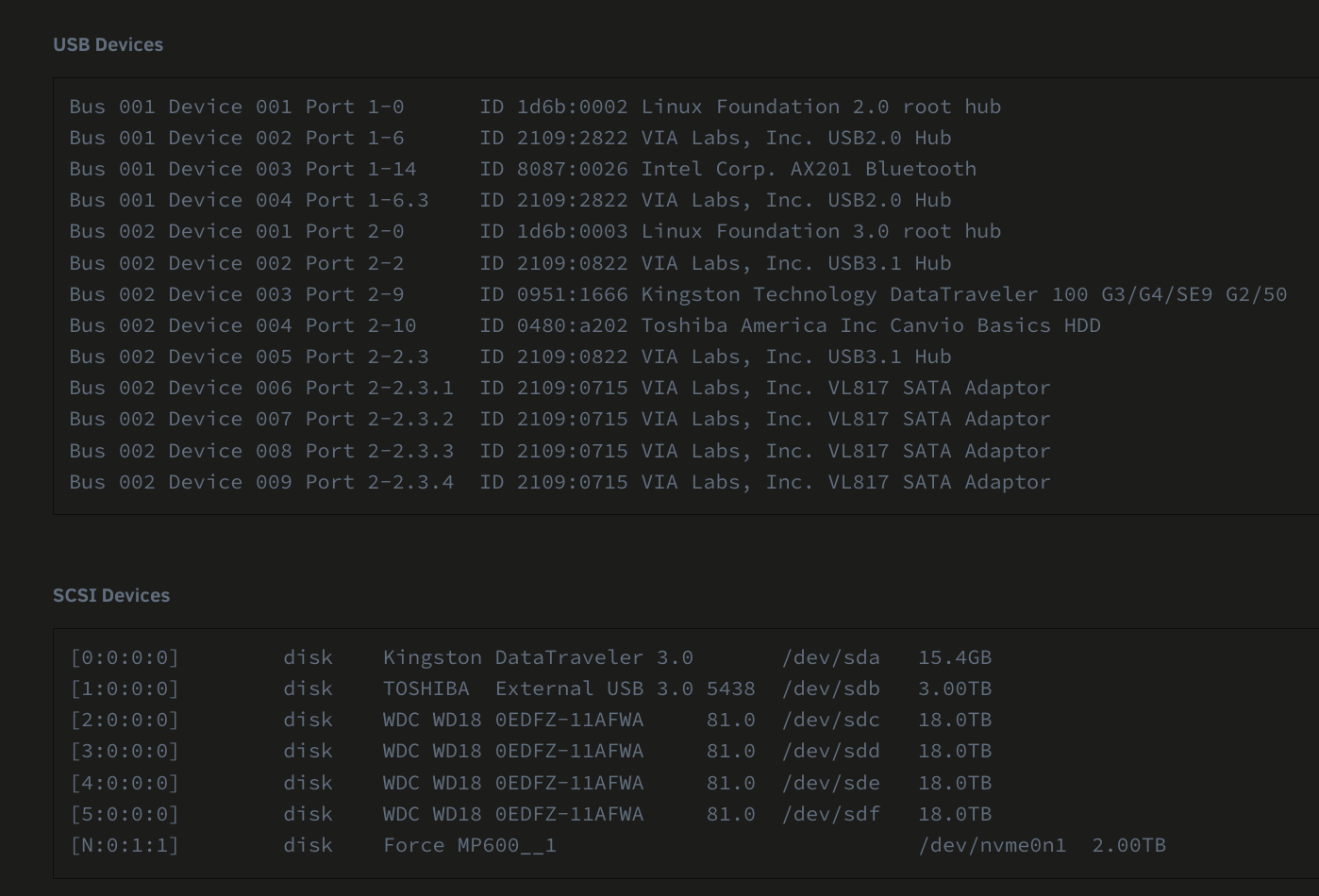

I seem to face two issues : one is the disks not being displayed individually on unraid. I see only one disk no matter what.

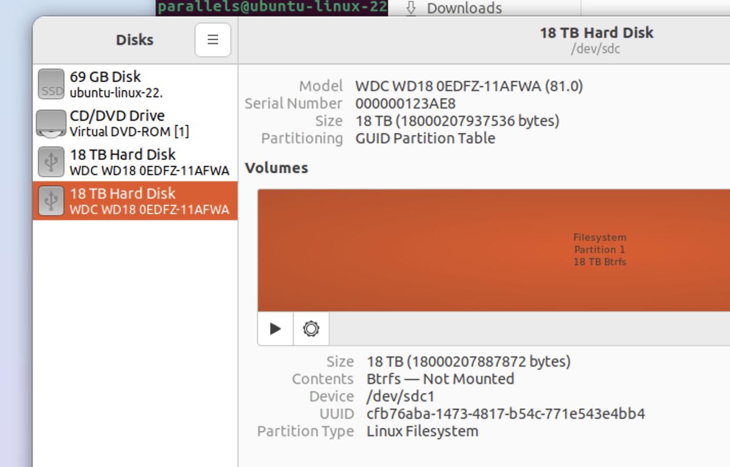

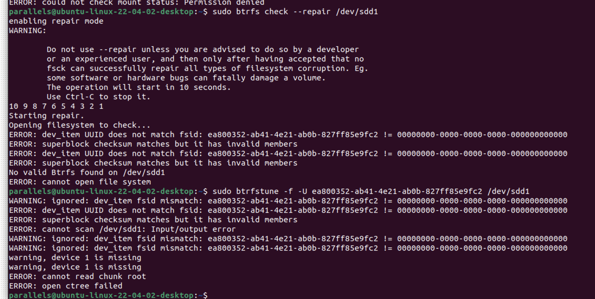

The second issue, is my BTRFS pool being broken, probably because I now don't use the SATA to USB adapters that were with those external drives.
On Ubuntu, it seems that XFS drives works OK, but unraid still don't see them individually.
If the issue with the BTRFS pool isn't solvable easily, I could totally use the USB to SATA adapters and transfer the data to other drives.
However, it doesn't solve the issues with all drives being seen as one.
On the other hand, Ubuntu sees 4 drives...
I'll appreciate if you can help me solve these issues.

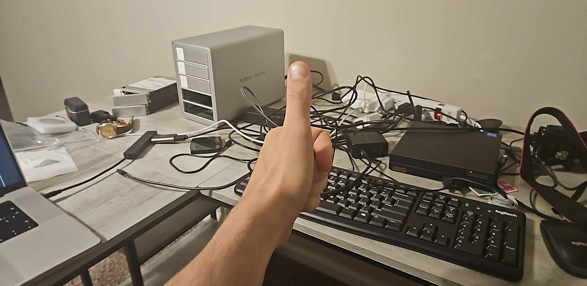

I bought the new Orico 99 Series DAS as I found it at an amazing price on Ebay (135$).
This enclosure is equiped with a Usb 3.2 gen 2 10gbits (1.25GB/s) USB interface that even offers to be daisy chained. Great !
Since those drives can push up to 220MB/s and 180MB/s continuous, it seems like a good way to avoid any kind of throttling due to USB 3.0 (700MB/s) max speed. I also wanted to see if those newer USB chipsets can be used reliably with unraid, which would be awesome.
I was also able to... save some space in my bags while moving in the US for work :) !
I just chucked the hard drives and installed them in the DAS.

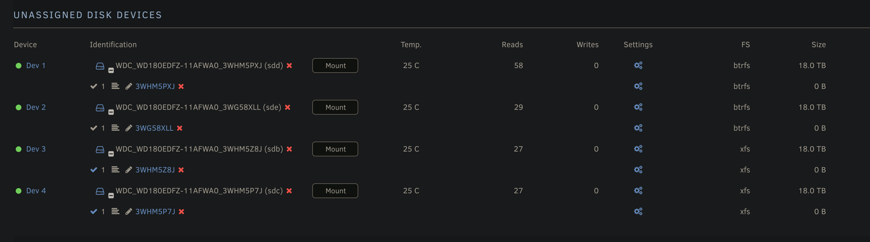

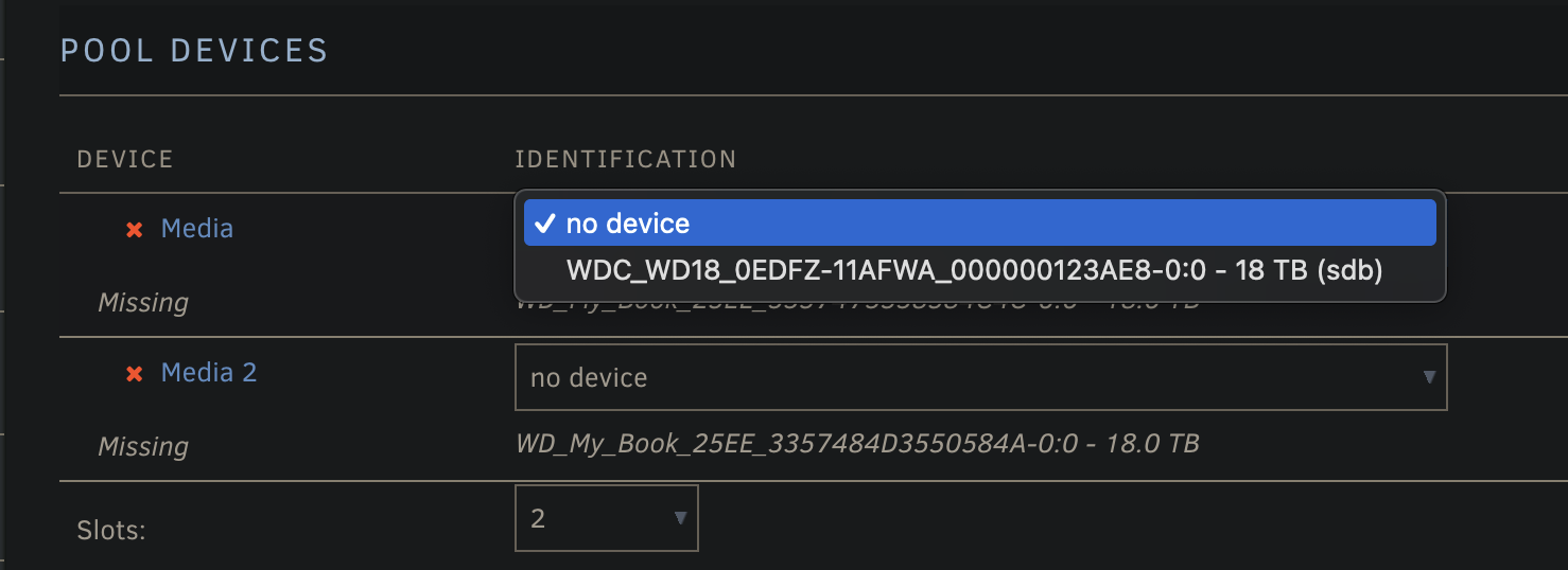

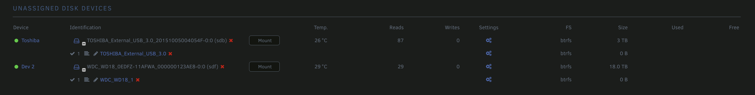

The issue I have now have is Unraid seeing only one drive out of the 4 drives :
I tried pulling out drives one by one.
What I observed is that no matter which drive is plugged, I always see that exact serial number and Unraid only sees one drive.
Maybe the USB controller doesn't expose the disks properly so Unraid only sees the same duplicated part of the serial number.
2 of the drives were XFS and previously used as the main array, but these has been discarded and unused since months.
The 2 drives I would like to work, are BTRFS and were used in the MEDIA array, these somehow can however not be mounted.
There was no raid, it was just two drives making up a 36TB pool.
I'm guessing they were using the MIXED profile.

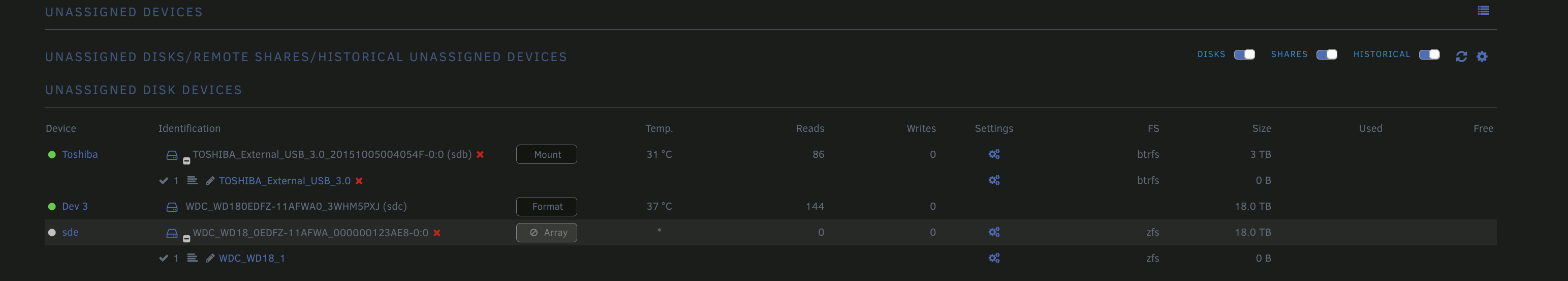

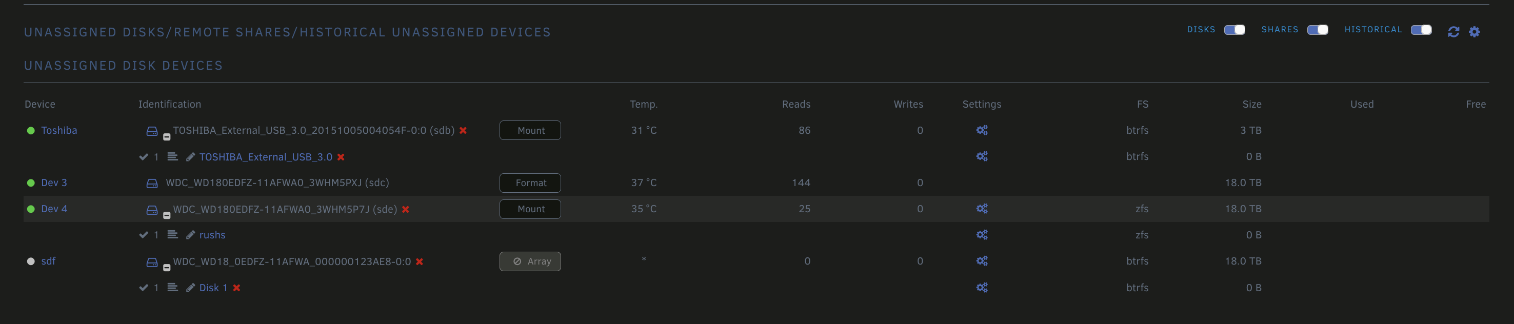

I also have a SATA to USB adapter, and would love to try it out to see if the drive is always labelled with the same UUID.
I will need to get a 12VDC PSU at work to power it. I will do that monday's evening.
If the disks aren't labeled the same, then it could be a firmware bug from Orico.
But right now I'm guessing that it's due to the fact that I got rid of those SATA to USB adapters that were with the original drive from WD.
Will update the post with the info on monday.
Here's what I have been trying :

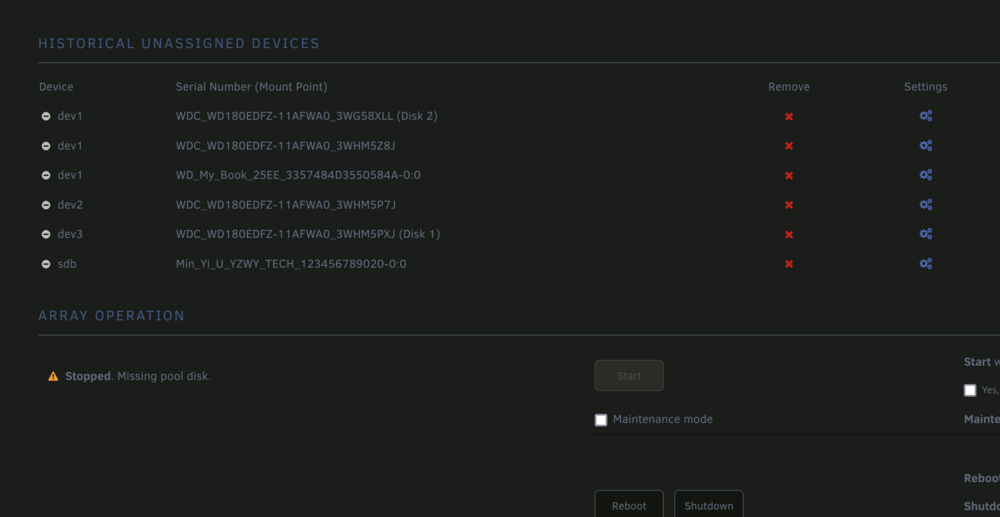

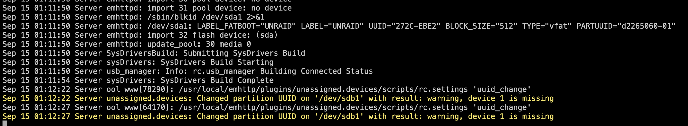

So I tried changing UUID with the Unassigned Disks Pluggin.
Wasn't working. In the log I could see :
I checked on the main page and the disk currently inserted was indeed sdb1.

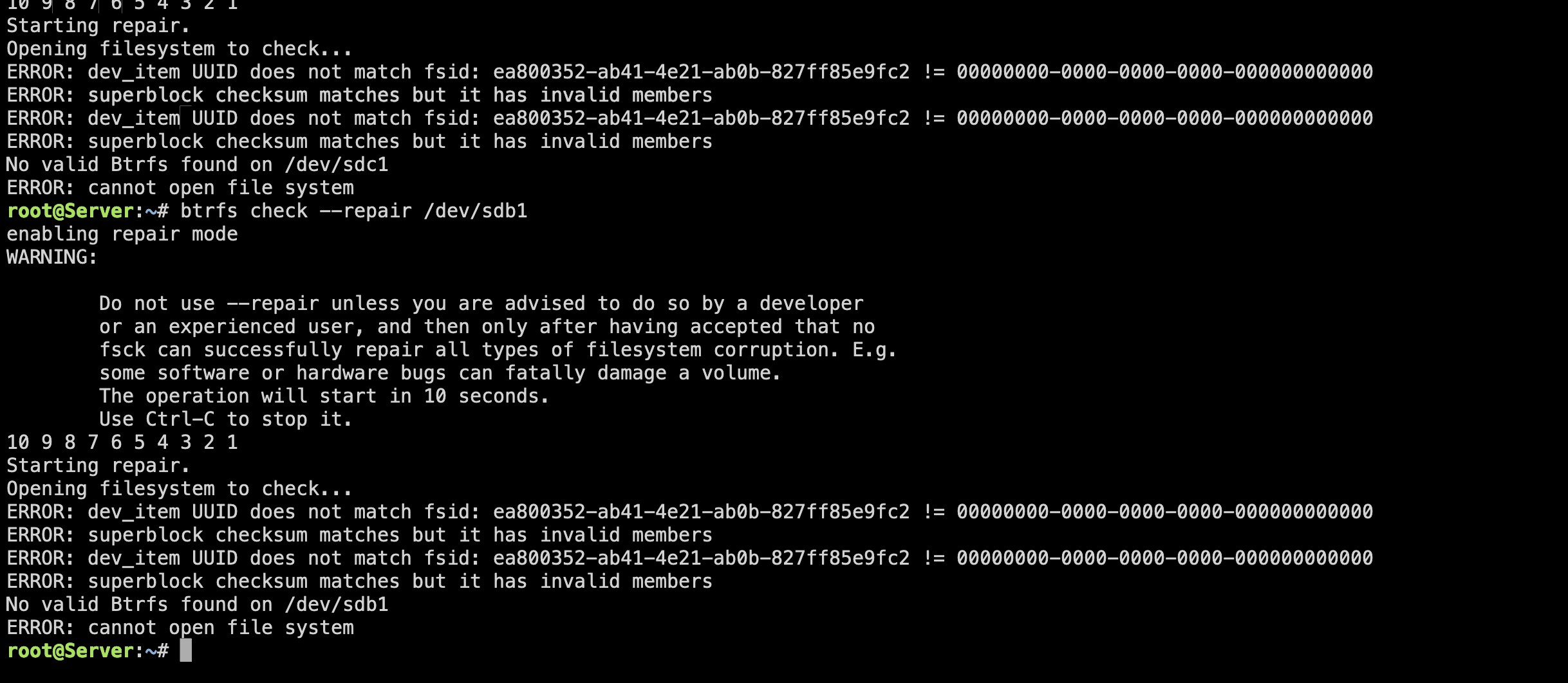

So I tried mounting the disks manually and I got :
I'll go on and try to repair this BTRFS file system. I'll update this post with how things are going.
sudo mount -t btrfs /dev/sda1 /mnt/disks/WDC_WD18

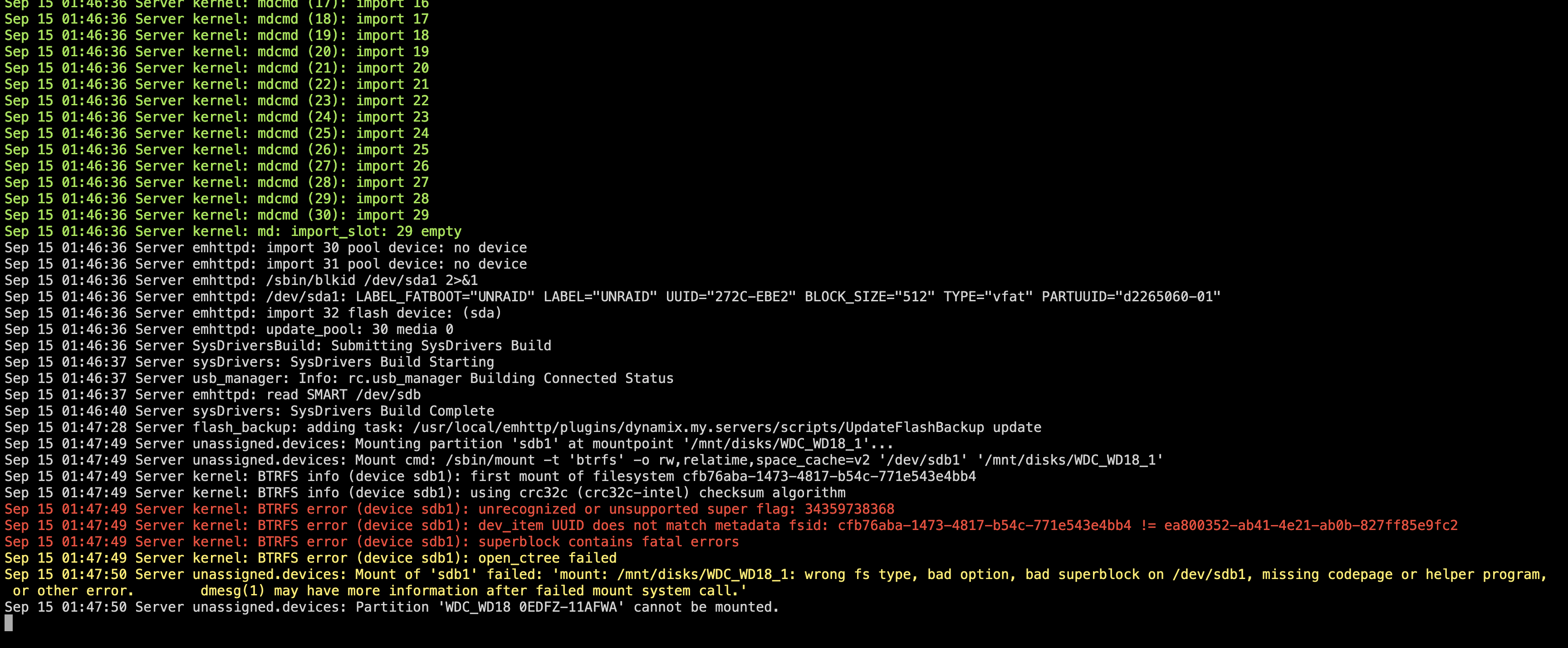

When trying to manually mount :
Sep 15 03:29:02 Server unassigned.devices: Mount of 'sdb1' failed: 'mount: /mnt/disks/3WHM5PXJ: wrong fs type, bad option, bad superblock on /dev/sdb1, missing codepage or helper program, or other error.        dmesg(1) may have more information after failed mount system call.'
Sep 15 03:29:02 Server unassigned.devices: Partition '3WHM5PXJ' cannot be mounted.
Sep 15 03:29:02 Server unassigned.devices: Mounting partition 'sdc1' at mountpoint '/mnt/disks/WDC_WD18_1'...
Sep 15 03:29:02 Server unassigned.devices: Mount cmd: /sbin/mount -t 'btrfs' -o rw,relatime,space_cache=v2 '/dev/sdc1' '/mnt/disks/WDC_WD18_1'
Sep 15 03:29:02 Server kernel: BTRFS info (device sdc1): first mount of filesystem cfb76aba-1473-4817-b54c-771e543e4bb4
Sep 15 03:29:02 Server kernel: BTRFS info (device sdc1): using crc32c (crc32c-intel) checksum algorithm
Sep 15 03:29:02 Server kernel: BTRFS error (device sdc1): unrecognized or unsupported super flag: 34359738368
Sep 15 03:29:02 Server kernel: BTRFS error (device sdc1): dev_item UUID does not match metadata fsid: cfb76aba-1473-4817-b54c-771e543e4bb4 != ea800352-ab41-4e21-ab0b-827ff85e9fc2
Sep 15 03:29:02 Server kernel: BTRFS error (device sdc1): superblock contains fatal errors
Sep 15 03:29:02 Server kernel: BTRFS error (device sdc1): open_ctree failed
Sep 15 03:29:03 Server unassigned.devices: Mount of 'sdc1' failed: 'mount: /mnt/disks/WDC_WD18_1: wrong fs type, bad option, bad superblock on /dev/sdc1, missing codepage or helper program, or other error.        dmesg(1) may have more information after failed mount system call.'

[ 7108.370657] BTRFS info (device sdc1): using crc32c (crc32c-intel) checksum algorithm
[ 7108.370660] BTRFS error (device sdc1): unrecognized or unsupported super flag: 34359738368
[ 7108.370661] BTRFS error (device sdc1): dev_item UUID does not match metadata fsid: cfb76aba-1473-4817-b54c-771e543e4bb4 != ea800352-ab41-4e21-ab0b-827ff85e9fc2
[ 7108.370663] BTRFS error (device sdc1): superblock contains fatal errors
[ 7108.370878] BTRFS error (device sdc1): open_ctree failed
server-diagnostics-20240914-2131.zip
Tried BTRFS repair :
When trying repair I get "superblock checksum matches but it has invalid members"
I'm clueless on how to fix it. Maybe it's just a matter of pointing out that the other drive is in the btrfs pool as well ?
Ubuntu sees the pair of disks as having the same UUID.
On the other hand, previous XFS disks UUID are OK.
When 4 drives are plugged, I see 4 drives.
I tried "echo 1 > /sys/block/sdb/device/delete" and "echo 1 > /sys/block/sdb/device/delete".
without any luck.
Edited by dboris
Solved by JorgeB

EDIT 1 :
I was using Unraid 7 beta 1, tried upgrading to Beta 2, without much change.
I rolled back to last stable version... and voilà :).
My drives appear separate.
Let's see if everything works.
EDIT 2 :
The drives works individually, but I still have to fix that BTRFS pool.
Sep 15 20:17:11 Server unassigned.devices: Partition '3WHM5PXJ' cannot be mounted.
Sep 15 20:18:52 Server unassigned.devices: Mounting partition 'sdd1' at mountpoint '/mnt/disks/3WHM5PXJ'...
Sep 15 20:18:52 Server unassigned.devices: Mount cmd: /sbin/mount -t 'btrfs' -o rw,relatime,space_cache=v2 '/dev/sdd1' '/mnt/disks/3WHM5PXJ'
Sep 15 20:18:52 Server kernel: BTRFS info (device sde1): first mount of filesystem cfb76aba-1473-4817-b54c-771e543e4bb4
Sep 15 20:18:52 Server kernel: BTRFS info (device sde1): using crc32c (crc32c-intel) checksum algorithm
Sep 15 20:18:52 Server kernel: BTRFS error (device sde1): unrecognized or unsupported super flag: 34359738368
Sep 15 20:18:52 Server kernel: BTRFS error (device sde1): dev_item UUID does not match metadata fsid: cfb76aba-1473-4817-b54c-771e543e4bb4 != ea800352-ab41-4e21-ab0b-827ff85e9fc2
Sep 15 20:18:52 Server kernel: BTRFS error (device sde1): superblock contains fatal errors
Sep 15 20:18:52 Server kernel: BTRFS error (device sde1): open_ctree failed
Sep 15 20:18:52 Server unassigned.devices: Mount of 'sdd1' failed: 'mount: /mnt/disks/3WHM5PXJ: wrong fs type, bad option, bad superblock on /dev/sdd1, missing codepage or helper program, or other error.        dmesg(1) may have more information after failed mount system call.'
Sep 15 20:18:52 Server unassigned.devices: Partition '3WHM5PXJ' cannot be mounted.
When trying to mount it manually :
"sudo mount -t btrfs /dev/sde /mnt/disks/WDC_WD180EDFZ-11AFWA0_3WG58XLL"
[ 1396.340256] BTRFS info (device sde1): first mount of filesystem cfb76aba-1473-4817-b54c-771e543e4bb4
[ 1396.340269] BTRFS info (device sde1): using crc32c (crc32c-intel) checksum algorithm
[ 1396.340272] BTRFS error (device sde1): unrecognized or unsupported super flag: 34359738368
[ 1396.340273] BTRFS error (device sde1): dev_item UUID does not match metadata fsid: cfb76aba-1473-4817-b54c-771e543e4bb4 != ea800352-ab41-4e21-ab0b-827ff85e9fc2
[ 1396.340274] BTRFS error (device sde1): superblock contains fatal errors
[ 1396.340290] BTRFS error (device sde1): open_ctree failed
When I tried to fix the FSID.
In anycase, the enclosure doesn't seem to be at fault. Most likely it's due to the fact that I removed the USB to SATA contrôler.
Once I manage to get this fixed, I'll make another post to tell people if the enclosure does work.
In the meanwhile, I'll try to get support to not loose the data on these drives.
Edited by dboris

I am updating this post again to point out the issue I found in Unraid 7 beta 2 (7.0.0-beta.2 2024-07-12).
I wasn't able to trouble shoot my issues with my BTRFS array failing but I found out there's clearly something that isn't working on Unraid 7.
7 beta 1 and 2 sees only one drive :
While they appear fine and separated on stable 6.12.13 :
In both scenario I see :
With 7 beta 2 and one disk out of the array using a SATA to usb adapter, then I see all my drives.
My previous unrecoverable array is displayed as "array" and is greyed out, can't be mounted :
Once I re-insert that drive in the DAS, I then see two 18TB drives. Remember, there's 4 drives being plugged.
I'm joining the three diagnostics files.
server-diagnostics-20240922-0029 (Beta 7 2 one drive removed and back in).zip
server-diagnostics-20240922-0000 (Unraid 7 beta 2).zip
server-diagnostics-20240922-0008 (Unraid 6.12.13).zip
Edited by dboris
I posted in your bug report:
Disable UAS for the USB bridge
usb_storage.quirks=XXXX:XXXX:u
You can get the correct device ID from Tools - System Devices
I figured out it should be : usb-storage.quirks=XXXX:XXXX:u and not usb_storage.quirks=XXXX:XXXX:u
It really did seem to work, but after I tried recreating an the array, I'm back at facing the same issue than before...
I really don't gasp what's going on here...
Edit : I tried adding usb-storage.quirks=XXXX:XXXX:u and usb_storage.quirks=XXXX:XXXX:u, didn't worked.
Is there a way to check if UAS is activated ?
Edited by dboris

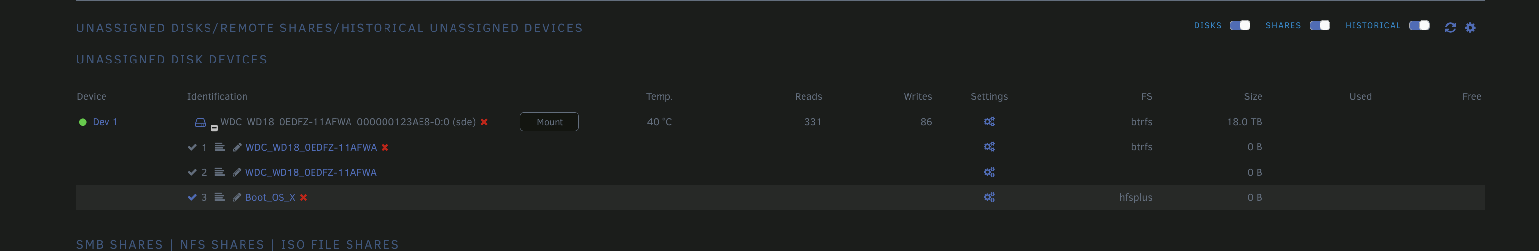

It's possible that both work, but usb_storage.quirks works for sure.
What are you using for the IDs?
Also post the diagnostics and the output from
lsusb -t
lsusb -t
I'm not sure to understand your question about the IDs.
When it actually worked I had 3 coherent disks names and one was named incoherently to the 3 others.
I wanted to change it, stopped the array, removed the pool, and then it stopped displaying 4 disks.
I tried formating the disks back on osx, then plugging it to unraid, shows one or two disks.
Tried formating the disk to zfs, stopped the array, still sees only one disk with previous partitions that should have been wiped from the zfs formating.
Weird.
server-diagnostics-20240922-1905.zip
image.thumb.png.de02946dcb3032715ccb68a4c9fd9a27.pngimage.thumb.png.5b7b6d29c0ca7c59a061f9bca3bbb0a0.png
You must use the correct USB bridge IDs for the USB quirks line, or it won't do anything, try this:
usb_storage.quirks=2109:0715:u
And it worked !
As you understood I was putting in the USB concentrator and not the bridge that was displayer per drive.
Thanks a lot !
Edited by dboris

Hi, I'm using the same orico model as your. Did you fix your problem? Where did you put your usb_storage.quirks=2109:0715:u command in?
Yes my issues are now solved.
You need to edit the boot options.
You can do it from the GUI and then reboot.
You'll need to append it to whatever boot option you currently use.
To check if your changes worked, run "ls usb -t" in the terminal and make sure it's seen as USB Storage and not UAS, like on the screenshots above.
