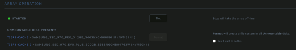

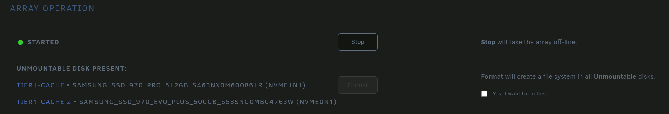

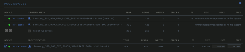

However, at least one of two cache (tier1-cache) did not come back up and gives the error: "Unmountable: Unsupported or no file system"
The backup is several months old, Nov 2023 and I am unsure if potential changes between then and now is causing the problem with the caches.
When the array is offline, I can see the two NVMEs, however the only option Unraid is currently giving me is to format. As these were front-end cache for AppData and Domains, I'd prefer not. Most of the data is backed up offline if I really need to recover.

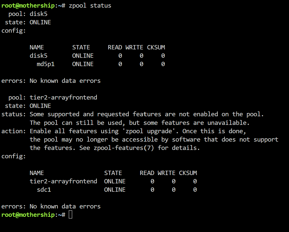

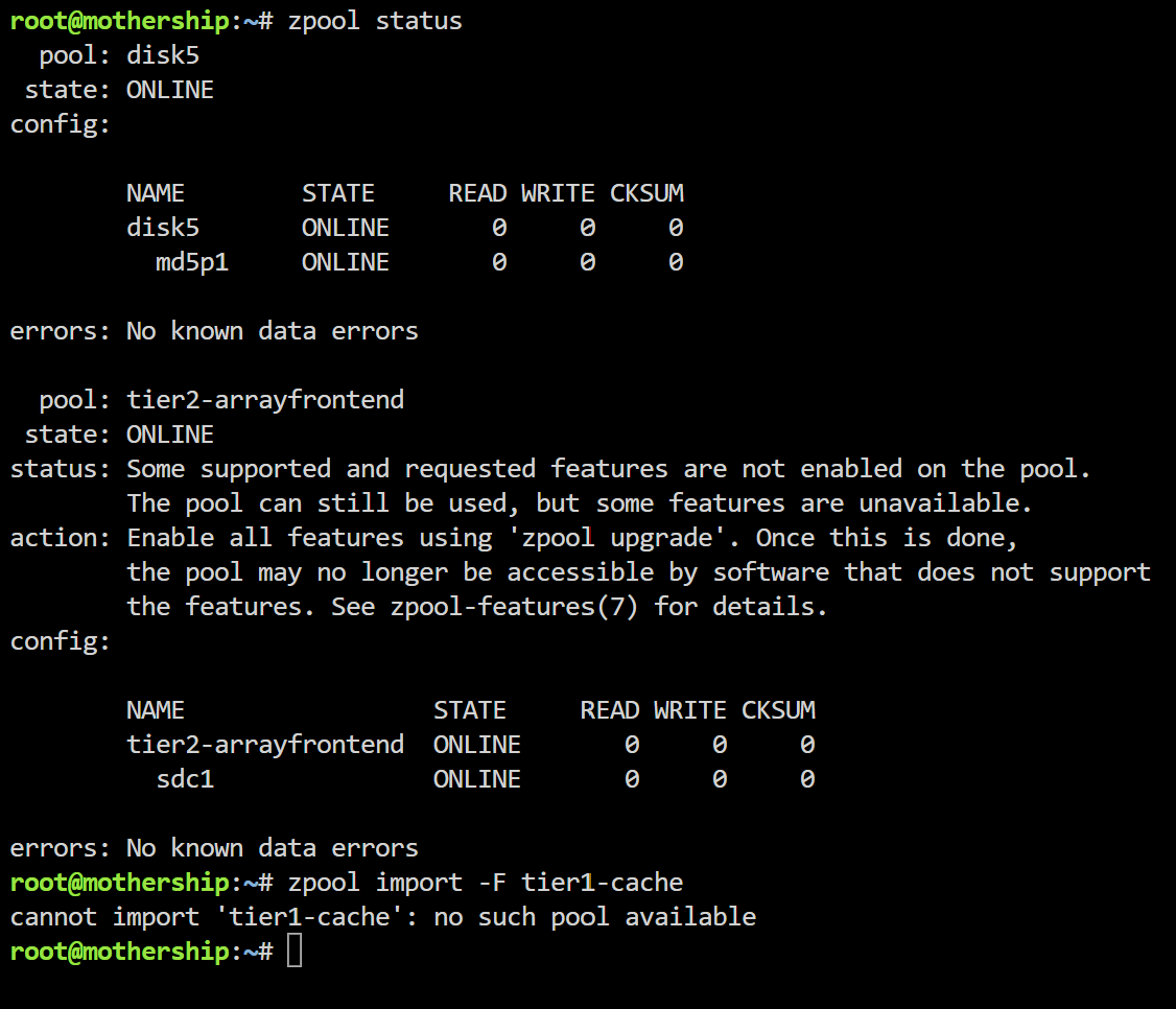

Good Morning, here is the output from "zpool import".
Looks like I have the pool name wrong. This is likely from the backup being older and missing the current configuration.
What would you suggest is the corrective?
(I will open a new thread on the UPS "graceful" auto-shutdown nuked my USB)
Try re-importing the pool and it should mount, stop the array, unassign both pool devices from the tier1 pool, start array, stop array, re-assign both devices and start array, the pool should import, if it doesn't post new diags.
Thank you @JorgeB That brought the pool back with data.
