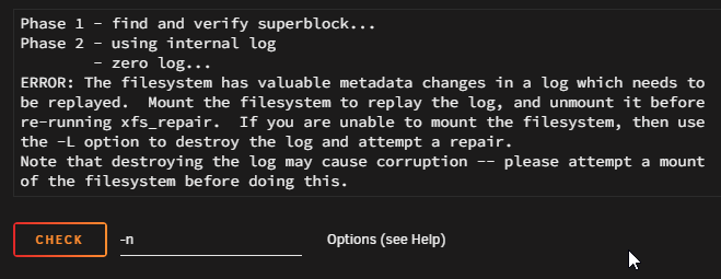

I got this:
Rerun without -n and add -L.
Looks like it's finished... Restarted array in normal mode, and the disk is back! Thank you everyone.
