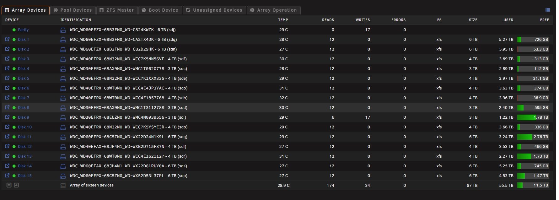

I have no idea what is spinning the disks up.  I tried disabling all plugins and dockers and something still spins them up every hour.  I spun them down and can see when file activity (windows backup) accessed disk 9 but all the others spun up with something making a few reads to the entire array shortly afterward.
I'd understand if disk 9 and Parity spun up but why did the entire damn array spin up?
Maybe because I have a MacOS machine with Time Machine pointed to disk 9 also?

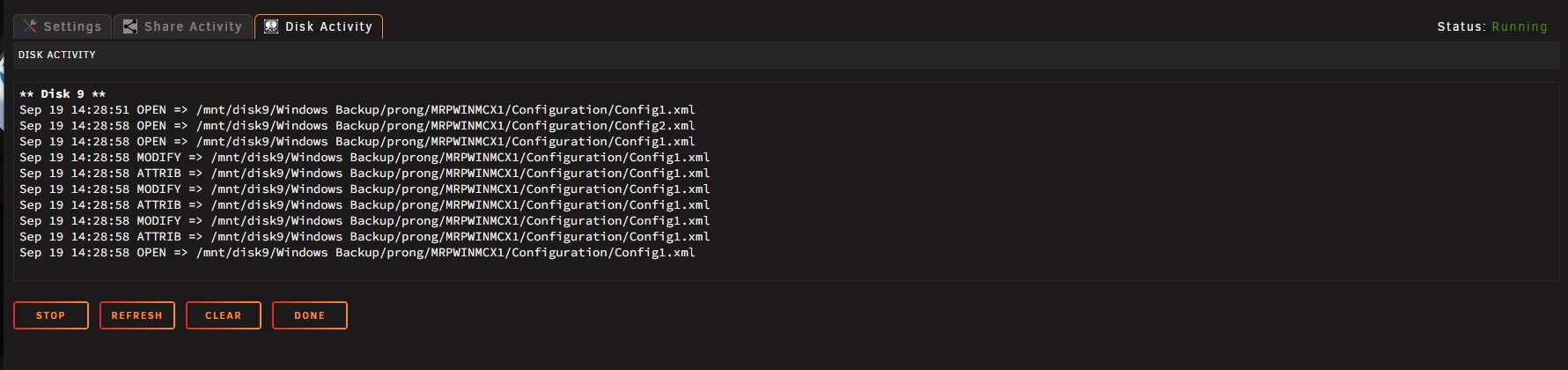

I just noticed a correlation, not sure why it's happening; hopefully someone can explain what's going on.
Windows Backup is writing to a file on disk 9 at approximately 30 minutes past, every hour.  It should be spinning Disk 9 and Parity up.  Then within seconds, the entire array spins up corresponding to Windows Backup writing to Disk 9.  Windows Backup only exists on Disk 9, by design.  The share is only on Disk 9.
Additional information: the share Windows Backup is set to not use the cache disk and write directly to the array.
From File Activity (disk):
** Disk 9 **
Sep 19 15:29:19 MODIFY => /mnt/disk9/Windows Backup/prong/MRPWINMCX1/Configuration/Config1.xml
Sep 19 15:29:19 ATTRIB => /mnt/disk9/Windows Backup/prong/MRPWINMCX1/Configuration/Config1.xml
Sep 19 15:29:19 OPEN => /mnt/disk9/Windows Backup/prong/MRPWINMCX1/Configuration/Config1.xml
Sep 19 16:29:40 OPEN => /mnt/disk9/Windows Backup/prong/MRPWINMCX1/Configuration/Config1.xml
Sep 19 16:29:40 OPEN => /mnt/disk9/Windows Backup/prong/MRPWINMCX1/Configuration/Config2.xml
Sep 19 16:29:40 MODIFY => /mnt/disk9/Windows Backup/prong/MRPWINMCX1/Configuration/Config1.xml
Sep 19 16:29:40 ATTRIB => /mnt/disk9/Windows Backup/prong/MRPWINMCX1/Configuration/Config1.xml
Sep 19 17:30:02 OPEN => /mnt/disk9/Windows Backup/prong/MRPWINMCX1/Configuration/Config1.xml
Sep 19 17:30:02 OPEN => /mnt/disk9/Windows Backup/prong/MRPWINMCX1/Configuration/Config2.xml
Sep 19 17:30:02 MODIFY => /mnt/disk9/Windows Backup/prong/MRPWINMCX1/Configuration/Config1.xml
Sep 19 17:30:02 ATTRIB => /mnt/disk9/Windows Backup/prong/MRPWINMCX1/Configuration/Config1.xml
