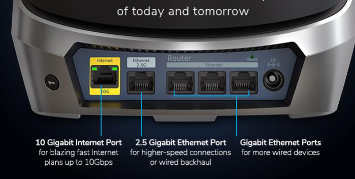

Does Orbi have router and satellite and Unraid connect to satellite ?
To simply troubleshoot, pls ensure Unraid and access client connect in same router or satellite, if they communicate in local then nothing relate to router, almost impossible fail ping each other.
If below are the outlook of Orbi 960, how you connect your equipment, if connect through 2.5g port, does it play special because it can use as wire backhaul.
I ended up reseting my router and started working again. What I don't understand is I imported my settings back and it still worked. I will keep an eye on it but it seems fine now.
