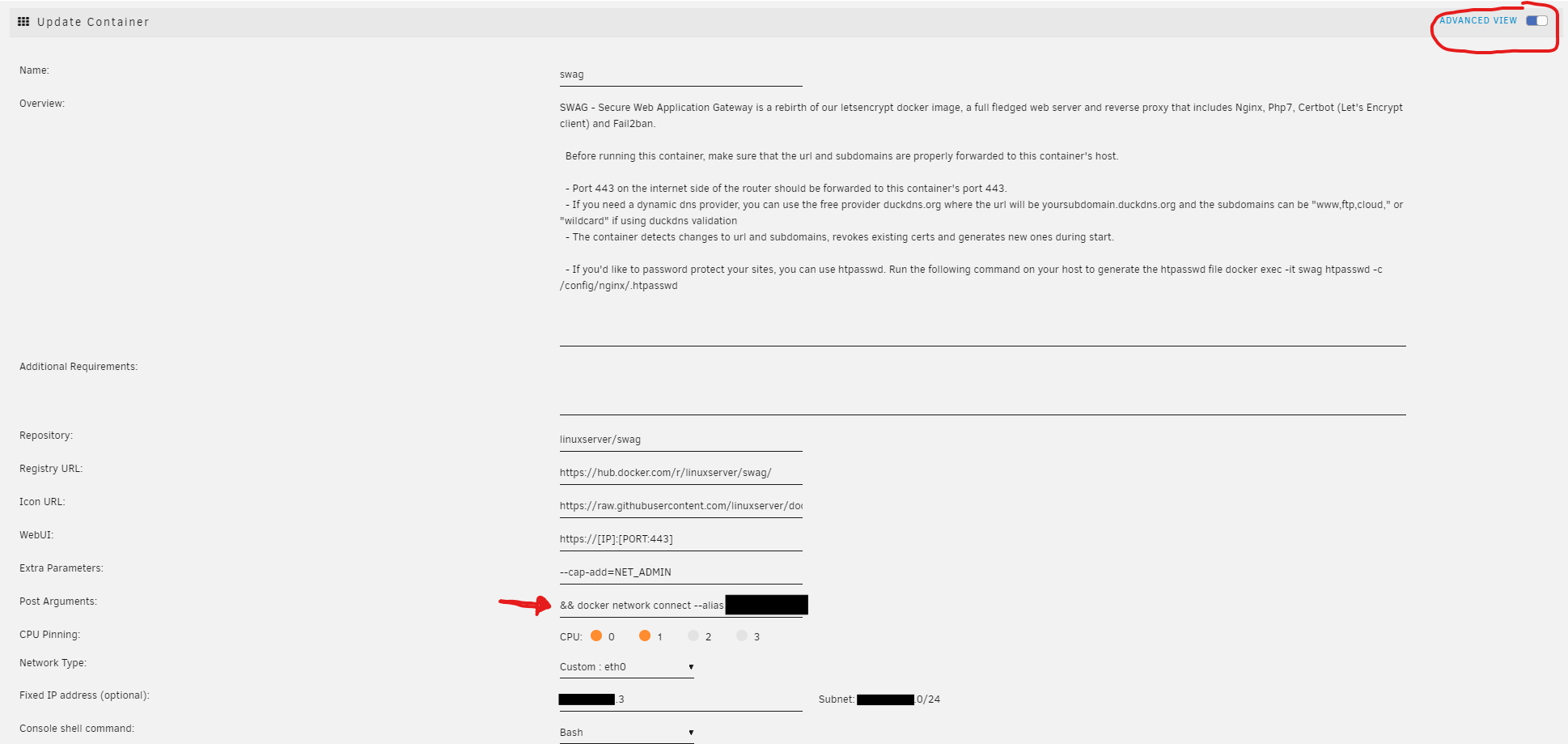

September 25, 20242 yr For better or worse, Lime Tech created their own Compose Notation to store the Run Configuration. Those are stored within /boot/config/plugins/dockerMan/templates-user. The way I would go with it (though never done it myself): Enable "Preserve Docker Networks" in the Docker Configuration in Unraid Create a new Docker Network using the CLI docker network create somedockernetwork Edit Swag and attach it to said network using the UI The network is available from the dropdown list in the UI Edit Swag and create the alias using the "Post Argument" (Advanced View) && docker network connect --alias cloud.domain.com --alias collabora.domain.com somedockernetwork swag
September 25, 20242 yr Author 23 hours ago, Bastian said: For better or worse, Lime Tech created their own Compose Notation to store the Run Configuration. Those are stored within /boot/config/plugins/dockerMan/templates-user. The way I would go with it (though never done it myself): Enable "Preserve Docker Networks" in the Docker Configuration in Unraid Create a new Docker Network using the CLI docker network create somedockernetwork Edit Swag and attach it to said network using the UI The network is available from the dropdown list in the UI Edit Swag and create the alias using the "Post Argument" (Advanced View) && docker network connect --alias cloud.domain.com --alias collabora.domain.com somedockernetwork swag but if i want to connect a docker container to the same network twice, i get an error. "The command failed." ... Error response from daemon: endpoint with name swag already exists in network proxynet So this is my solution that seems to work: i created some custom network named "eth0" a while ago for my pihole. The swag container now is connected primary to it and gets an IP in my Home-LAN. Let's say 192.168.0.3. With the above way i attached it to my "proxynet" where the 2 nextclouds, a mariaDB and the collabora lives. All seems to work! Any suggestions why this may be a bad idea? Edited September 26, 20242 yr by Knutowskie
