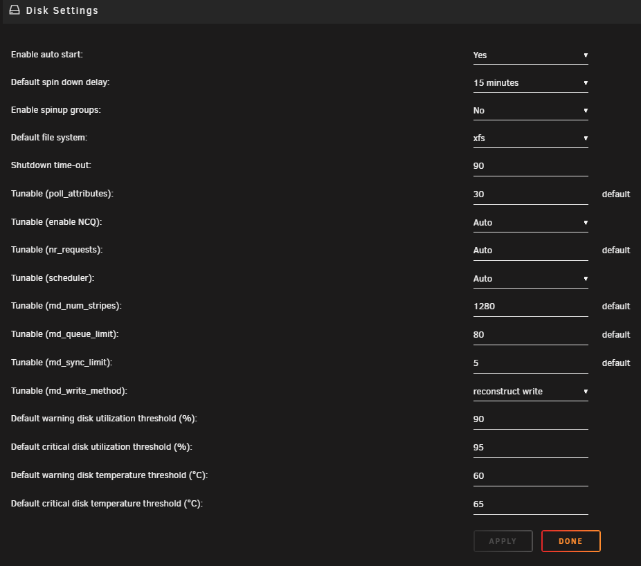

my mover wont use reconstructive write anymore. disk settings are correct and not changed.
Running unraid 6.12.13
do you have any idea what i need to do to get it back working again?
mover was running very fast with approx. 220mb/s lately until now...
already rebootet and switched disk settings to "auto" and back to "reconstructive write" - did not help

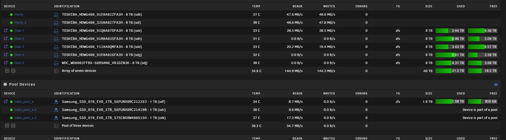

screenshot of mover running

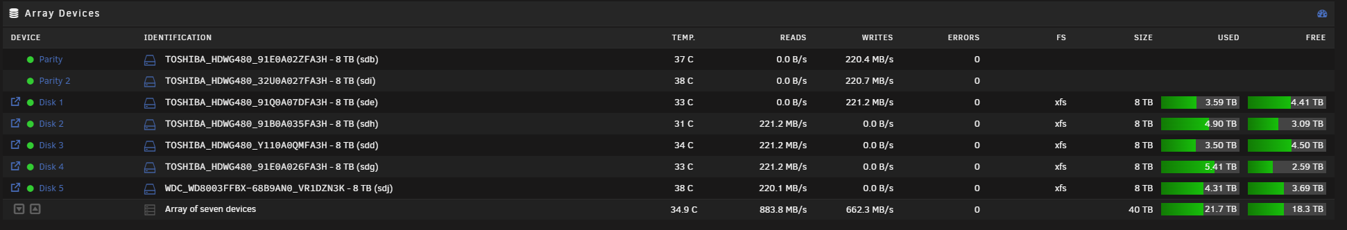

same mover job and suddenly it uses full speed
will monitor it if it switched back to "auto"
First screenshot show writes to multiples disks, turbo write is temporarily disabled when that happens, when it starts witting to a singe disk it should enable again.

no second write was happening during mover running at the time of the screenshot.
It shows writes to disks 1 and 3 at the same time, turbo write will be disabled.
yeah but only mover was running and copying large files.
It doesn't matter what is doing the writes, with writes to more than one disk
