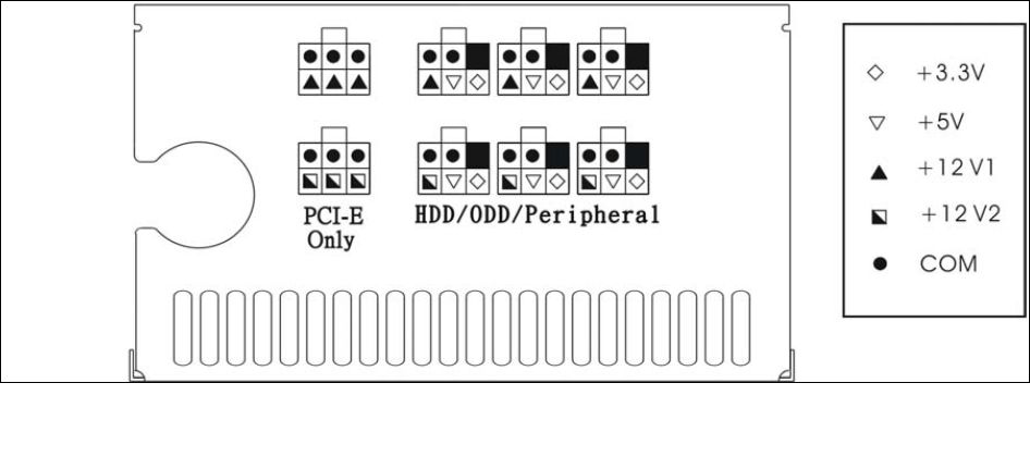

Simple question:
How many disks can be connected to this PSU? Please see attached diagram.
Total Wattage is 720 Watt. PCI-E is not used. Mainboard is a DFI LANParty LT X38-T2R. Processor is Intel E6600, 2.4 GHz, RAM = 4 GB DDR2-800 Team Elite.
24-pin and 8 pin 12V power connector for mainboard are permanently attached to PSU on a separate 12V3 rail.
12V1 and 12V2 are specified @ 28 Amps.
Perhaps as many as 8 or more if green drives. 28A / 3 less about 3 amps for the cpu.

Although I just noticed that your rails are split between Peripherals so if careful when attaching you could get 16 drives
Is that each or combined?
What's the model number of the PSU?
There's a general rule of thumb on the board that 3A per drive.
I go by the drive specs published by manufactures which are usually about 2A per drive, then leave one off for headroom
So on each 28A rail you can safely put 9 drives. I think that's a bit too much headroom.
Going by 2A per drive, you can get 14 drives. However, I would leave headroom for fans.
so I would say 10-12 drives per 28A rail, not to exceed 14.

I doubt, very much, that it's 28 amps each - 2 * 28 * 12 = 672 watts.  That doesn't leave a lot of capacity, out of 720watts, for the other rails!

I agree, it doesn't make much sense @28A, unless they do not expect all rails to be full utilized.
At 18A with 3 rails it makes sense.
My corsair 620W has 3 12V rails @18A (I have 17 drives on my system). But then the diagram shows max combined wattage for the 3 rails is 600W. When clearly 3 * 18 *12 = 648.
