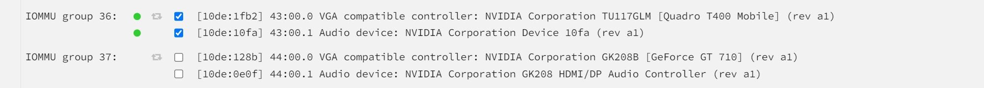

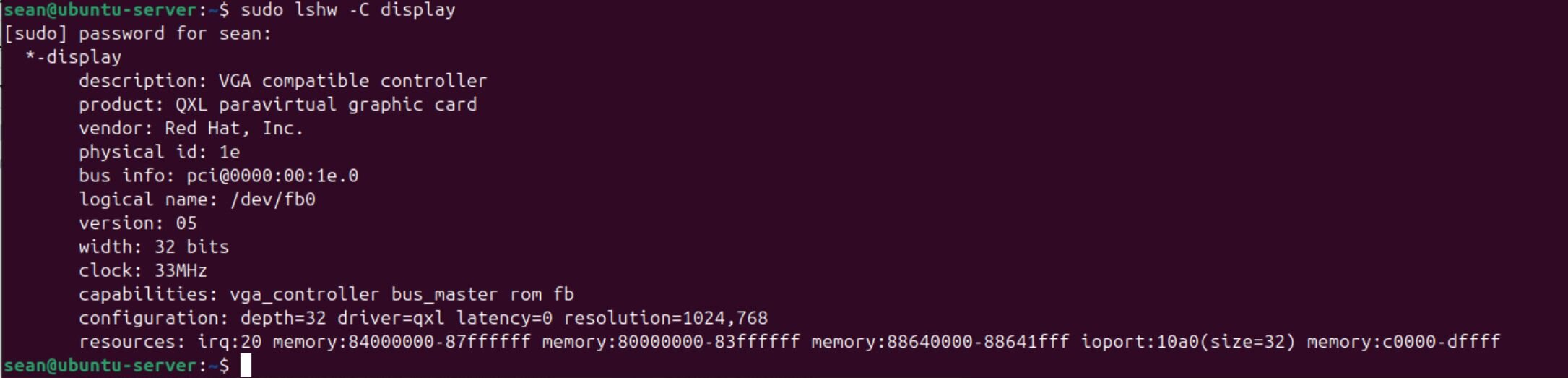

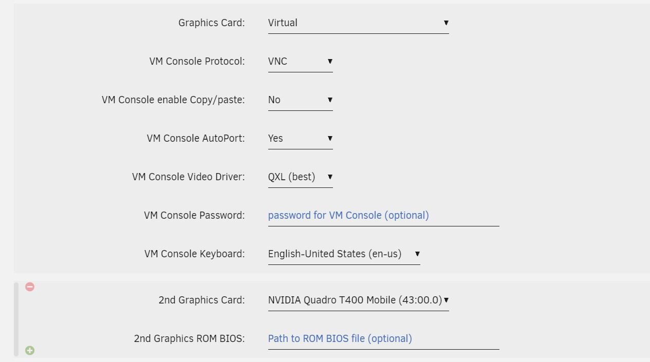

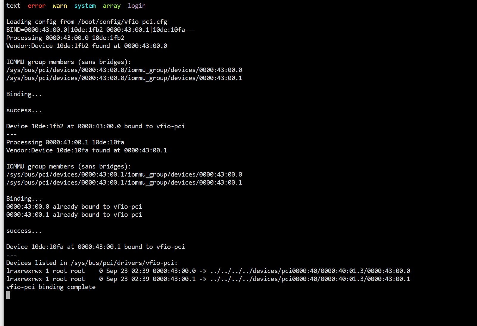

I use a Ubuntu VM as a plex server with a Nvidia T400 passed through for hardware encoding.  All the way until yesterday passthrough worked just fine.  I did the update and the VM is no longer seeing my GPU.  I went through all my setting to see if there is anything obvious but I couldn't find anything.  I am not a well versed linux user and pretty much google and copy/paste what I find.  I have found some forums that others have lost passthrough to VMs but I believe that they are running ubuntu as the main OS and not the VM like I am.

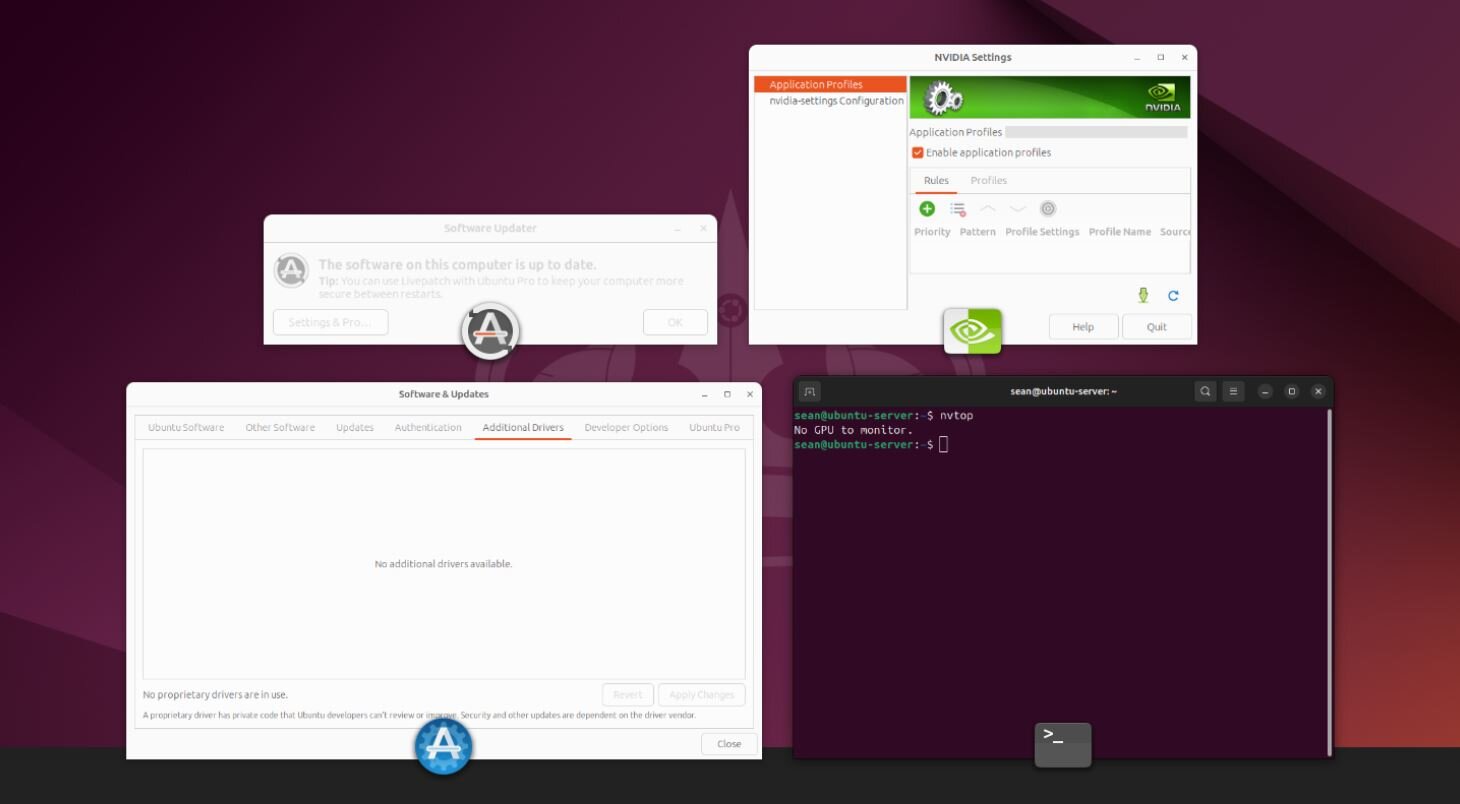

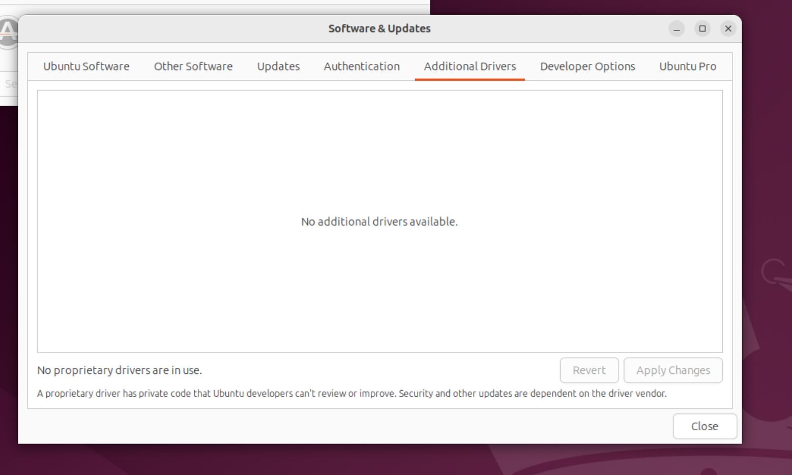

Do you need to manually load drivers? https://linuxconfig.org/how-to-install-nvidia-drivers-on-ubuntu-24-04

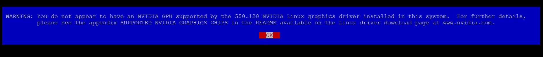

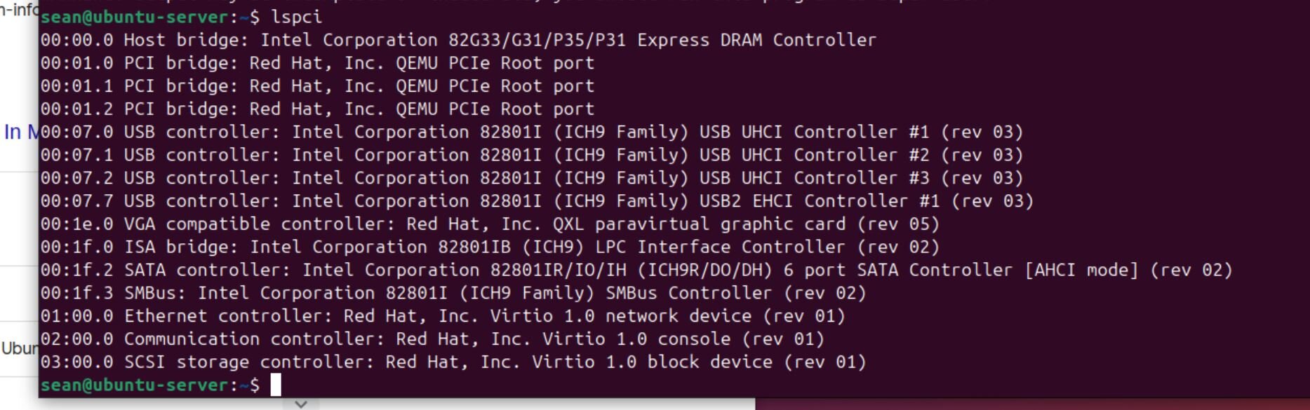

I get this error, but installed it anyways.  The rest of the install when will no errors.  Still no GPU passed through.
