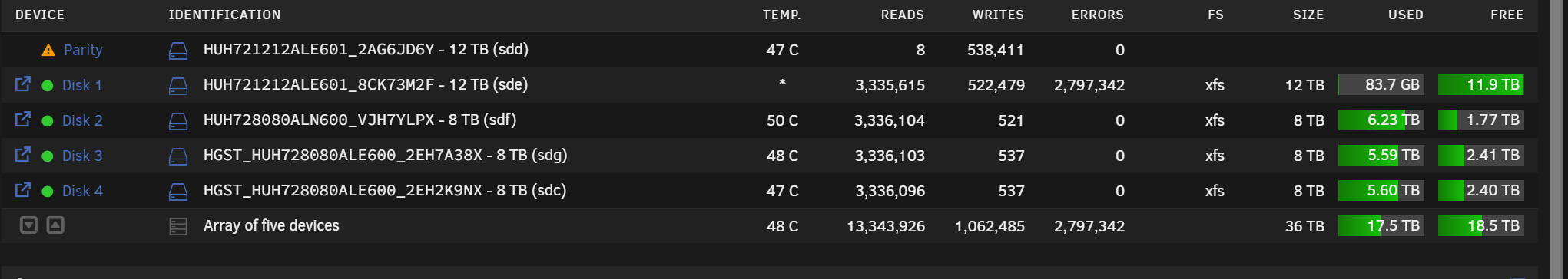

I have a server with 4 data drives and 1 parity drive. The data is a remote copy and a secondary plex server mostly. Recently after a move Disk 1 showed disabled with read errors. I ran smart test and everything was fine. I did other testing that I dont really remember and eventually erased the drive and re-added it. It was sluggish repairing so I replaced the HBA, which led to new sata cables and then new computer. (its a dell small form factor so i just swapped it with the same model). Everything rebuilds and is working great for about 2-3 weeks. Then boom disabled with read errors again. I check smart status and its totally fine, no read errors... Either way I have a cold spare that has gone through preclear (pre read, full write, post read - no errors) and I swap that in start the rebuild and go touch grass. I come back to disk 1 disabled read errors, which happened about 10 minutes after it started. At this point i am thinking that the backplane that I am plugging into is busted so i move the drives into different slots. Boom disk 1 disabled read errors (again after about 10 minutes), even though it is in a different slot now. Disk 1 and party are the newest and largest drives and are also the exact same make and model. So then I am thinking that the parity disk has an issue. So I take disk one and parity disk and run preclear (just full 0 write this time), that completes successfully. I then clear the config (array and pool) and start the array with a parity sync, and boom disk 1 is nothing but errors and about 10 minutes into that I get disk 1 disabled with read errors. I am running another preclear (pre-read, full write, pre read) which has been running for about an hour now with 0 errors on that disk 1.  I have the logs but I think i need to sanitize them, let me know what i need to do and then I can attach them.

I went ahead and rebooted immediately I checked the logs page and it was able to open but none of the errors were there. Also I couldn't open previous. So I put all of the drives into place and started the array. It reformatted disk one and started the parity sync. Immediately Disk 1 started recording thousands of errors. so i paused the parity sync and took the screenshot and tried to open system log, but again system log stuck at the Unraid loading logo. But the download button worked and here is that log. 130mb....
