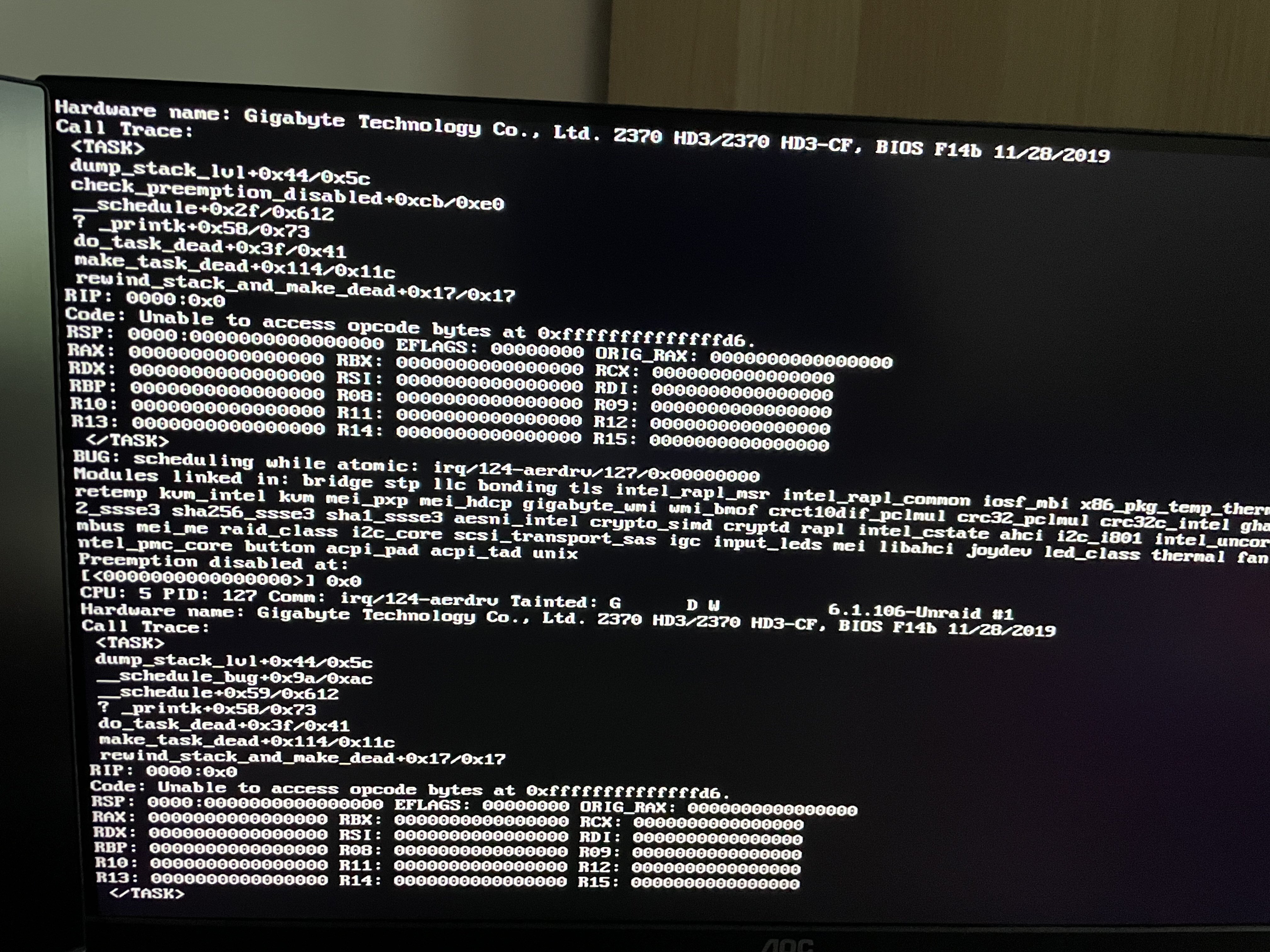

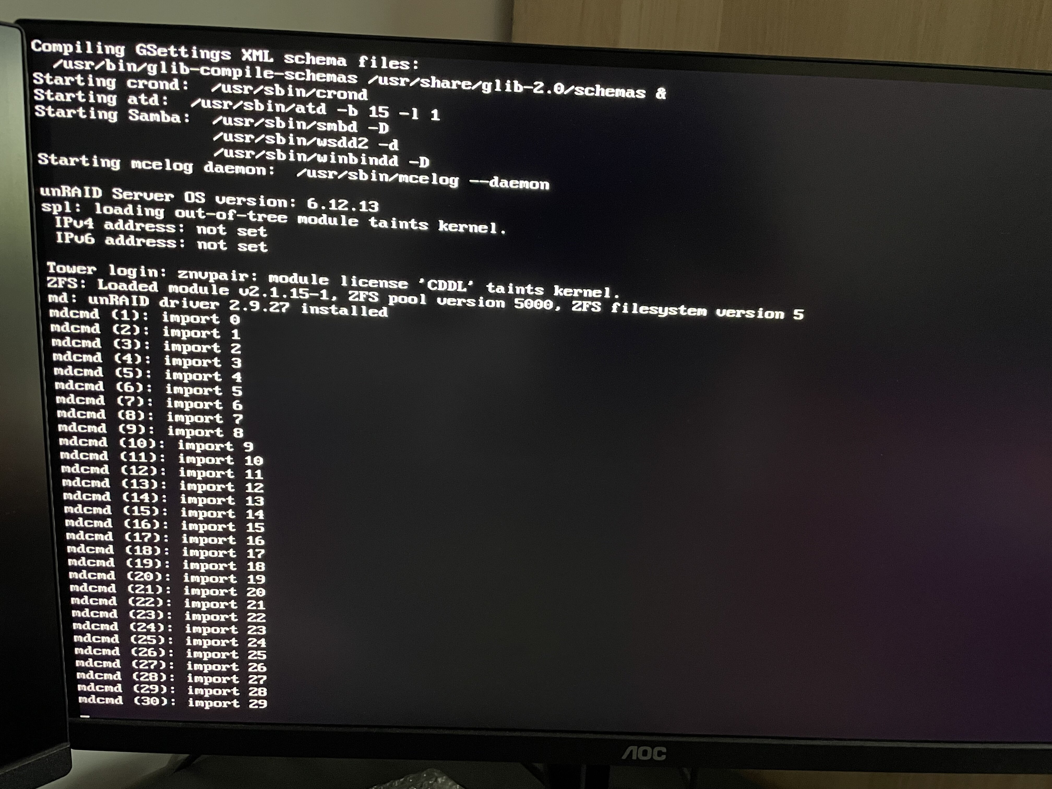

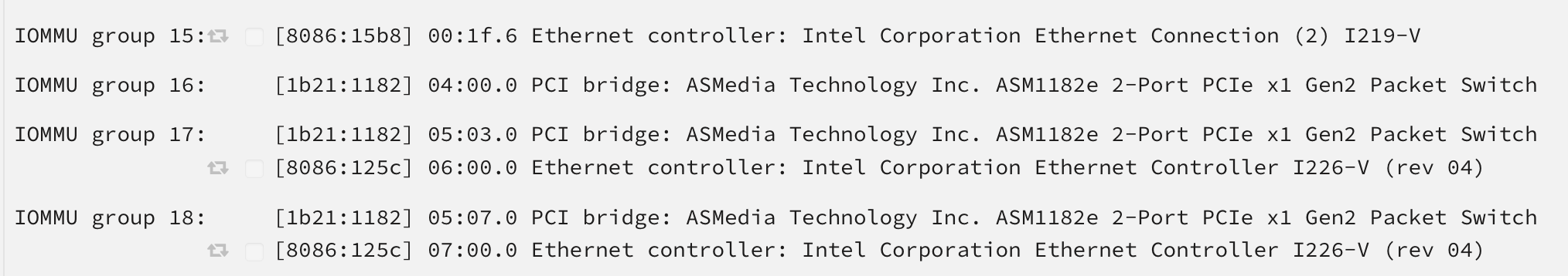

I am quite a newbie in the Unraid world and I am having issues with external x2 2.5gb NIC i226 getting to work with Unraid. When attaching ethernet cable to the new NIC there is no IP assigned and console is spamming with some wired stuff. When there is only ethernet cable connected to integrated NIC everything works as expected and IP is getting assigned and I can get in to GUI from the browser. When checking system devices in tools external NIC (i226) is showing there. Tried to delete network.cfg and few other combination like connecting ethernet cable to the both NICS, disabling integrated NIC in bios but no luck. Attaching diagnostic and couple of screenshots for reference. Thank you!

NIC driver crashed after an error:
Sep 27 08:19:49 NasManiek rc.inet1: ip link set br0 up
Sep 27 08:19:52 NasManiek kernel: igc 0000:07:00.0 eth1: NIC Link is Up 1000 Mbps Full Duplex, Flow Control: RX
Sep 27 08:19:52 NasManiek kernel: pcieport 0000:00:1b.3: AER: Uncorrected (Non-Fatal) error message received from 0000:05:07.0
Sep 27 08:19:52 NasManiek kernel: pcieport 0000:05:07.0: PCIe Bus Error: severity=Uncorrected (Non-Fatal), type=Transaction Layer, (Requester ID)
Sep 27 08:19:52 NasManiek kernel: pcieport 0000:05:07.0:   device [1b21:1182] error status/mask=00100000/00000000
Sep 27 08:19:52 NasManiek kernel: pcieport 0000:05:07.0:    [20] UnsupReq               (First)
Sep 27 08:19:52 NasManiek kernel: pcieport 0000:05:07.0: AER:   TLP Header: 34000000 07000010 00000000 0000890f
Sep 27 08:19:52 NasManiek kernel: genirq: Flags mismatch irq 148. 00000000 (eth1) vs. 00000000 (eth1)
Sep 27 08:19:52 NasManiek kernel: ------------[ cut here ]------------
Sep 27 08:19:52 NasManiek kernel: remove_proc_entry: removing non-empty directory 'irq/148', leaking at least 'eth1'

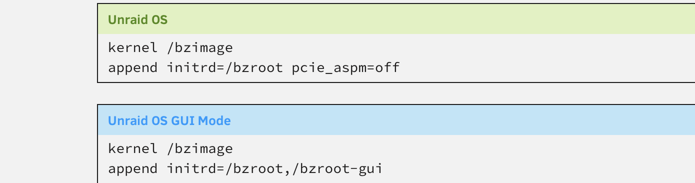

Probably won't help in this case, but still worth a try:
https://forums.unraid.net/topic/118286-nvme-drives-throwing-errors-filling-logs-instantly-how-to-resolve/?do=findComment&comment=1165009
It worked like a charm!!! thank you so much!!! just added pice_aspm=off as below and external nic working normally.
