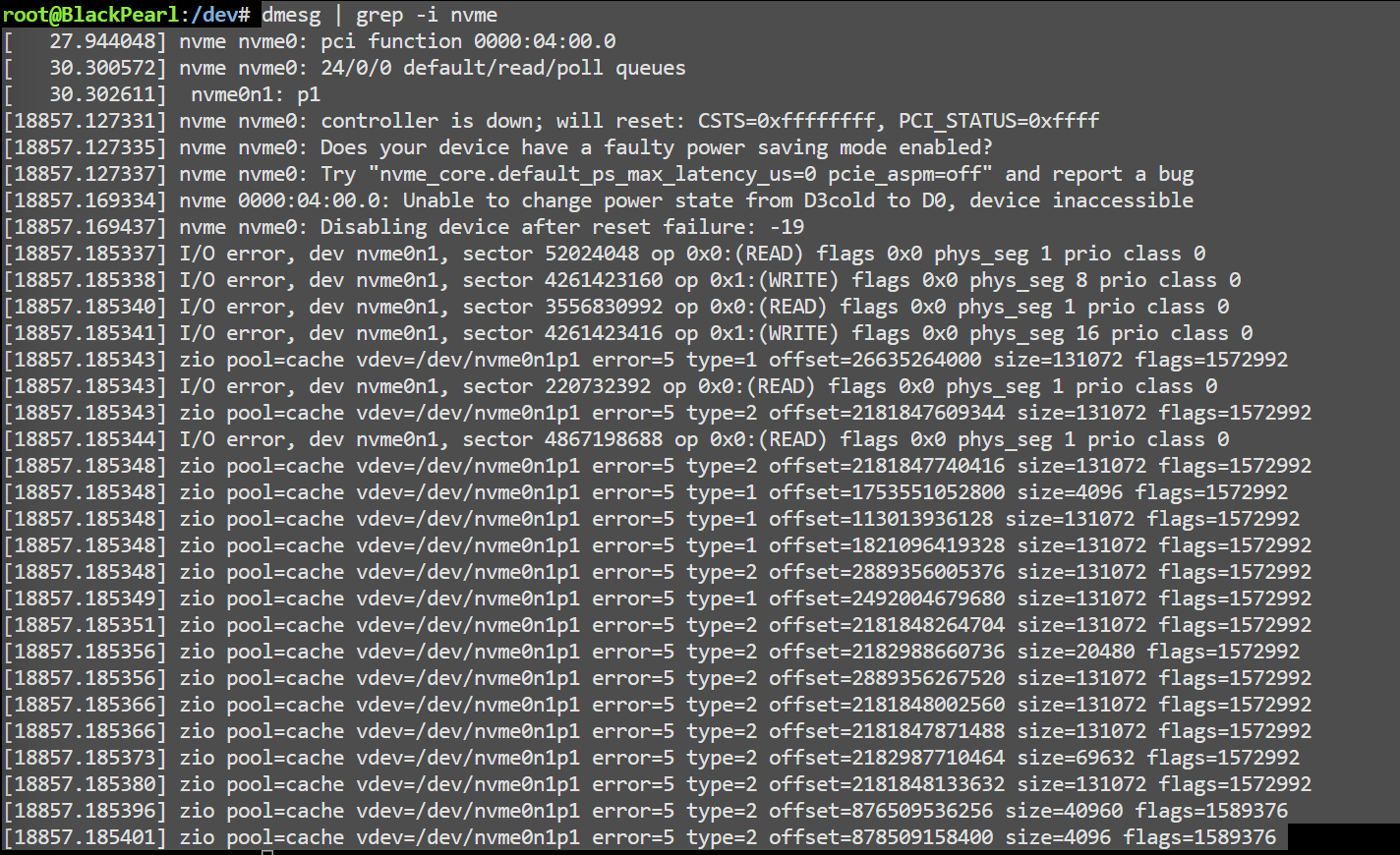

System runs fine and eventually NVME controller crashes and I lose access to almost everything except local prompts, unable to clean shutdown or restart. Image shows logs from the crash. I have appended the power control to my syslinux config and still experienced the crash about 6 hours later.

Some NVMe devices have issues with power states on Linux, try this, on the main GUI page click on the flash drive, scroll down to "Syslinux Configuration", make sure it's set to "menu view" (top right) and add this to your default boot option, after "append initrd=/bzroot"
nvme_core.default_ps_max_latency_us=0 pcie_aspm=off
e.g.:
append initrd=/bzroot nvme_core.default_ps_max_latency_us=0 pcie_aspm=off
Reboot and see if it makes a difference.
Sorry, should of been more clear but I have already done this and experienced a crash afterwards.
