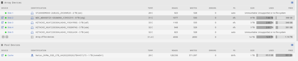

About a week ago I bought a 12tb Western Digital hard drive from ebay to add to my array. So I shutdown my server added the hard drive as my 6th drive and restarted my server. Once I logged back in to unraid I noticed it showed my 5th drive as missing. Ignoring that for the moment I attempted to do a preclear on the 12tb drive and I don’t think it was successful. I then restarted my sever a few time removing then reconnecting both drive 5 and 6. Eventually I was able to see drive 5 again but both drive 5 and 6 were showing unmountable disc. I was able to fix drive 5 with -v in check filestatus system. However drive 6 I could not get to run -v nor could I get it to format. I then shut down and removed drive 6 and attempted to plug it into my desktop. The drive did not show up in “my computer” but it did show up in “device manager” Being new to all of this I’m not sure if there is anything I can do to get the drive to work or if I should contact the ebay seller. And have any of you experienced a drive dissapearing after connecting a new drive?
Also I’m not sure if it is related but while I was dealing with the drives Qbittorrent stopped working. Adjusting some of the setting I accidentally uninstalled it. After reinstalling Qbittorrent and adjusting the “Host Path for /data” I was able to download again. It appeared to be working fine. New episodes automatically started to download but after the download finishes Sonarr no longer automatically pulls the episode. Checking on Sonarr it says it cant find the file to import it. So I checked the download folder and I cant find any of the episodes that should have been downloaded to the folder.
Solved by JorgeB
Please post the diagnostics after a format attempt of the new disk.

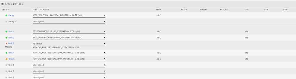

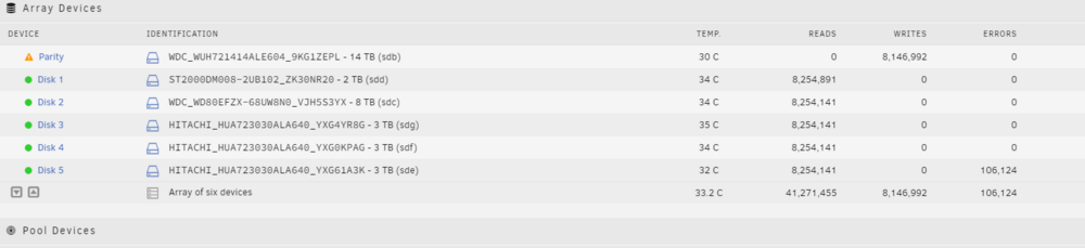

Well it seems my issues dont stop there.  After removing drive 6 from my server to check it on my desktop I did not put it back in my server. I then performed "New Config" while preserving all current assignments to remove drive 6. I wanted to get my serverback to how it was before I tried adding a new drive. I then restarted my array and found drive 1 is now showing "Unmountable".  I then restarted the array in maintenance mode and checked drive 1 and found the file system switched from XFS to Auto and the partition format is MBR while the rest of the drives are GPT. Not sure if that matters. I did switch the file system back to XFS but I'm assuming to change the partition format would require me to format the drive which would earase all the data on the drive? And -v is not working on drive 1.
Another issue now is after doing the New Config it is now running Parity Sync. I'm guessing it doesnt matter since drive 1 is Unmountable? Though the reads on drive 1 is going up. Also now drive 5 is showing alot of errors during this parity sync.
I've included the current diagnostics
postserver-diagnostics-20240929-0530.zip
No, that's normal after a new config, unless you check "parity is already valid".

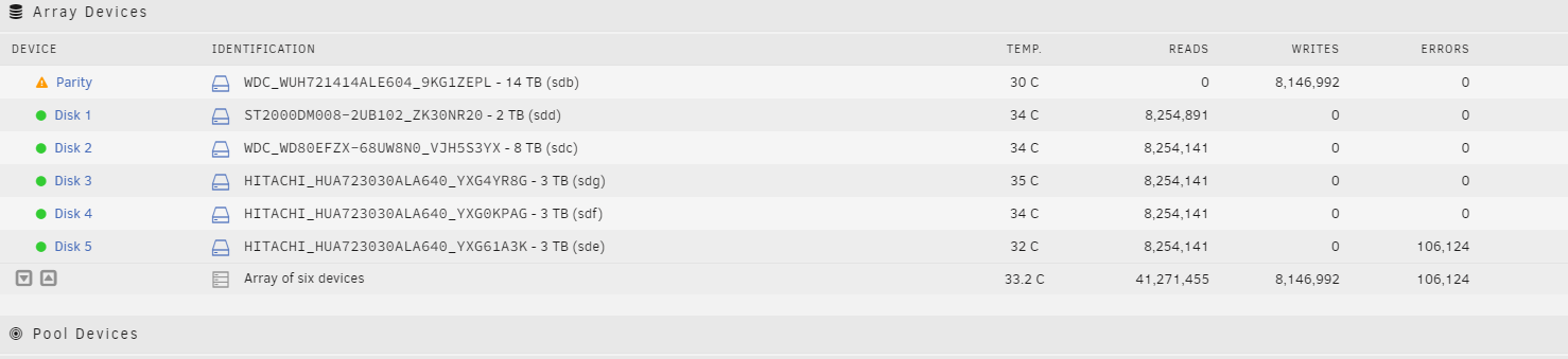

There are constant read errors with disk5, cancel the parity sync, replace cables for that disk, and post new diags after array start.

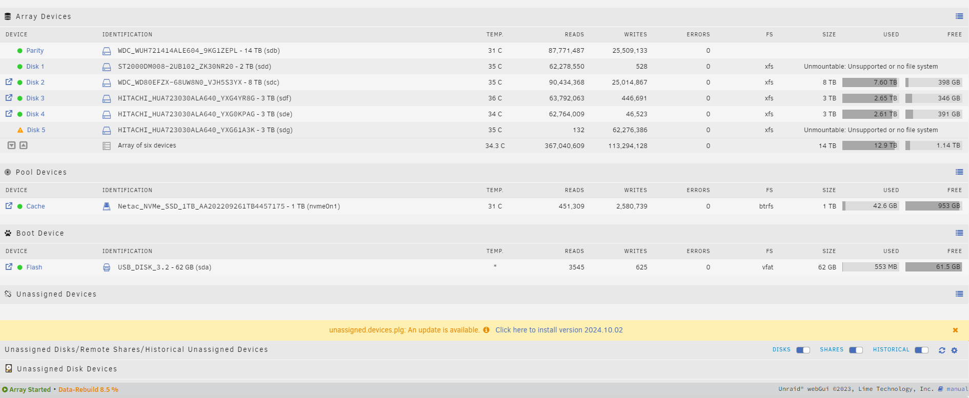

Alright I swapped the data cable and it was still getting errors. So I tried switching which port it was connected to and now it shows "Not Installed" So I treied a couple differtent ports and then went back to the original port but it is still showing "Not Installed". I then changed the power cable with no change. Drive5notinstalled.thumb.png.f8b63f3013f7718d9ec7fe913565acc9.png
postserver-diagnostics-20240930-0713.zip
See if the disk is power up, or test it in a different computer, if the disk is not detected, not much you can do, since parity wasn't yet valid.

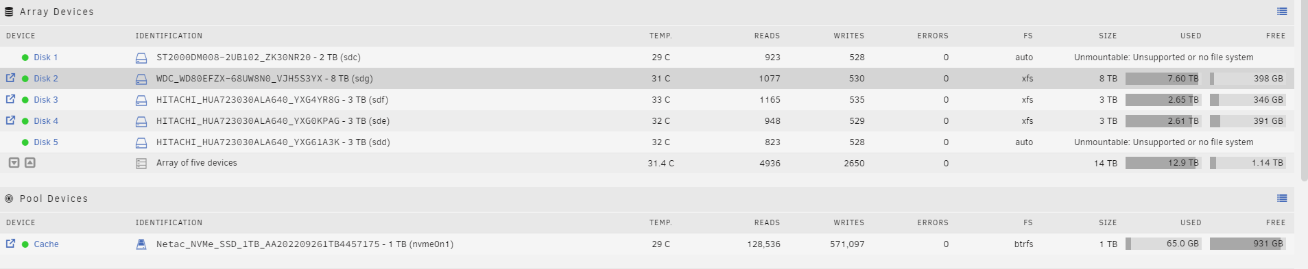

I removed drive 5 and connected it to my desktop and it looked like it was reading but it showed as a 16tb drive even though it is supposed to be a 3tb drive. I then hooked up drive 5 and drive 6 back into the server. I can see both of them when I use the drop down menu to choose which disk I want for the drive. Disk 5 is showing as emulated. And now Drive 3 is showing that the disk is missing. I’ll mess around with it and try it on the desktop when I get home.
Alright. A couple days ago I was able to get all of the drives to connect and when I started the array it started a data rebuild on drive 5. Data rebuild is slow going. Only 8.5% in 1 day 20 hrs but so far no errors. So I guess I'll let the data rebuild finish before trying to get drive 1 back and add drive 6.
postserver-diagnostics-20241003-1555.zip

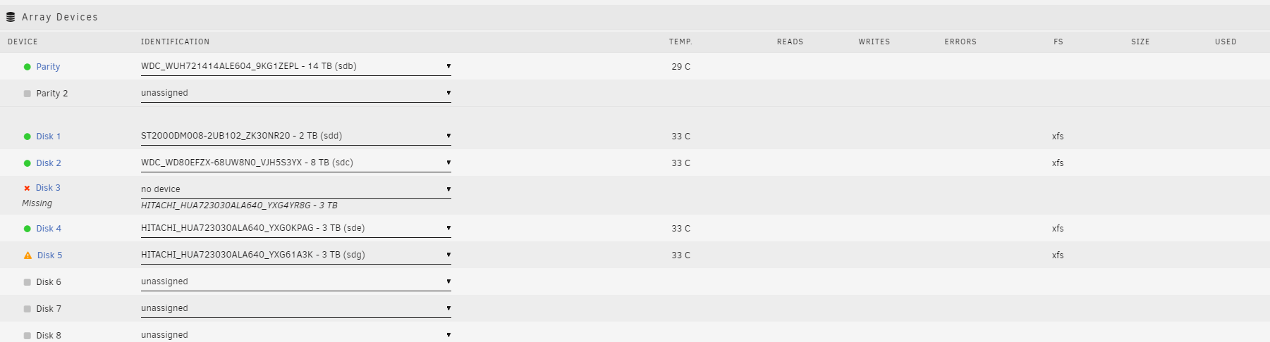

There are constant ATA errors with multiple disks, looks like a power/connection issue.
Well shit. I tried another PSU as well as another PCIE card as well as new cables for power and data. And now the parity drive is showing missing. I've been messing with which sata ports I use and have not been able to get the parity back. Since I've changed everything else I'm guessing it is probably the board. Unless you have any other ideas.
Could be the board, but it's not the most likely, do you hear the parity drive spinning up?
Parity drive is spinning up. If it is the drive is there any way to get info off of it. Drive 5 shows it is being emulated and I'd rather not lose everything from it.Parity.thumb.PNG.64b7e19abe3df3b9479b6f0474a7f33e.PNG
Swap both cables from parity with a different disk, then post new diagnostics.

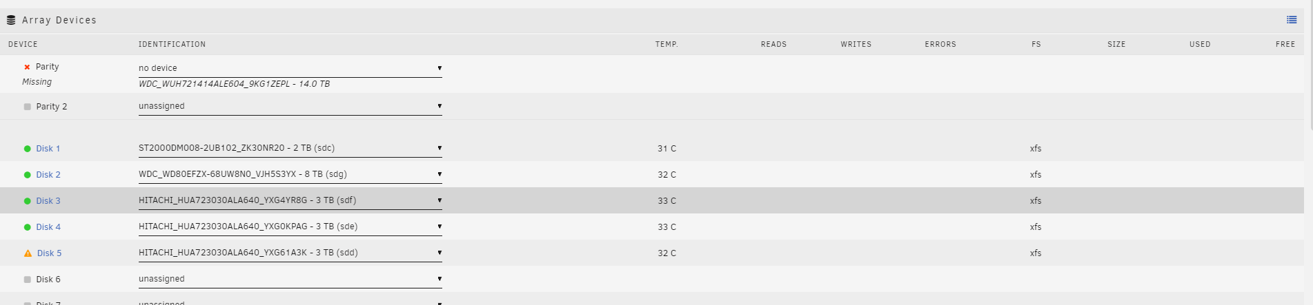

I dont know if it matters for the download but it is not letting me start the array with the parity missing. I swapped the power and data cables from drive 1 and still no change.
postserver-diagnostics-20241008-0524.zip

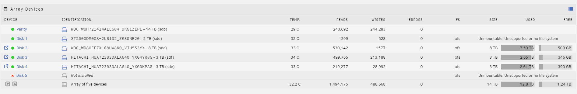

If swapping cables didn't help it looks like parity is really dead, so no option to rebuild, in that case you can do a new config to see if the actual disk still has some valid data: Tools - New config
No luck. Still not showing as an option. On the bright side I do have that 12TB drive I was originally trying to add to the array. I guess I'll use that for the Parity now. What's the best way of getting Drive 1 and 5 working hopefully losing the least amount of data possible. BTW I just want to say I appreciate all the help you've been giving me.
Did disk5 mount after a new config?
Sorry I forgot to add the diag to my last post. Both 1 and 5 are showing Unmountable.AfterConfig.thumb.PNG.30042cf6136298a40586335395501450.PNG
postserver-diagnostics-20241008-1552.zip

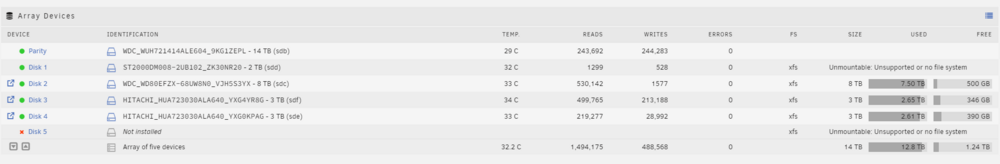

On disk 1 I get
Phase 1 - find and verify superblock...
Phase 2 - using internal log
        - zero log...
ERROR: The filesystem has valuable metadata changes in a log which needs to
be replayed.  Mount the filesystem to replay the log, and unmount it before
re-running xfs_repair.  If you are unable to mount the filesystem, then use
the -L option to destroy the log and attempt a repair.
Note that destroying the log may cause corruption -- please attempt a mount
of the filesystem before doing this.

cleared inode 6676233442
imap claims a free inode 6676233443 is in use, correcting imap and clearing inode
cleared inode 6676233443
        - process newly discovered inodes...
Phase 4 - check for duplicate blocks...
        - setting up duplicate extent list...
        - check for inodes claiming duplicate blocks...
        - agno = 0
        - agno = 1
        - agno = 2
entry "S01" in shortform directory 2644158 references free inode 2148296833
junking entry "S01" in directory inode 2644158
entry "S03" in shortform directory 2644158 references free inode 4300476805
junking entry "S03" in directory inode 2644158
entry "S04" in shortform directory 2644158 references free inode 6494313648
junking entry "S04" in directory inode 2644158
corrected i8 count in directory 2644158, was 2, now 0
corrected directory 2644158 size, was 25, now 17
entry "6d6a0a5176c6831c628042dcd5ed636317c58d3c.torrent" at block 0 offset 576 in directory inode 2148298049 references free inode 2234810073
	clearing inode number in entry at offset 576...
entry "c40c1206329a630e9ceb2b7ca2b667fc0ae0a5a3.torrent" at block 0 offset 1528 in directory inode 2148298049 references free inode 2148358084
	clearing inode number in entry at offset 1528...
entry "4ce58a9f55f23867133a09a9aac1830ee805b144.torrent" at block 0 offset 1664 in directory inode 2148298049 references free inode 2148358085
	clearing inode number in entry at offset 1664...
entry "0a4f02260482d6d77a9eb32e26c1af046605baf9.torrent" at block 0 offset 1800 in directory inode 2148298049 references free inode 2148358086
	clearing inode number in entry at offset 1800...
entry "18505bc5116dfcfcab64780e6bb95ac21a110d3a.torrent" at block 0 offset 1936 in directory inode 2148298049 references free inode 2148358087
	clearing inode number in entry at offset 1936...
entry "5df5b5c235f48158039b72291ddedcae5b3676ce.torrent" at block 0 offset 2072 in directory inode 2148298049 references free inode 2148358088
	clearing inode number in entry at offset 2072...
entry "173afbc07a4e07e4839f6d8575dc9e957e57e117.torrent" at block 0 offset 2208 in directory inode 2148298049 references free inode 2148358089
	clearing inode number in entry at offset 2208...
entry "3c6f09670f4f5e130975bc252228e85a3284e436.torrent" at block 0 offset 2344 in directory inode 2148298049 references free inode 2148358090
	clearing inode number in entry at offset 2344...
entry "112955497e3b0e6f6fb5d0cba8337804134e577e.torrent" at block 0 offset 2480 in directory inode 2148298049 references free inode 2148358091
	clearing inode number in entry at offset 2480...
entry "0330918b8ca202ad19e5b0a10d5312db1635844f.torrent" at block 0 offset 2752 in directory inode 2148298049 references free inode 2148358093
	clearing inode number in entry at offset 2752...
entry "c630cf0ba8e9461c5c6ddc0f61bd13852d726550.torrent" at block 0 offset 2952 in directory inode 2148298049 references free inode 2148358109
	clearing inode number in entry at offset 2952...
entry "4029da56c180cc31b0d007598417f5b18c0ef53d.torrent" at block 0 offset 3488 in directory inode 2148298049 references free inode 2148358099
	clearing inode number in entry at offset 3488...
        - agno = 3
entry "736710638" in shortform directory 3797983 references free inode 736710638
junking entry "736710638" in directory inode 3797983
entry "736710640" in shortform directory 3797983 references free inode 736710640
junking entry "736710640" in directory inode 3797983
entry "2148296989" in shortform directory 3797983 references free inode 2148296989
junking entry "2148296989" in directory inode 3797983
entry "4382556855" in shortform directory 3797983 references free inode 4382556855
junking entry "4382556855" in directory inode 3797983
entry "6671684566" in shortform directory 3797983 references free inode 6671684566
junking entry "6671684566" in directory inode 3797983
entry "6676233442" in shortform directory 3797983 references free inode 6676233442
junking entry "6676233442" in directory inode 3797983
corrected i8 count in directory 3797983, was 5, now 2
entry "Foster's Home For Imaginary Friends - Season 4" at block 0 offset 224 in directory inode 4300859500 references free inode 2148358102
	clearing inode number in entry at offset 224...
Phase 5 - rebuild AG headers and trees...
        - reset superblock...
Phase 6 - check inode connectivity...
        - resetting contents of realtime bitmap and summary inodes
        - traversing filesystem ...
fixing ftype mismatch (0/2) in directory/child inode 2644158/2644159
bad hash table for directory inode 2148298049 (no data entry): rebuilding
rebuilding directory inode 2148298049
bad hash table for directory inode 4300859500 (no data entry): rebuilding
rebuilding directory inode 4300859500
        - traversal finished ...
        - moving disconnected inodes to lost+found ...
disconnected inode 2161537149, moving to lost+found
disconnected inode 2161537150, moving to lost+found
disconnected inode 2161537151, moving to lost+found
disconnected inode 6651212882, moving to lost+found
Phase 7 - verify and correct link counts...
resetting inode 2644158 nlinks from 6 to 3
resetting inode 3797983 nlinks from 14 to 8
resetting inode 4300859500 nlinks from 8 to 7
Maximum metadata LSN (4:420) is ahead of log (4:380).
Format log to cycle 7.
done
Disk5 fs should be repaired, for disk1 use -L
Alright I got that done, added a parity and started the array. Everything seems to be okay. it is currently running parity check. Now I need to get another drive to expand my array.
postserver-diagnostics-20241010-0538.zip
Looks OK so far.
Awesome thank you for the help
