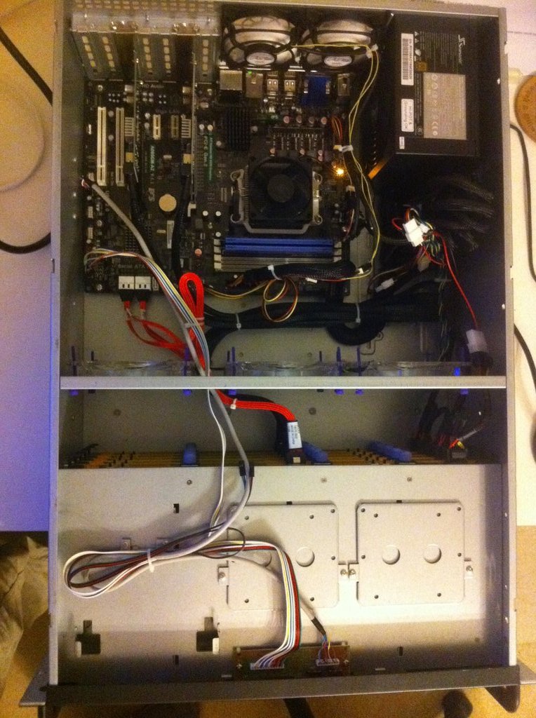

Hello all!  Long time lurker, finally getting to my first build (computer, server, or otherwise).  I'm basing my build on Raj's 20 Drive Budget Build (Rackmount) including the listed fan upgrades with the following exceptions.
A) CPU: AMD Athlon II X2 3.4GHz Dual Core
B) RAM: Kingston KHX133C9D3B1K2/8G
C) PSU: SeaSonic S12II 620 Bronze 620W
I will be starting with 5 drives.  All my computers at the house are Mac OS X.  Other components are:
Mobo: ECS A885GM-A2 (V1.1)
Case: Norco 4220
SATA Expansion Card: Supermicro AOC-SASLP-MV8 8-Port SAS/SATA Add-on Card x 2
Cables:
    NORCO C-SFF8087-4S Discrete to SFF-8087 (Reverse breakout) Cable x 1
    1m 30AWG Internal Mini SAS 36pin (SFF-8087) Male to Mini SAS 36pin (SFF-8087) Male Cable x 4
    No SATA cables needed
Fanplate: Norco 120mm fanplate
Fans:
    Nexus PWM Series D12SL-12PWM 120mm Case Fan x 3
    ARCTIC COOLING ACF8 Pro PWM 80mm Case Fan x 2
Flash: Kingston MobileLiteG2 Reader
So far I've figured most of it out from other folks threads, however I've got a few questions that I'm coming up blank on.
1) The 4220 case has a total of 12 case switch / LED's that must connect into the Mobo's "Front Panel Header", which has 9 pins.  I don't find anywhere that clarifies which to omit.  Best I can tell, the "Power SW" connects to pins 6 & 8 on the Mobo.  The "H.D.D. LED" connects to pins 1 & 3.  "Reset SW" connects to pins 5 & 7.  That leaves "NIC 1LED", "NIC2LED", "Power LED+", and "Power LED-" coming from the 4220 and pins #2 - FP PWR/SLP (MSG LED+), #4 - FP PWR/SLP (MSG LED-), and #9 (RSVD - Reserved) on the Mobo.
First, can anyone confirm if I'm approaching this correctly or if I'm totally off base?  Second, on the 4220 connectors that have 2 pins, can anyone confirm which is + & -?  The back of each 2 pin connector has one with an arrow and one without, but I don't know what the arrow denotes.
Update: Connected "Power SW" to pins 6 & 8, "H.D.D. LED" to pins 1 & 3, and "Reset SW" to pins 5 & 7.  I'm assuming I have something connected improperly here, thus the reason for the server automatically re-powering up after I shut it down from the prompt or the the Server Management Utility as outlined in posts below.
2) The 120mm bracket is in place with the new fans, but I'm confused on how to supply power to the fan's 4 pin connectors.  On the original bracket each of the 4 fans plugged into a common that fed to a 4-pin molex with only 2 pins.  How & where do I connect these new 3 ea. 120mm 4-pin fan connectors?  The Mobo has 1 ea. 3-pin SYS_FAN connection and 1 ea. 3-pin PWR_FAN connection.
Update: Connected three fans with two 4-pin Y-harnesses and a 12V 3-pin to molex adapter tied into the remaining molex plug from the PSU.
3) The 2 ea. 80mm Arctic Cooling fans are installed on the back of the case.  I understand from the installation paperwork that the connections can be piggy backed with the CPU Cooler and have that setup.  However, each fan also has a 3-pin lead and the instructions say you have the "Option" to connect these to the 3-pin AUX FAN sockets on the Mobo to read the fan speed.  The Mobo has 1 ea. 3-pin SYS_FAN connection and 1 ea. 3-pin PWR_FAN connection.  Do I plug the case fans into these two spots?
Update:[/u] I did connect the optional 3-pin to the SYS_Fan connection on the Mobo.
4) I have a lot of leads from the PSU still available after connecting 5 ea. Molex to the backplanes, the 24-Pin ATX Power and the 8-Pin ATX 12V to the Mobo.  I see in several threads that several of the remaining leads are tied off and left alone.  Just want to make sure I'm not missing something.
Update:[/u] Confirmed.
5) I see several threads where people are trying to figure out what the switches SW1 & SW2 are on the Norco's.  Anyone figured it out?  Should they all be set the same?  All mine are SW2 except for the top right drive which is SW1.
Update:[/u] Set it to SW1 to match.  Pretty certain I moved it when building the box.
6) Some folks have mentioned testing their backplanes.  How exactly do I do this?
Update:[/u] Thanks to Raj for the extensive explanation detailed below.
7) I don't fully understand the "Cache" drive option at this time.  Do I have to setup the initial build with a cache drive or can I add it later when my drive count gets 15+?
Update:[/u] Thanks to Raj for the info below.
8)Can someone confirm the 2 ea. Supermicro AOC-SASLP-MV8 should be installed in PCIEX16 & PCIE16X_S slots?
Thanks for any & all help.  I've already learned a great deal from this forum.  Never would have thought I'd be able to do this 5 years ago.

Hi thegreatgumbino, sorry it has taken me a while to respond to your thread.  If I'm following the thread correctly, you now have all of your fans connected directly to the power supply with Y splitters.  This is fine.
This is normal.
No one has figured it out yet, to my knowledge.  Norco has advised that the switches should all be left in the default position, which I thought was SW1.  It seems a bit odd that some of yours are different.  You might want to contact Norco and ask them about it.
At Greenleaf, we test backplanes several ways.  First, we run at least one pass of preclear on every backplane port.  Since you have a 20 drive build, that would mean 20 individual passed of preclear.  This can be a lot of wear and tear on a drive (we have a bank of small capacity test drives for this purpose).  Secondly, we build an array with drives spread out across the various backplanes.  Assuming you don't have 20 drives at the moment, take your current drives and spread them out so that there is at least one drive on each backplane.  First check that unRAID detects all the drives (they should show up on the drop down menus on the 'devices' page in 4.7 and the main page in 5.0 beta).  Next, assign the drives and run a parity sync.  Once that completes, run a parity check - it should complete without errors.  The third and final test will test the NIC as well as the backplanes, cables, and most of the other core components.  Create a new user share called 'test data' or whatever you like with the disk allocation method as 'most free'.  Copy at least 100 GB of data from another hardwired computer onto the new share.  Due to the 'most free' setting, the data will be spread out across all the disks, which will force it to pass through all the backplanes.  Ideally you would use TeraCopy with the 'test after copy' option enabled, but if you don't have access to a Windows machine then you can instead transfer the data with Mac's finder and then later run your own MD5 scan on the original data and the data on the server.  This will ensure that the data was transferred to each disk safely without corruption.  Finally, copy the same data from the server back into a temporary folder on the source computer.  Again, use TeraCopy or run your own MD5 checks.  If all of these tests complete, then the backplanes are trustworthy.  Granted, all of these tests take quite a while (our total burn in procedure typically takes about 2 weeks), so many people skip these tests, or only run one of them.
You can add or remove a cache drive at any time.  This thread should help you decide if a cache drive is right for you.
8) Can someone confirm the 2 ea. Supermicro AOC-SASLP-MV8 should be installed in PCIEX16 & PCIE16X_S slots?
That is correct.

Under Integrated Peripherals, set SATA Configuration to AHCI (not RAID or IDE).  This will give you the best performance.
Everytime you reboot the server, the disk assignments (SDA, SDB, etc.) may change.  This is due to different drives taking different amounts of time to initialize.  When you want to preclear a drive, the drive cannot be assigned to the unRAID array.  This is a safety mechanism built into preclear by Joe L. so that you can't accidentally preclear one of your drives that is full of data.  If you've already assigned the drives, you'll need to unassign the ones you want to preclear.
Through telnet, try this:
root (to login)
cd /boot (to change to the boot directory)
preclear_disk.sh -l (that is the lower case letter L - this will display a list of all drives that are not assigned to the unRAID array and therefore available for preclearing)
preclear_disk.sh -A /dev/sdX (where X is the drive letter of the drive you want to preclear)
Yes (to confirm the preclear)
By the way, pressing the up arrow key will bring up whatever syntax you typed in last time.  This can save you a bit of time when typing the preclear command more than once.
Only the flash drive is formatted as fat, so the error you saw was because you tried to run preclear on your flash drive.  The flash drive is always assigned to the unRAID array, even if no other disks are.

If you look at the picture I attached in my first post:
*Top right corner the 4-pin molex connectors attach to the yellow backplanes.
*Middle right in the pic you will see the red cable SAS connected to the top yellow backplane.  This is the reverse breakout cable that has a mini SAS on one end and 4 SATA on the other.  The 4 SATA connect directly to mobo SATA connectors in the bottom middle of the pic.
*The remaining 4 remaining black mini SAS cables are attached to the backplanes under the red cable & routed to the two each Supermicro SAS/SATA expansion cards in the bottom left corner of the pic (2 cables per card).

1) So the 4 SAS to SAS cables connect to the NORCO C-SFF8087-4S Discrete to SFF-8087 (Reverse breakout) Cable and that connects to the drives? Does it also power them?

That cable will allow you to connect 4 standard SATA ports (like the one on your motherboard for example) to a single 4 drive backplane. the 4240 has 5 backplanes
