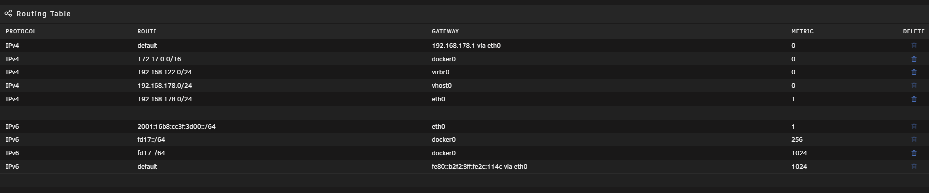

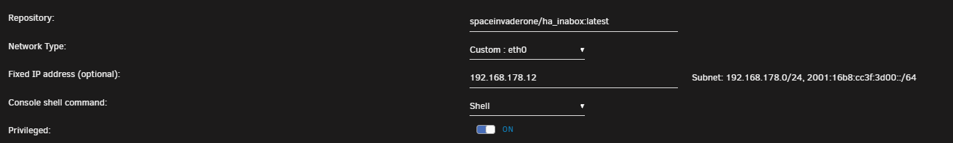

I do get an IPv4 address but I can not open the WebUI. I was thinking, if it was to the IPv4 address the VM gets: 192.168.122.154 - normally my Range ist 19.168.178.xxx . I am to much of an noob to know, if that could be the problem. Note that I have a Fritzbox and ran into the mac vlan problem when I startet with unraid some month ago.
So I looked into the settings of the VM, It shows me:
For the Docker I gave a static IP:
Also here is my unraid routing table:
I was thinking about changing in the VM the network source from virbr0 to vhost0, but I am unsure what to do with the network model.
Can anyone help me? :)

OK. I know that some of you have told me, not to change settings, if I don't know, what would happen... But I just changed the network source to vhost, and let the network modell unchaged. The VM now got an IPv4 from my fritzbox within the range I mentioned before. I can now open the WebUI of Home Assisstant. Thats great :)
Now I will have to get into Home Assisstant. For starters I have only two light bulbs from "Paulmann", one "delock" wifi socket outlet with tasmota and a zigbee/matter/tuya gateway. Hopefully I will get them to run :)
Edited by BastiKA84
Solved my problem myself.
