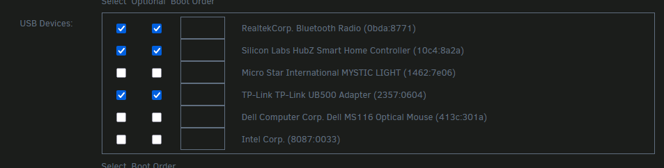

Whenever I reboot the unraid server itself, I have to reconfigure the USB devices for my home assistant VM:
After a reboot, these are all unchecked. Not an issue when only rebooting the VM.
Is there anyway to prevent this setting from being cleared?
Use USB Manager plugin instead

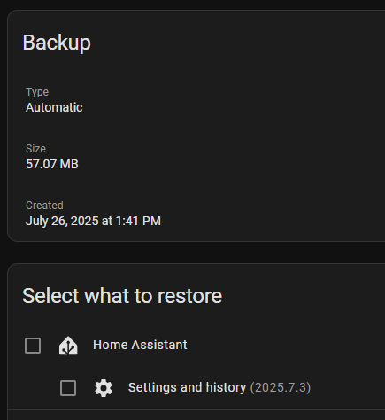

On 4/8/2025 at 9:45 PM, Espressomatic said:
In summary, HA in docker is a neutered solution that I don't recommend anyone ever use. I've long suggested they stop supporting it, honestly.
I have't notice this thread, so reading through.
I start HA in Raspberry then direct migrate to VM for 1 (or 2 yrs). But after trying docker then never return back ( since Sep 2023 ), it use much less resources and restart almost on the fly.
The main problem are you can't migrate from VM to docker, so you need start in fresh. Next is its worst backup functionality ( should overcome in current version ) ..... but backup docker appdata actually much simple then that. ( My HA appdata ~164MB )
Below are current backup functionality , I just simple trying ,but never use.
@VulpesDormiens Did you ever find a reliable solution to this?
I've tried everything I can think of to get it to automatically connect and it just won't.
If anyone else has suggestions, I'm all ears. This is the device (I don't usually check Optional, must have double clicked or whatever a moment ago):
This is my trying and failing to connect it in docker settings:
And this is the device info:
It really seems like it should work, but no, every reboot requires manually reselecting the device.
@DrPeril , unfortunately no. I've just been dealing with the annoyance and just hoping I don't have to reset the server too often. I also feel like it should just work. Perhaps we are the only two that have ran into this.
You are not the only two, I just read the thread also hoping to get this solved. Will try the USB manager plugin to see what that does.
Fwiw, the USB Manager seems to work. The VM settings page still shows my USB devices unselected, but I instructed the USB manager to attach to HA on VM start. When I reboot and start the array, the USB device is passed through correctly. Thank you @Espressomatic!
Yep, USB Manager plugin seems to be the solution.
