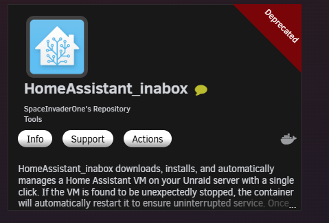

Looks like this one is now deprecated? But it only had an update yesterday?
Just so I'm clear, v3 is for the docker container. There was a release for Home Assistant today (2026.8.3). Do I just update Home Assistant through the Home Assistant UI?
