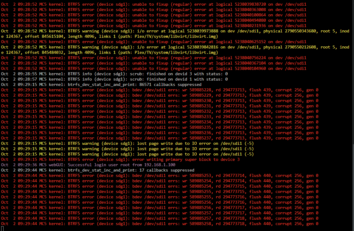

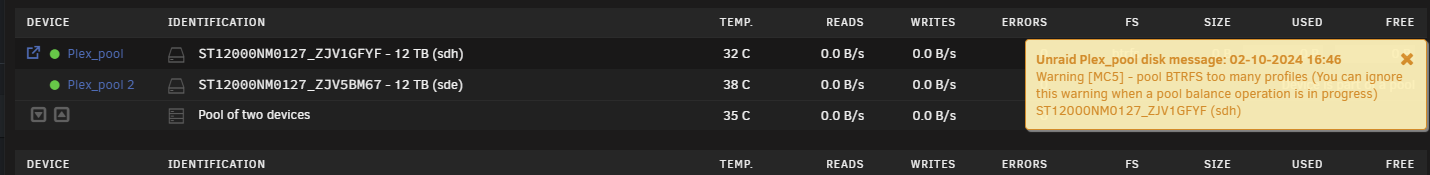

I had a problem with a storage disk, that had its data corrupted, and eventually comes to a "read only" error.
When it was in "read only" state, any try to write something led to an error 5.
It happened while doing hard read/write work (like downloading "50 ISOs of linux" simultaneously, or copying 3TB of data from a disk to another).
So I tried to remove the disk, but then the problem moved to another disk.

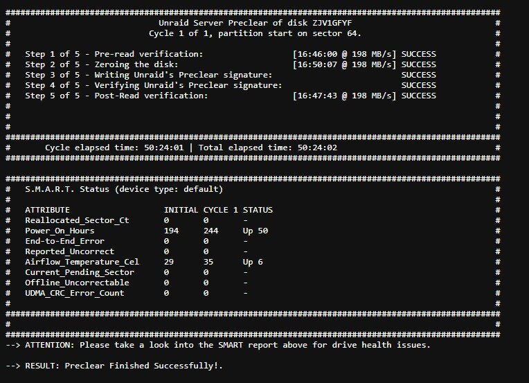

I bought like 4 others disks in total during this year, and precleared all of them to be sure: preclear read, zeroing and post-clear read all finished without any error (50h per disk).
It seems that the I/O problem "moves" from a disk to another, depending of the disks that are in the array (if I remove the 2 12TB it mooves to the SSD cache, if I add some it might moove to the NVMe, or to the 12TB, I can't find any pattern there).

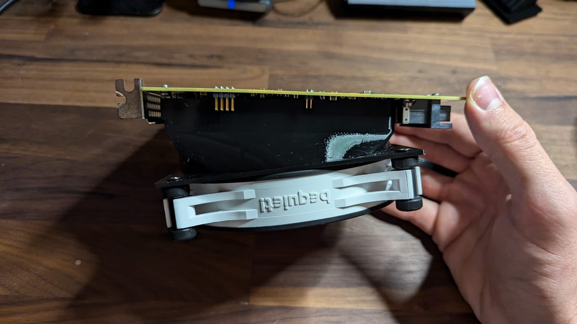

I tought the SATA of the motherboard were too saturated, so I bought an LSI 9300-16i card, and even designed a 3D cooler adapter to keep it cool, but the problem persists.

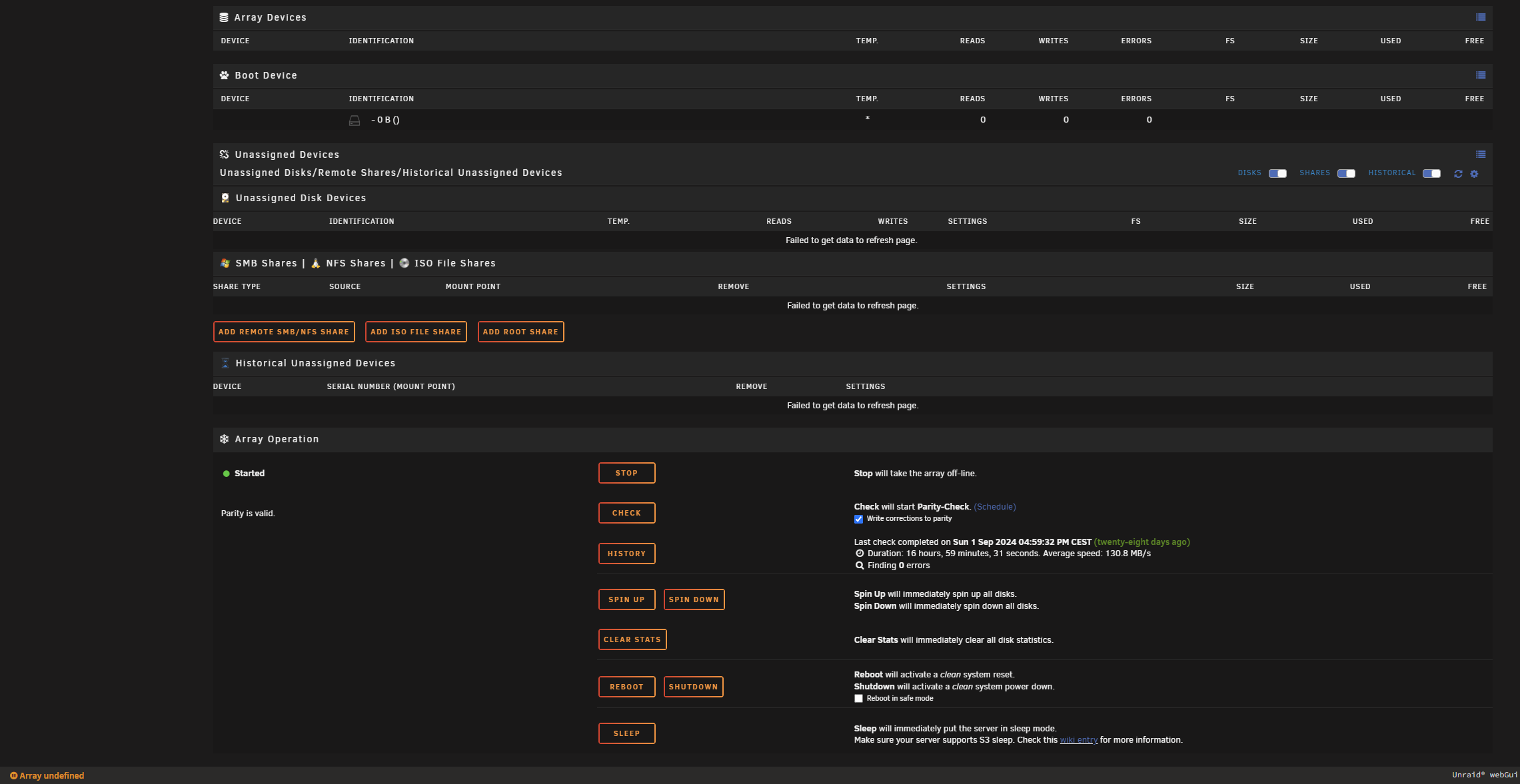

In the meantime, Fix Common Problems told me today that an "invalid folder" with the name of an old share is still within /mnt.
Some "flash device corrupted also" while starting the array, but disappearing eventually.

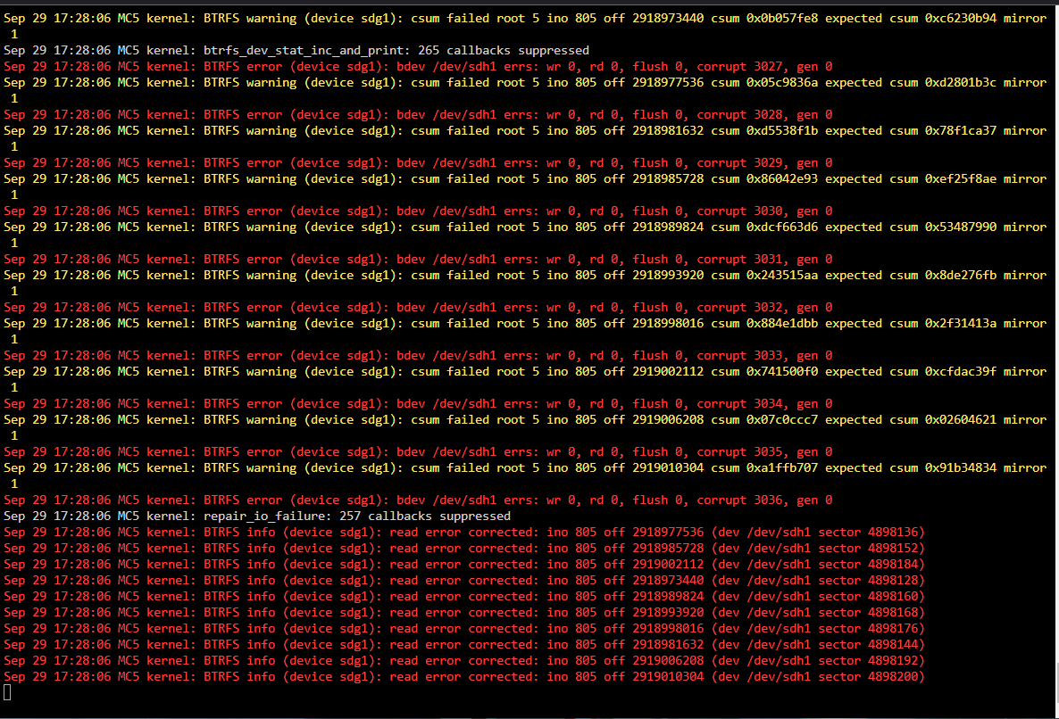

Looks like both pool devices dropped offline in the past, run a correcting scrub on the pool and post the results.
Seems to have worked!
All this time and money just for that, you saved me!

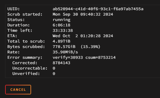

A bit of panic while doing the scrub, since I only saw "137 errors fixed" then the "main" tab alternating between empty array and Error 500, but after a forced reboot it seems that I don't have any red line for the moment, thanks Jorge ❤️

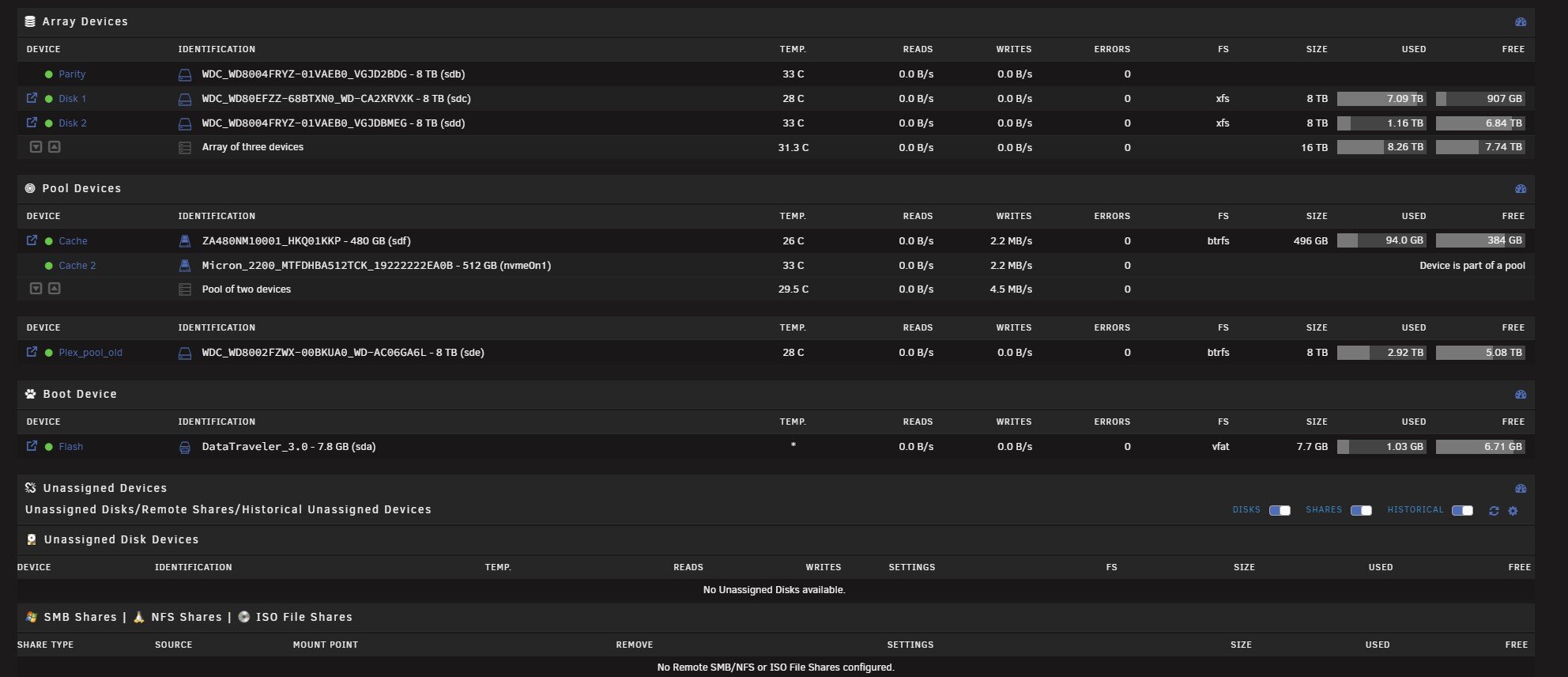

Run another correcting scrub and post the results.

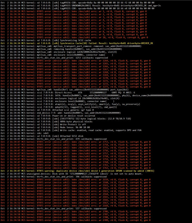

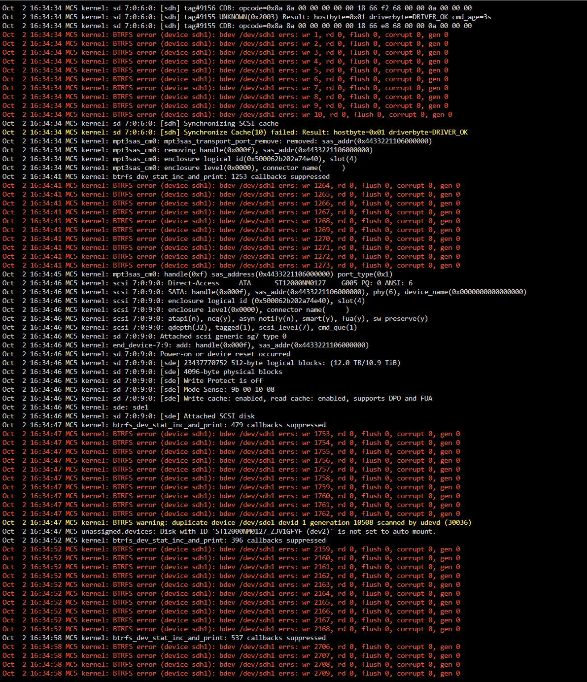

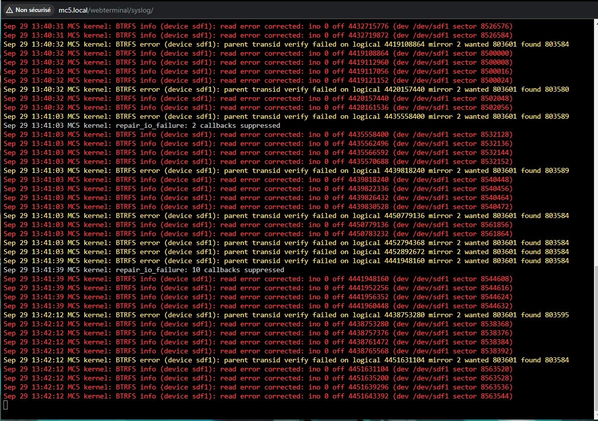

But I had a lot of lines "kernel: sd 7:0:6:0: Power-on or device reset occurred", so I went to Tools / System Devices to find out that 7:0:6:0 were attributed to one of the disks of the pool.
So I changed the disk for another that I just bought: no more "Power-on or device reset occurred", except when really powering the disks on I assume.

There are already a lot of device errors, and the syslog already rotated, so cannot see the start of the problem, and if they are new or old, but looks like a device dropped offline.
If the data can be deleted, delete all the existing data, reset the pool stats, start copying again and post new diags after new errors.

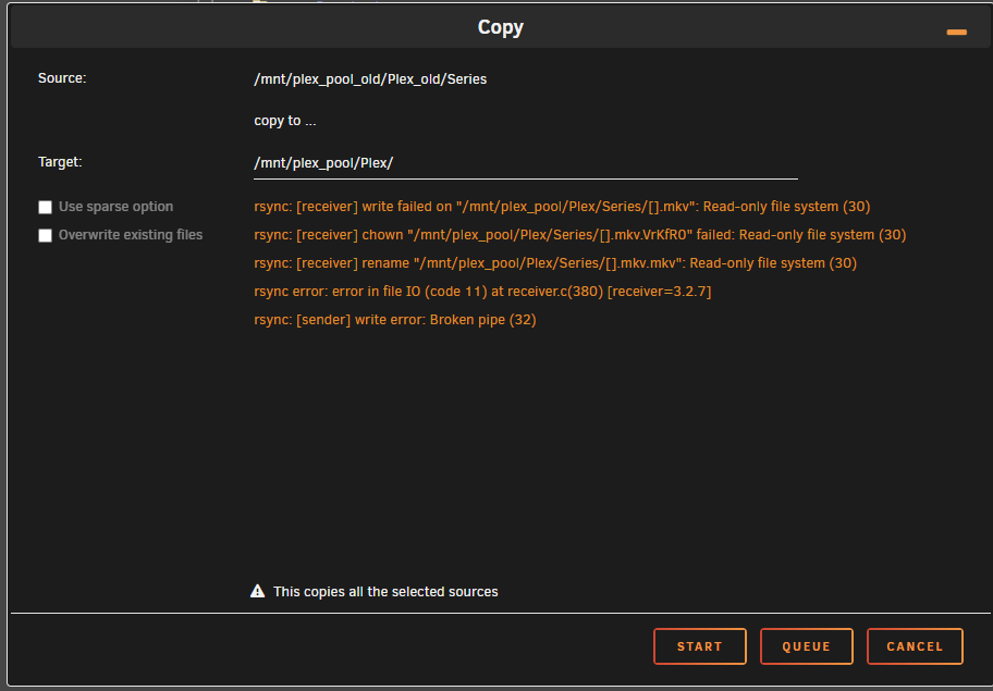

Copy crashed, pool went into read-only, and I had no access to its settings.
After a reboot, read-only was gone and I had access to the scrub, so here is the result:

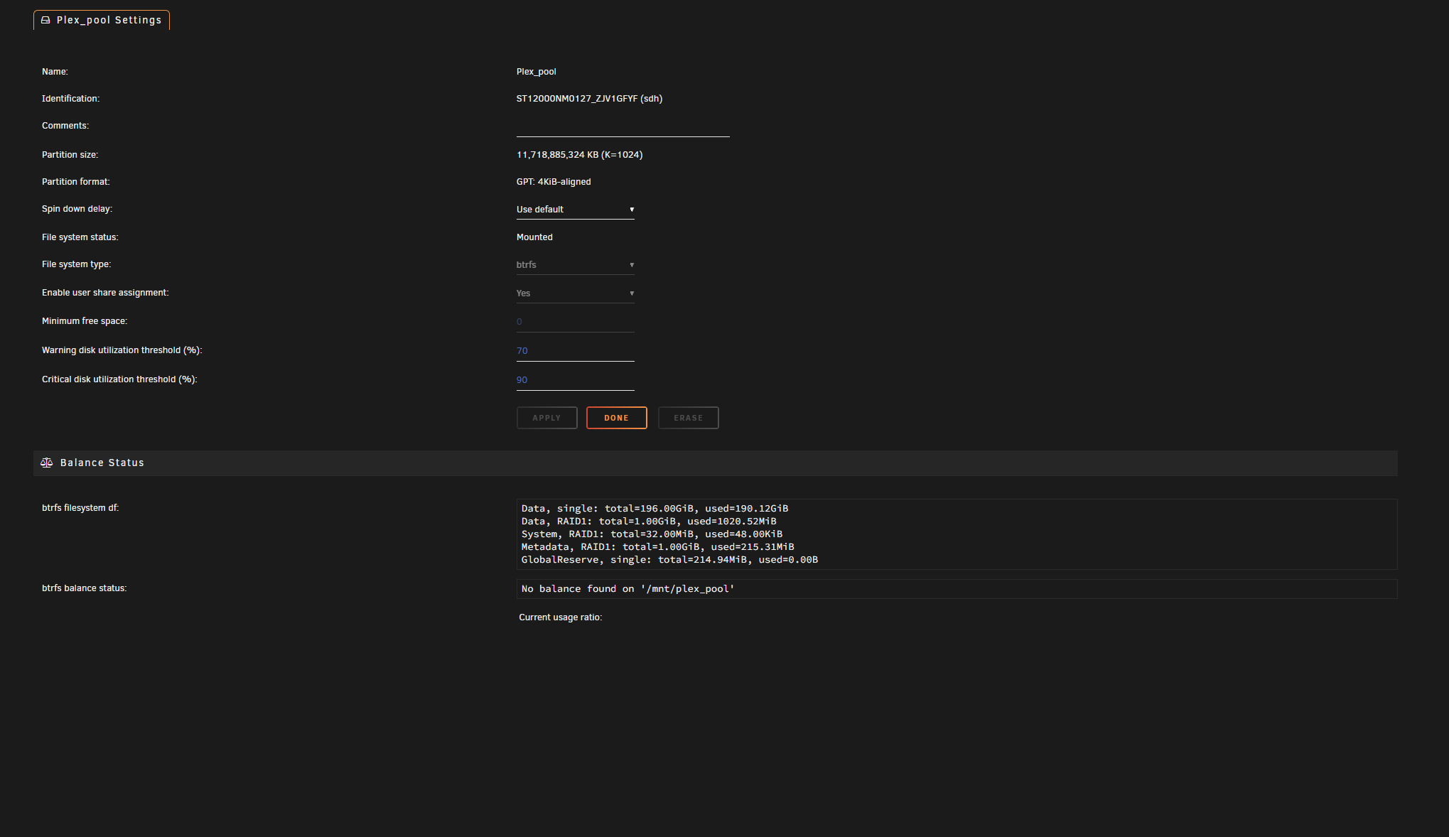

mc5-diagnostics-20241002-1754.zip

Disk is dropping offline, replace both cables and try again.
Already tried, and swapping PSU cables too, but nothing worked.
Would it be possible that, since they all come from the same batch, they might be all faulty?
If you think that it might be a possibility, I will buy some Western Digital Gold for example, and try with it!
Attached the sound of one of them:
That's not sounding good, if the cables were replaced it could be a bad disk.
