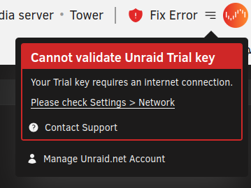

Cannot validate Unraid Trial key
doing some upgrades to my network. swapped out my old netgear router for a zimaboard running pfsense. after getting everyting installed and back up and running i got this error. i figured id just buy a key and install it but cant. new to pfsense. is there a route or firewall rule i didnt install? the server is able to get on the internet. also the tailscale isnt able to connect

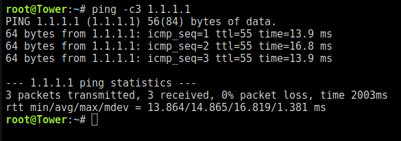

Verify internet connectivity.   Can you ping google.com?  Ip addresses either by router DHCP or manually.  (IP address, gateway, subnet, and dns IP)

I've got the exact same problem here. The DNS name resolution works, as well as pinging various public IP addresses.

Okay, this helped me to figure out the problem - somewhat. For some reason the unRAID server has issues with my AdGuard Home DNS server. I can see that the name resolutions works with IPv6 (in the AdGuard Home protocol), not with IPv4 though. That's weird, because it's the only device that has issues with it. I set the IPv4 DNS settings of my unRAID server to 1.1.1.1 and the problem was solved.
