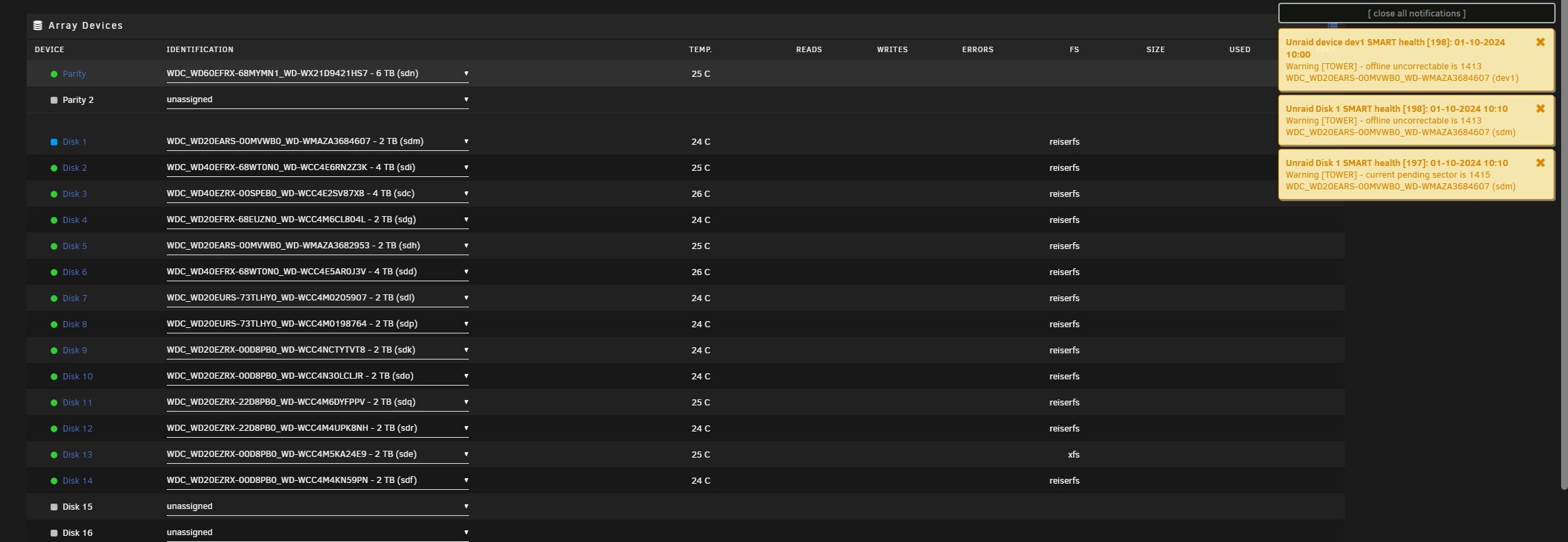

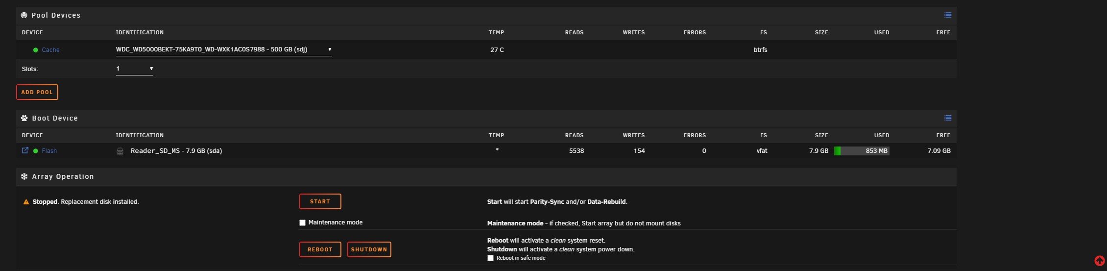

I have checked cables as best I can and they appear to be ok as in nothing very obvious, I have attached screen shots, as the disk appeared unsigned on boot up, I assigned the disk and now it shows blue New Device.............also see pending sector count on notifications.
I have not started the array awaiting your further advice

Unassign disk1 for now, and post new diags after array start.
Emulated disk1 is mounting which is good, but the disk itself appears to be failing, run an extended SMART test on that disk.
