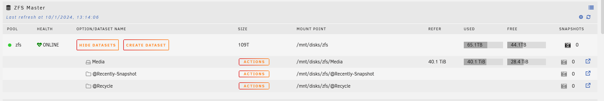

Once online again, to tried to start the copay / backup jobs, however I had to realize that the folder /zfs/Media was still there but shown as totally empty (via Windows SMB as well as via the Terminal). As the system had started a Parity Check in parallel, I thought the this issue could be linked to the check. But also once the parity check was finished after 15,5 hours (0 errors found), the folder /zfs/Media is still shown as empty. The strange thing is that in Unraid the ZFS called “zfs” is still there and shows still the used volume (65.1 TB respectively 40.1 TiB – pls. see picture below) as before. So the data seem to be still there, however I can`t see / access them anymore.

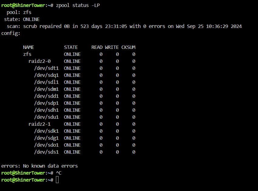

Please find the output from “zpool status -LP” below.

That pool won't work with the Unraid GUI, you will need to import and share it manually, I'm afraid I cannot help with that, maybe in the zfs master support thread.
